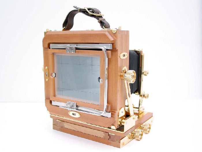

WKF20500- I would love to see some pix of your Pearwood Zone VI! Was the brass gold-plated by any chance? Does your camera have a serial number? Fred Picker talks about the Pearwood Camera in one of his '92 videos going so far as to shoot a portrait of his #1 camera-maker with a big piece of it as part of the lesson.

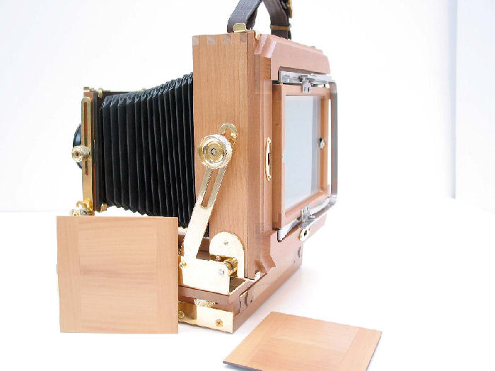

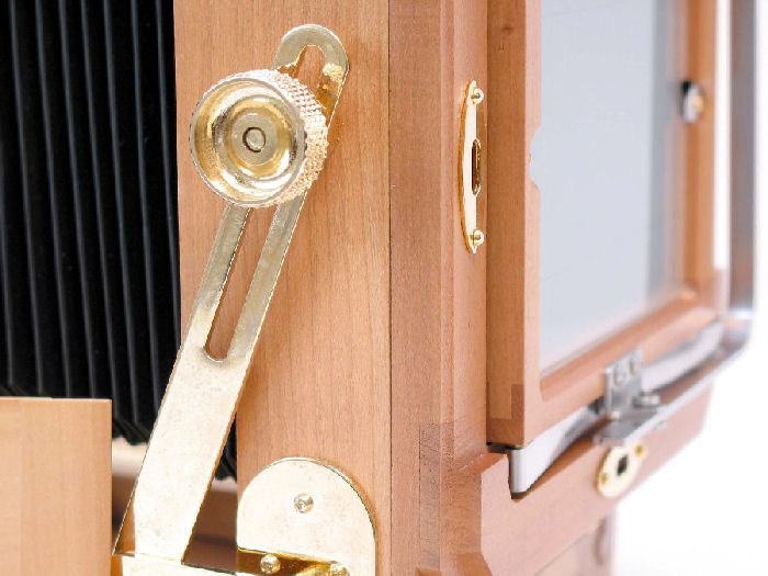

Here a a few pictures of my Zone VI. Serial number is 4337. If you have any idea of how I can check the history of the camera, or verify what wood it's made of I'd appreciate it.
Thanks,
Wes

That certainly looks like pearwood to me and it is absolutely beautiful. I also am certain that the hardware has been plated. That is not the color of raw brass, even when it is freshly machined. It has much more brilliance than non-plated brass even if it is lacquered. Man, if cameras were jewelry that one would be made by tiffany. Truly a wonderful expression of the camera makers art.

Thanks for the Pearwood pix. Beautiful camera! The chances of another 4x5 view camera being built out of pearwood with gold plated brass hardware is about a zillion to one. If you decide to sell it, I hope you give your fellow APUGers first crack at it!

A beautiful camera Wes, almost seems a shame to take it out and use it! Also many good links and information to hardwood dealers. Thanks!
