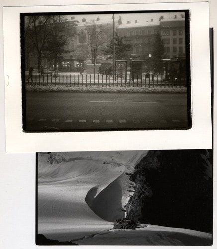

Here's a quick scan of a print from last night. The Forte paper on top of a Oriental paper (with a neutral tone), both processed in Neutol WA for 1.5-2 minutes. Striking difference, isn't it?[/IMG]

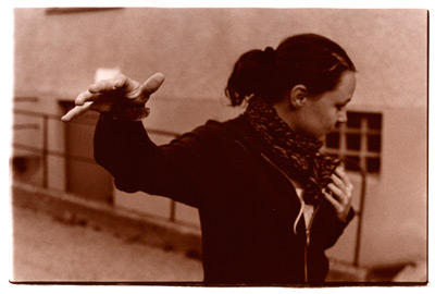

If you want the polywarmtone to be warm: give it 2 minutes in selenium 1+9. If you want pure chocolate: give it 4 minutes. That is IMO the cool thing about Forte, the papers are so easy to manipulate with toners.
Check out the attachment. That's Fortezo in selenium for 3,5 minutes. My experience with Forte Polywarmtone is that it behaves similarly to Fortezo, but slightly slower.
