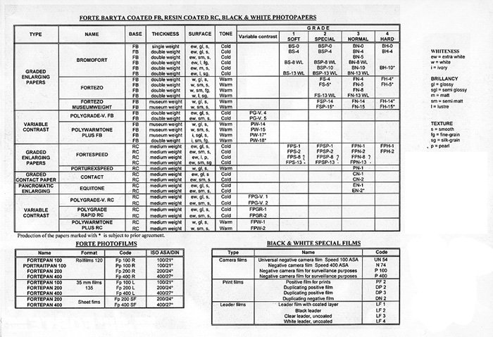

I visited the Forte factory in Vac, Hungary today. There is still in production:
Baryta:
Bromofort
Fortezo
Fortezo Museumweight
Polygrade-V.FB
Polywarmtone Plus FB
RC:
Fortespeed
Polygrade-V.RC
Polywarmtone Plus RC
I've bought also Forte paper developers:
CTD Fortespeed Cold tone
WTD Fortespeed Warm tone
Jun 7, 2005

Ole: I have the same opinion. I’ve never tried Fortezo so I can't say if there is any difference in the tonality. Definitely Museumweight feels much better according to the samples I was given in the factory.
hal9000: I was a bit embarrassed during the visit. It looked like the time was stopped there. Factory outlet (very very small shop)- more less empty, just couple of Forte films, few small boxes of paper and stuff that has nothing to do with photography.
Sales department - two older ladies speaking just Hungarian. They had just couple of boxes of Polywarmtone Plus Fb on stock (PW-14 and PW 15- bigger sizes/ 40x50cm, 50x60cm, 11"x14" and 18x24cm) which I intended to try since I had some experience only with Bromofort from the past. Bromofort B 10 was always my beloved paper!
After a while a sales manager came, she was speaking fluent English. She informed me they produce to order and deliver to more than 50 countries all over the world. Since the importer in my country-Slovakia didn't work properly, she offered me an option to order directly from the factory provided I agree with couple of my friends and we make decent order.
Old ladies spoke something about lack of raw materials, maybe something about emulsion. My friend, who was with me as interpreter didn’t understand the “special photographic” Hungarian expressions. But the sales manager reassured me that everything is fine with Forte and they should produce papers (production to order), films and chemicals in future. She just informed me that there might be “longer” delivery time for some grade 4 papers.
As I wrote I have ordered their developers and Forte 400 films to make some tests.
Sorry, I didn’t do any factory tour because I came quite late to the factory because of the snow storm in Slovakia and Hungary that day.
Dead Link Removed
Take a look on the attached table of available Forte papers which I received in the factory. There is problem with delivery of the products that are marked with question mark.
