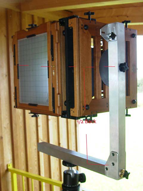

Dear all thanks so much for sharing...
in the attachment is the pic which i received from Lotus.
I so how think Lotus's VMD will be more steady than tilt the tripod head 90 degree.
thanks
Jeff

Vaughn, a lotus VMD is a large 'L' shaped extension, gimbal head sort of attachment that centers the camera over the tripod when mounting.
I thought about using a bearing plate of some sort under the head, but thought it might take to much effort to crank down the bolt to keep it from turning. What type of plastic are you using?
I can see where the VMD can work -- especially with your "smaller" camera. I wonder if it is big enough for an 12x20? or even sturdy enough for its weight?
