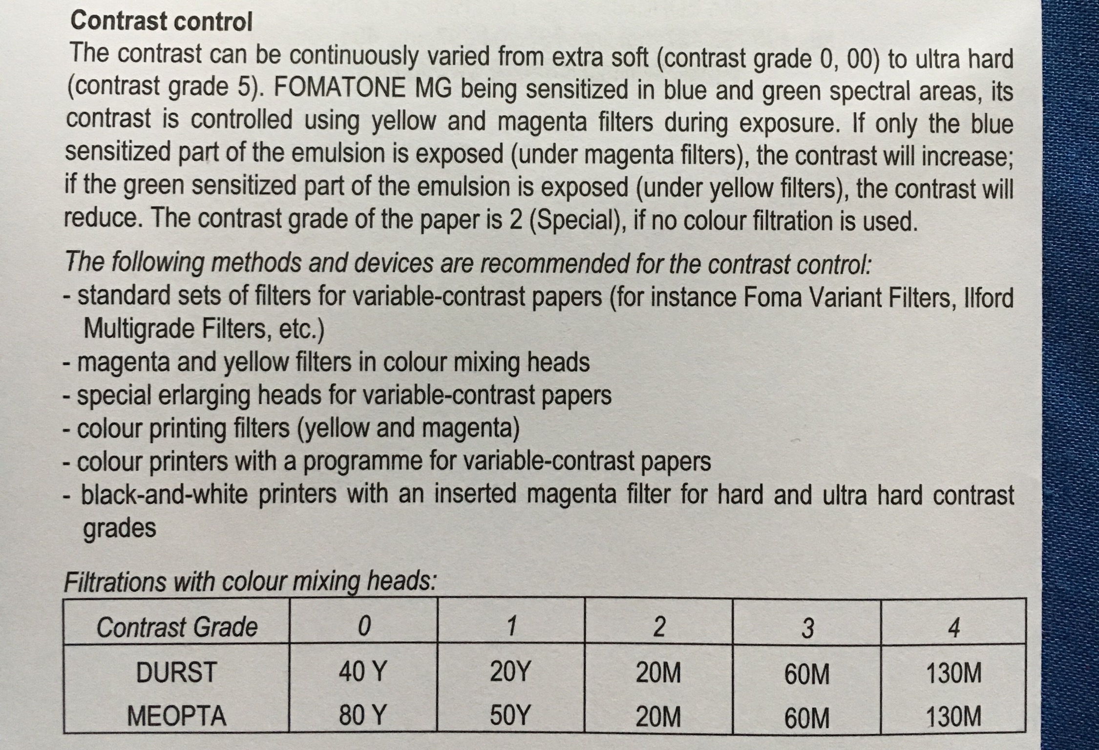

Hi everyone,
I’d like to get into lith printing and got Fomatone MG 132 paper for this process.
As it’s a grade two paper I first tried it without any filtration control with a LPL C6700 dichroic enlarger. It was only okayish so I wanted to change the grade. The paper’s instruction only gives details for Durst and Meopta enlargers and as this paper blue and green sensitized I only have to use magenta or yellow. The colour setting what I use for the LPL is for Kodak. The paper’s instruction gave 20M for grade two though I don’t understand why it’s there if it’s grade two anyway but that’s just my lack of knowledge. So 20M For Durst and Meopta is 32M for Kodak. So I dialed it and all I got was super contrasty nothing. So I wanted to lower the grade but for grade one the instruction says 20Y. As I couldn’t find the equivalent for Kodak I felt lost and tried to figure it out myself without luck. I tried it with less yellow, more yellow, less magenta but it was uncontrolled from then.
The enlarger is in great condition I use it for b&w and RC papers without any problems at all.
Do you have any idea what I do wrong or miss?

The paper negatives is another project and with Ilford Multigrade RC paper and it works fine. This is a different issue.
So the instruction says: ‘the contrast grade of the paper is grade 2(special), if no colour filtration is used’. Is this mean if I use colour filtration then it has variable contrast?
First I’d like to make ‘normal’ prints, lith is for later, I’d like to get to know the paper. I then will give it less contrast when using for lith.
Sorry, yes I knew that I should be more specific when I say uncontrolled. So the outcomes were flat and bright white or blurred; probably I couldn’t control the contrast well. I give it another go today and will see how I get on.

It does seem odd that the paper would be grade 2 with white light AND grade 2 with 20 magenta. Ilford's data sheet says LPL is as Kodak's numbers are and specifies 0 Yellow and O Magenta for a grade 2. I like the combination settings which is 41 Y and 32 M
To be honest I’m totally confused as to what colours and numbers should I use. Just magenta? Just yellow? Which number? What works with Durst and Meopta would work with LPL/Kodak? 20M for Durst/Meopta is 32M for Kodak. What if I’d like to decrease the contrast? Should I just use less magenta or just yellow? The info says grade one for this paper for Durst and Meopta is 20Y but I couldn’t even find it’s equivalent for Kodak. Grade one for Kodak is 68Y and 10M. But the equivalent for this for Durst is 75Y and 10M. So why is the 20Y? As I understand I only have to use yellow or magenta but how? Or should I just experiment until I work it out? Seems a bit odd to me.
"20M for Durst/Meopta is 32M for Kodak"
Ilford's info sheets have two different Dursts; a max of 170M and of 130M
Ilford's data says a durst (170) of 20M is a Durst (130) of 10M and a Kodak of 5M and a Meopta of 20M. Your LPL is a kodak type enlarger. Use Kodak settings. See and read this.
https://www.ilfordphoto.com/amfile/file/download/file/1824/product/745/
Use the Ilford data.
The Foma data cannot be right if they are saying white light and 20M are the same grade.

As I’m quite new to this and also the infos on Foma’s sheet made me confused and I wasn’t sure what to do. But thanks to all of you and your very useful infos yesterday it started to make sense! I made two prints and they came out quite well!
The bit you copied from the Foma datasheet is indeed inconsistent and therefore confusing if you attach too much value to it. Which I just wouldn't do. Assume that for all intents and purposes:
* White light gets you somewhere close to grade 2. That may be 2, 1.5 or 2.5 or somewhere in-between depending on the paper and light source used.
* Full magenta filtering gets you the hardest contrast you can make. This will generally be somewhere between grade 4 and 5.
* Full yellow filtering gets you the lowest/softest contrast you can make. This will generally be somewhere between grade 0.5 and 00.
All the intermediate grades are available by adjusting the filtering.
How much filtering to apply exactly for a specific 'official' grade is something you could try to test, but you could also work in a more informal way and just go by the rule that more magenta or less yellow = increase contrast and more yellow or less magenta = decrease contrast.
So if you start with a 'new' negative and make a test print with no filtration and you find the contrast is too hard, dial in some yellow and make a new test strip. Conversely, if it's too soft and you want some more contrast, start dialing in some magenta. The table in the datasheet (in this case Foma's, but Ilford have similar charts in their datasheets) give you a rough feeling for how much filtration to apply, but in practice, it's really quite arbitrary. After all, nobody says you should try to work in exact increments of a whole or half a contrast grade. So what if you end up printing your negative at grade 2.57? If that's what it takes, so be it. In my experience, changes of less than half a grade are usually not really required, so getting it 'sort of right' is usually more than good enough. If you're feeling frisky, feel free to try and getting the contrast *just right*, but I personally am satisfied when I'm pretty darn close, and half-grade steps happen to be good enough for that. YMMV of course.
So don't worry too much about exact grades, and just see your color head and its Y and M filters as a means to get from very hard to very soft and anything in-between. Do keep in mind that when changing contrast via filtration, you will need to re-establish the exposure time, so when adjusting contrast, make a test strip to figure out what your new exposure needs to be.
