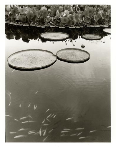

I did a test recently with this film. My film spped for 120 was 200. Development was in pyrocat 1:1:100 for 11 minutes. I got a zone V density that was about .65 +B+F. The film has a blue base that will not wash out. In my opinion the film is a little softer than HP5 with slightly larger grain. Overall not a bad film. Certainly worth the price. Its probably a little too soft for my liking.
