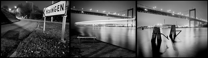

And here are some examples. Bigger versions and/or prints will be posted here:
Dead Link Removed
