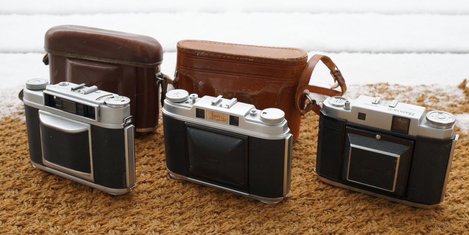

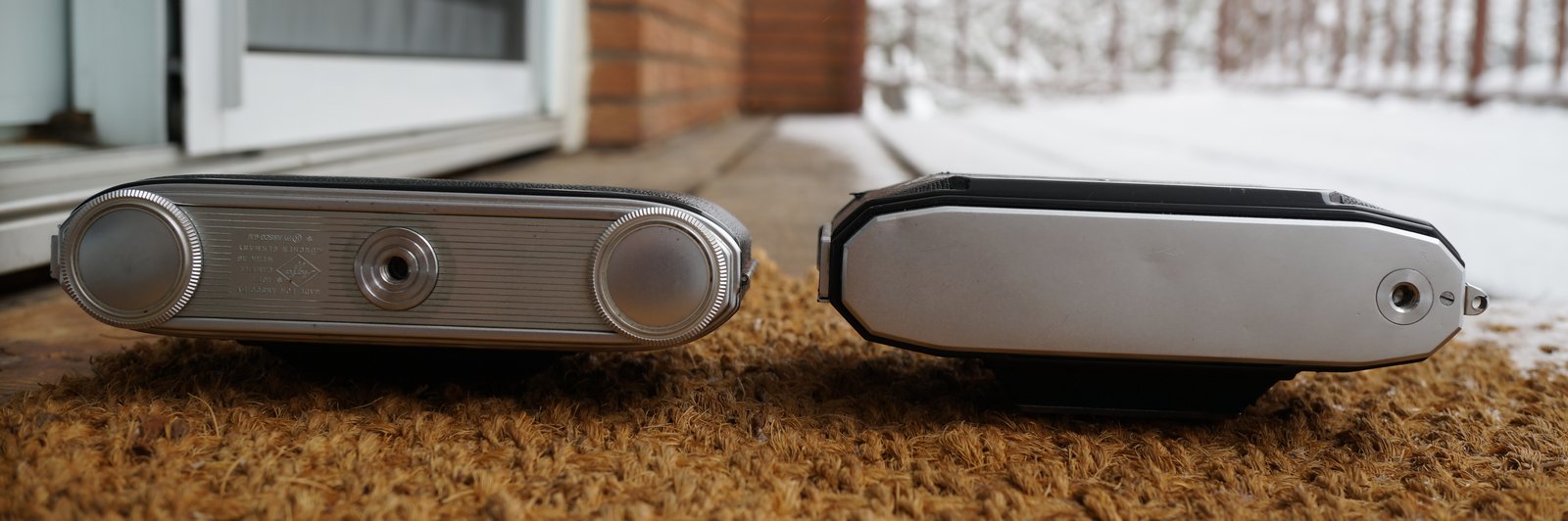

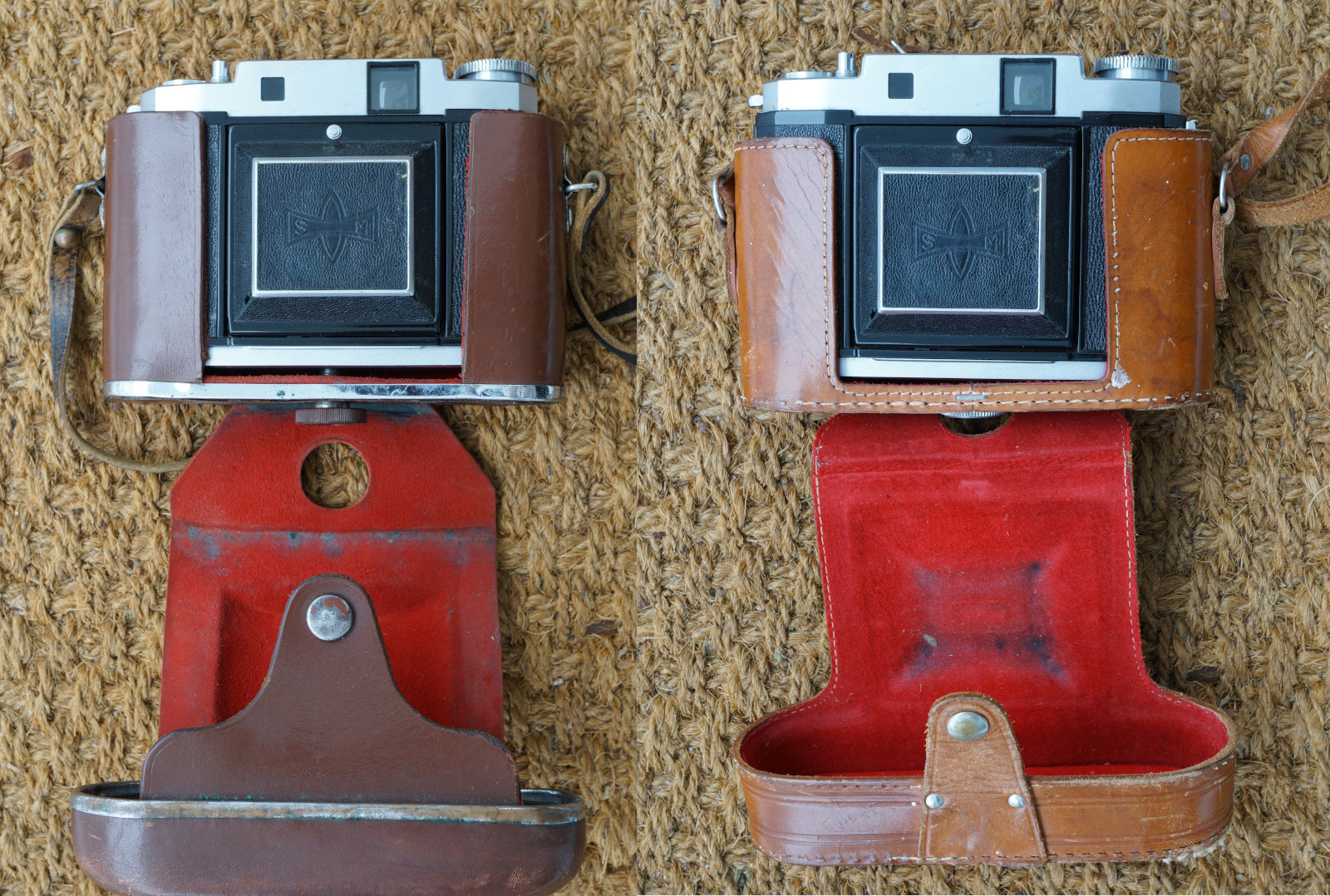

Iskra II, Ansco Super Speedex (Agfa Super Isolette), and a version of the Mamiya 6
The Ansco and Agfa are the same camera, and the Iskra is a copy, but the Iskra uses a 3/8 tripos thread, while the Ansco uses a 1/4, so while cases fit each other, they don't mount properly - but that is something you can modify.
The Mamiya is thicker due to the film plane focusing, and the tripod mount is also off center.
However, the the Ansco & Iskra cases are flexible enough that the Mamiya 6 (or this version anyways) will fit into the cases.
You would still have to move the tripod bolt to the side, but that is something that "can" be done...

There really aren't any bumps or protrusions on my 6. I would rarely if ever use a tripod with my 6 so I could probably remove the knob from the case completely and just rig some velcro or other cheepncheesy system to secure the camera in the case. The tripod mount on the 6 is pretty much flush so that won't interfere.
Thanks itsdoable, you said it was notdoable but you have proved itsdoable!
