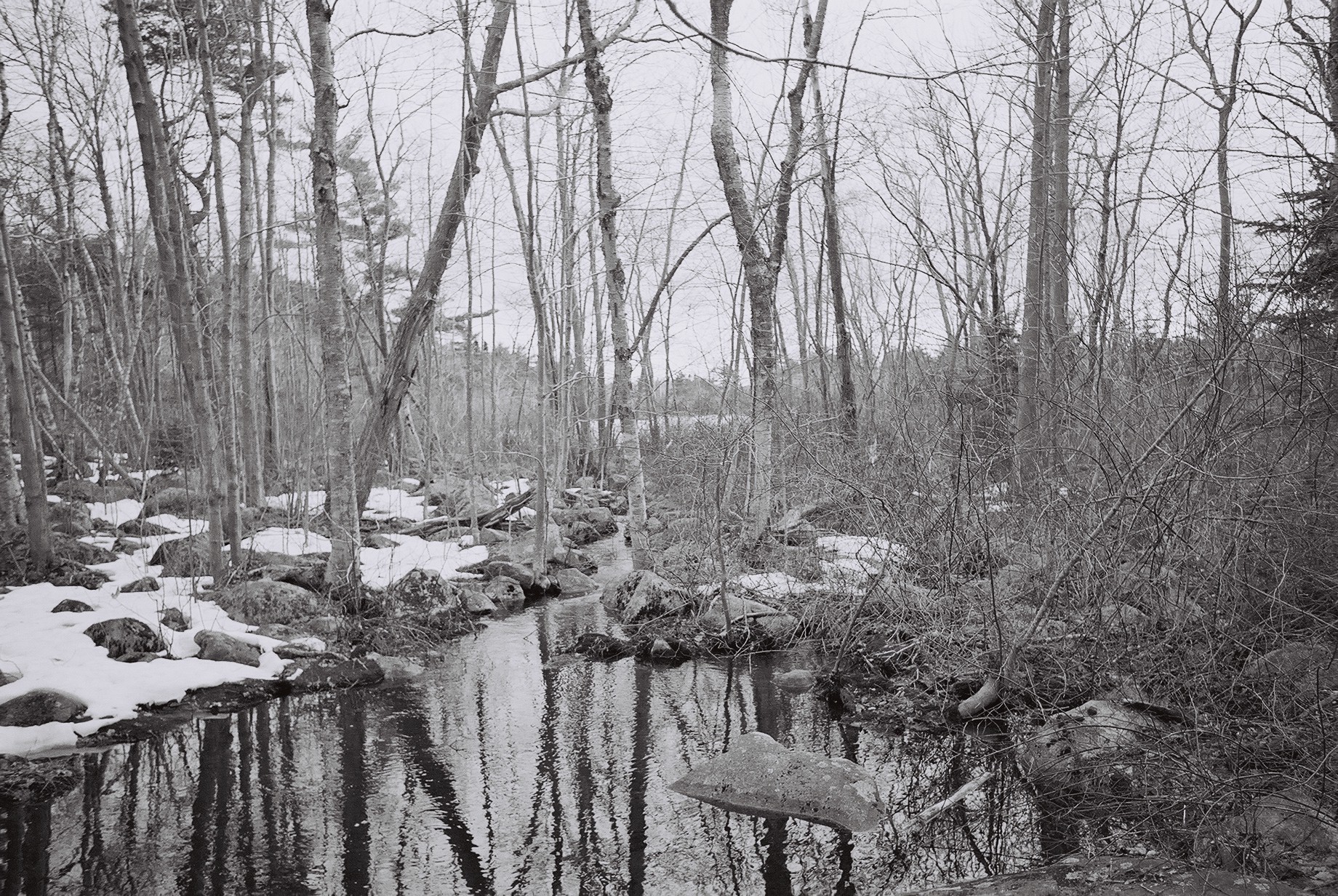

So here are a couple of photos. One shows an "okay" photo and another shows a "flat photo". Seems to me to be a big difference between the two. Obviously the flat photo was on a very sunny day (see the hard shadow). Yes, I did cut the head off. In my defense I'm surprised I even was in focus.

likely underexposure in the second one. The lab does a crude correction of the print/scan to make it lighter, resulting in blacks that aren't black. that could be fixed to a large degree by a competent printer, either with digital or a wet print.
MattKing
Apr 24, 2005
52,880
Delta, BC Canada
Snow or sand or any large, bright part of the subject will tend to:
1) cause the meter to recommend too little exposure; and
2) cause most mini-labs to print too dark.

It might just be me but the first "okay" shot looks a little flat as well. The shadows of the trees in water suggest that there is enough contrast but the background of the trees and ground looks a little more grey than I'd like.
Anyway irrespective of whether this is just my taste, the point I am alluding to is that there may be a tendency for the lab to print "flat" in both instances but it shows up much more in the sunny pic
Do the two negs under a loupe or even to the naked eye look closer in appearance than the two prints do?
