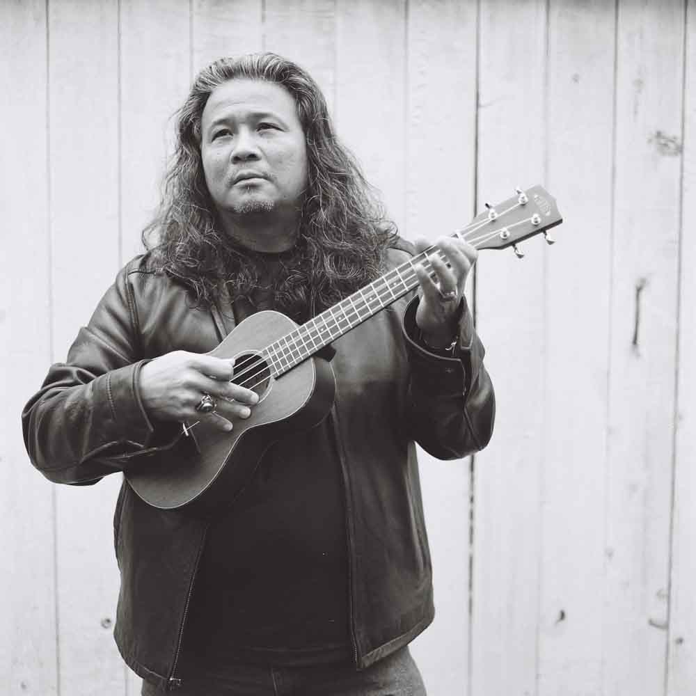

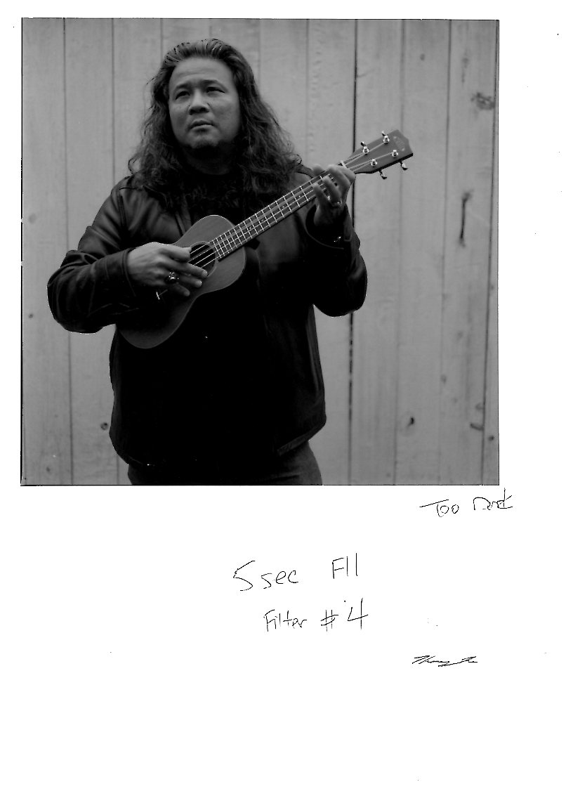

Hi, I've attached two images from the same negative showing one printed from a professional lab and the other by me. I'm struggling with short exposure times and flat dark images. I'm using a Durst M605 diffuser enlarger with a GE EKG 80W 19V bulb. My print was enlarged at f11 for 5 seconds while using a Ilford Multigrade #4 filter. I'm guessing 3 or 4 seconds would have been a better exposure time but I thought that was quite short especially with a filter already in place. Do extremely short exposure times impact contrast?
Thanks for any tips you might be able to share.

Is the negative flat/exposed correctly? Did they print it optically (wet lab) or scan it and print it with an inkjet?
Looks like you need less time, but contrast level looks good. I'd hazard a guess that your negative is thin (overexposed) hence the short times.
Printing larger would give you longer times, did you try a test-strip at 8x10 enlarger head levels?

The negative should be correctly exposed as I used a light meter and they printed it in a wet lab. I didn't do an 8x10 enlarger test strip unfortunately but the picture that I uploaded is actually 7x7 so it's not a small enlargement.
I'm losing details in the shadows and don't really have any highlights.

The negative is probably pretty thin if your printing exposure is that short with a diffusion head and MG filter in place. Next step is f16 at 5 sec. After that you can sandwich a piece of neutral density material with your contrast filter (if above the negative). Can you show a picture of the negative? You probably don't have any way to measure the density of the shadows or highlights, right?

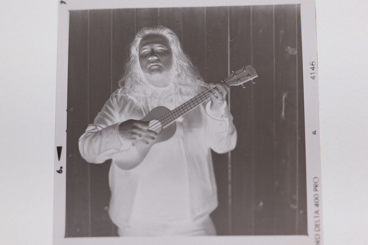

Hi ic-racer here is a photo of the negative held up to my computer monitor. I'm not exactly sure how to calculate density...

It looks like the shadows are a little thin, but otherwise it shouldn't be a difficult neg to work with. Less total exposure over a longer time period will give you time to do a little dodging on the shadow detail as well...

Are you pulling the prints before they are completely developed? People tend to do this when they find that the prints are becoming too dark. This results in muddy looking prints. Most paper developers recommend a development time of 1.5r to 3 min. Try a shorter exposure time and 30 to 60 sec more in the developer.
Anything to bring up the contrast!
To match that you would follow Gerald's advice and print on a contrasty paper, maybe a grade 4, with less exposure and more development. Concentrate on getting the face right, it's the part with the best mid-tone and the focus of the picture.
I did a quick and cheesy copy+paste of that negative into Paint.NET and did the following to test that theory:
spread out the levels to full range because the negative isn't dense enough (it needs more development from the low initial exposure?)
goosed the contrast up 30% and lowered the brightness -15% (this brought out the face really well)

Oh hmm I'm using Ilford Multigrade paper developer at 1+9 for 1:00 minute as recommended in the tech sheet. But i start taking it out with 10 seconds left and then drip dry before putting into my water(stop) bath for 30 sec. TF-4 Fixer for 30 sec. and then back to the wash for 5 minutes. I've been pretty consistent with the temperature keeping at +/- 1 degree from 20 C/68 F
I'll give 1:30 a try next time.

I'd suggest a range of possible factors.
Pulling the print early is always a sign of a problem - give 90 seconds and adjust exposure and contrast, not the time in the developer.
The developer should not be colder than 20C as this will have pretty much the same effect as pulling the print out early. A couple of degrees over is not a problem.
Check your safelight and any other lights in the darkroom (light leaks round doors, red lamps on extension cables etc.) as any fogging exposure can interfere with the light you are choosing to squirt on to the paper. Even if the fogging exposure isn't enough to make a tone on it's own it will affect highlights especially.
How are you filtering? With a colour-head or filters? Confirm the values with the instruction leaflet in the pack of paper.
Use stop bath (as recommended by Ilford). Paper carries over far more developer than film and remember that water-bath development (google it) was once a way of reducing contrast. Developer carryover will also quickly kill your fixer.
Thirty seconds in the fixer is the minimum time at a minimum temperature of 20C. Where you are using easy-to-wash RC paper you can safely allow a little more time and give constant agitation. Be very certain that you are using a 'rapid' fixer at film-strength (1:4 for Ilford Rapid) and not the older hypo-fixer (in either case you would need a much longer fixing time). Under fixing isn't going to help the print in a few years time . . .
Read Bob Carnies enlarging thread, (there was a url link here which no longer exists).
For this particular neg, there is tone even in the jumper so you should be able to get that barely visible in the print too. Start with Grade-3, take a stop and a half off the exposure you previously used (remembering to also allow for the speed-change across grades, if you are using filters), to see what you can do with the subjects face, it is where everyone looks in any portrait, adjusting time until the face looks ok. Only then adjust the contrast, if necessary, to change the darker tones towards where you want them - additionally the dark jumper and jacket could be burnt in with grade-5 a little, in order to make the darkest parts go just to black for example. The plain background might also want slight darkening in the corners, for example. Remember that you can add tone and black by burning in, with appropriate filtration, so the basic exposure is the one that just gets you the starting point of (for example) the face - of course, sometimes it is more practical to dodge a small area than to burn-in, it depends on the scene.
Make notes of everything which you are doing. You can usefully make a short series of prints of the figure, with half a sheet of paper centrally, at grades 1 to 5 while adjusting the time to keep the face about the same tone. It will help you as a comparison for your next test-print to suggest the direction for you to adjust in.
