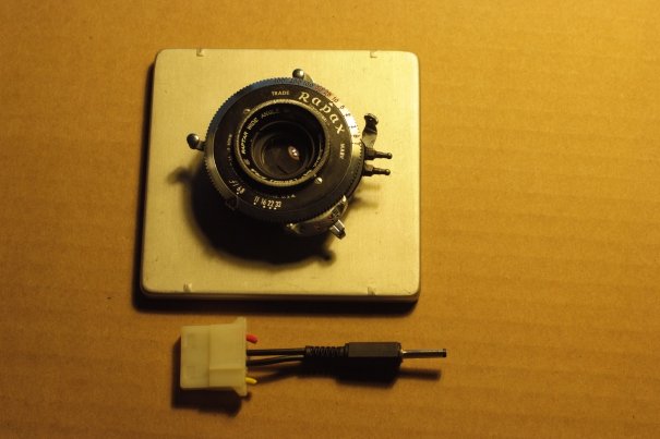

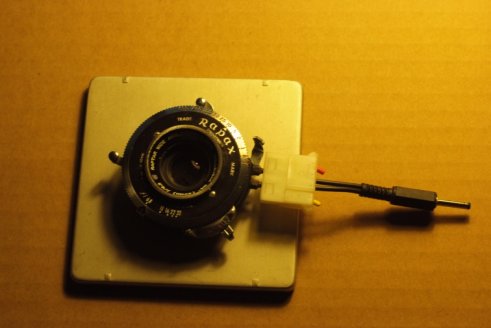

As for the cord, you can easily make your own, like I did (see attached pics). Anyone who's ever seen the insides of a typical desktop computer will know what's that white plastic part :smile: Two wires and a flash connector (I used what I had on hand), and Bob's your uncle :smile:

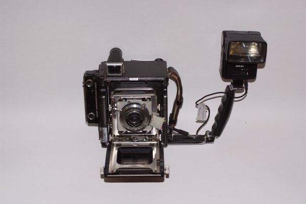

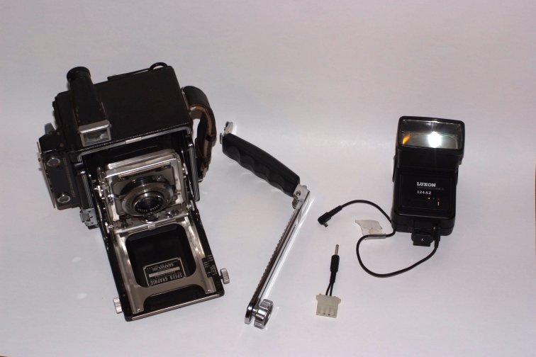

Here are two pics which will make it easier to understand.
One pic is the combo as it may look like, and the other shows the component parts. The only difference to your situation is that the camera in the photos is a miniature Speed Graphic (2x3) instead of the Busch Pressman - everything else applies just the same: a flash cable (plus the DIY flash cord bipost adaptor, or the Paramount cords one if you decide to go that way), flash handle/bracket, and a separate flash (any kind you're comfortable with).
