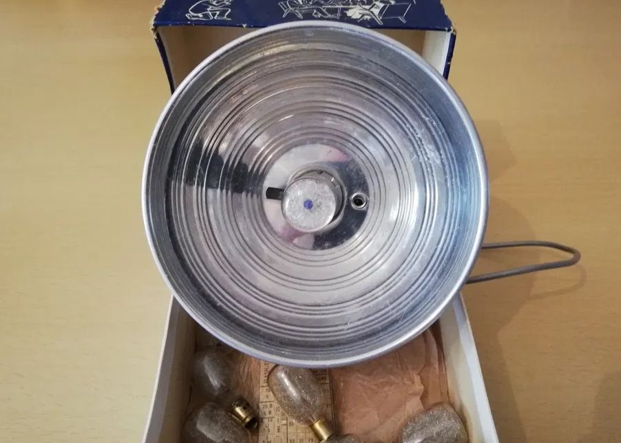

It's hard to find a flash unit. Bublbs not so hard. They still do make bulbs! 60 U.S. $ per 10 pieces.
I wonder if at this you can put bigger bulbs.

Focal Plane flash bulbs may have been a rather regional thing. Out of the two major west-european manufacturers Osram and Philips only Philips made such. And not even from the start. Furthermore in none of the west-german or european sales catalogs I got, I found them listed.
Also in german textbooks this type was the first no longer hinted at, when other types were still described.

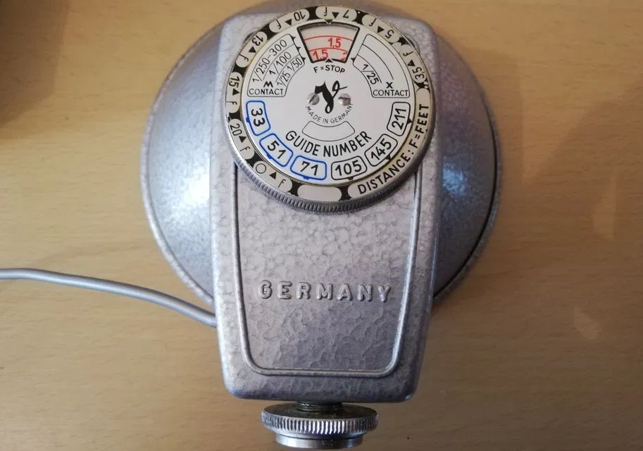

@AgX , how hard is to find in Germany flash bubs? Looked for Vakublitz and Vacublitz, not many results. But I think in German there are books about flash usage... my bad that I don't speak German, but probably I can understeand part of such an book.
Here is the rear of the above flash.
