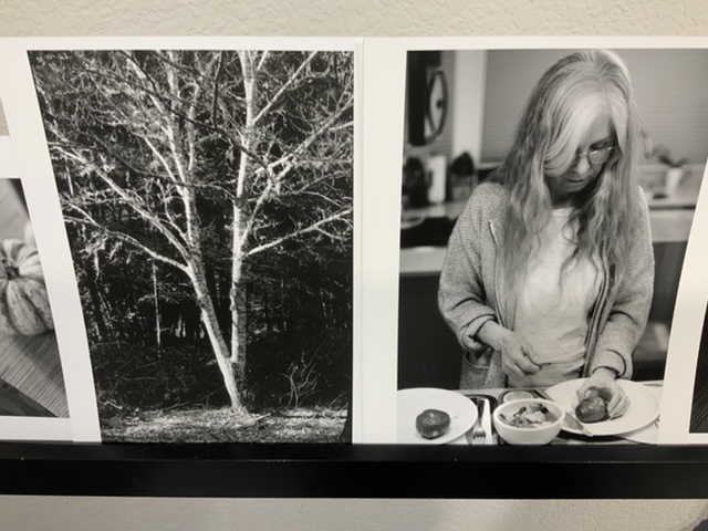

So far I have mainly used ilFord FP4 plus and a little Kodak Tri-X. The TMX seems to have way less tonal range or I’m doing something wrong. The negatives below were shot with a Canon F-1 using the cameras meter. Then developed in my Super Sidekick machine at 3:30 time using HC-110 dilution B developer. fYI the machine runs developer at 75 degrees. Seems like shadow detail is not great and at the same time highlights are clipped, see tree shot. The negs print using 1.5 - 2.5 contrast filters so that part seems ok.
Tree 1.5 CF Wife 2.5 CF

I'm using the camera's meter. Looks like some frames print with too much contrast already. The tree is an example, as it has blown highlights and poor shadow detail, wouldn't longer development make it worse?

I thought they looked a bit thin too, not much, but maybe a bit. I'm worried about losing anymore highlights, they seem very close to being right but I would like a bit more shadow detail in the scenes that were captured in midday sun.
don't count his film out yet.developed in the Jobo in D76(1+1) for 11 min, it has a great tonal range and I often use it for skin tones because of that. that said, it's not a very sharp film.

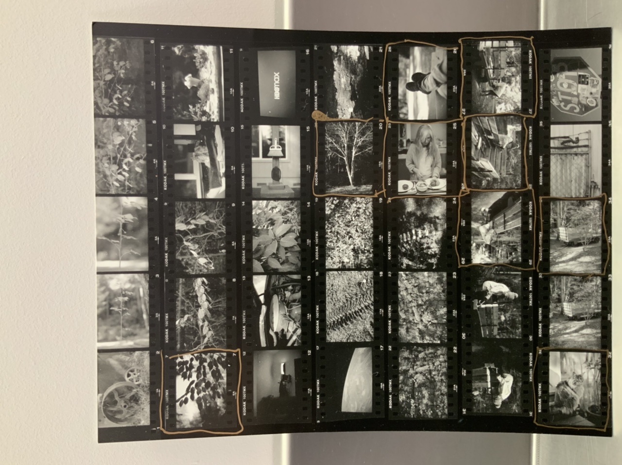

Based on some replies, studying the contact sheet, and a bit of common sense. I think some of the frames were just underexposed. I'm going to print all my picks tonight and report back on how the better exposed frames turn out.

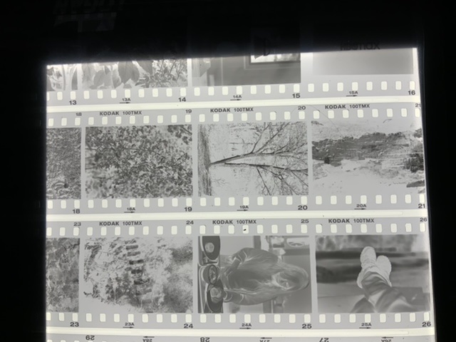

The tree is still perplexing. I just looked at the neg and the blown out trunks have lots of detail. I'm going to try again with longer exposure and maybe a lower filter. I'm interested to know how good I can get in this situation without any dodging or burning.

Hard to say over the web, Bill. But the posted negs themselves look distinctly underexposed and overdeveloped to me.

So what filter were you using for the “tree” frame?
