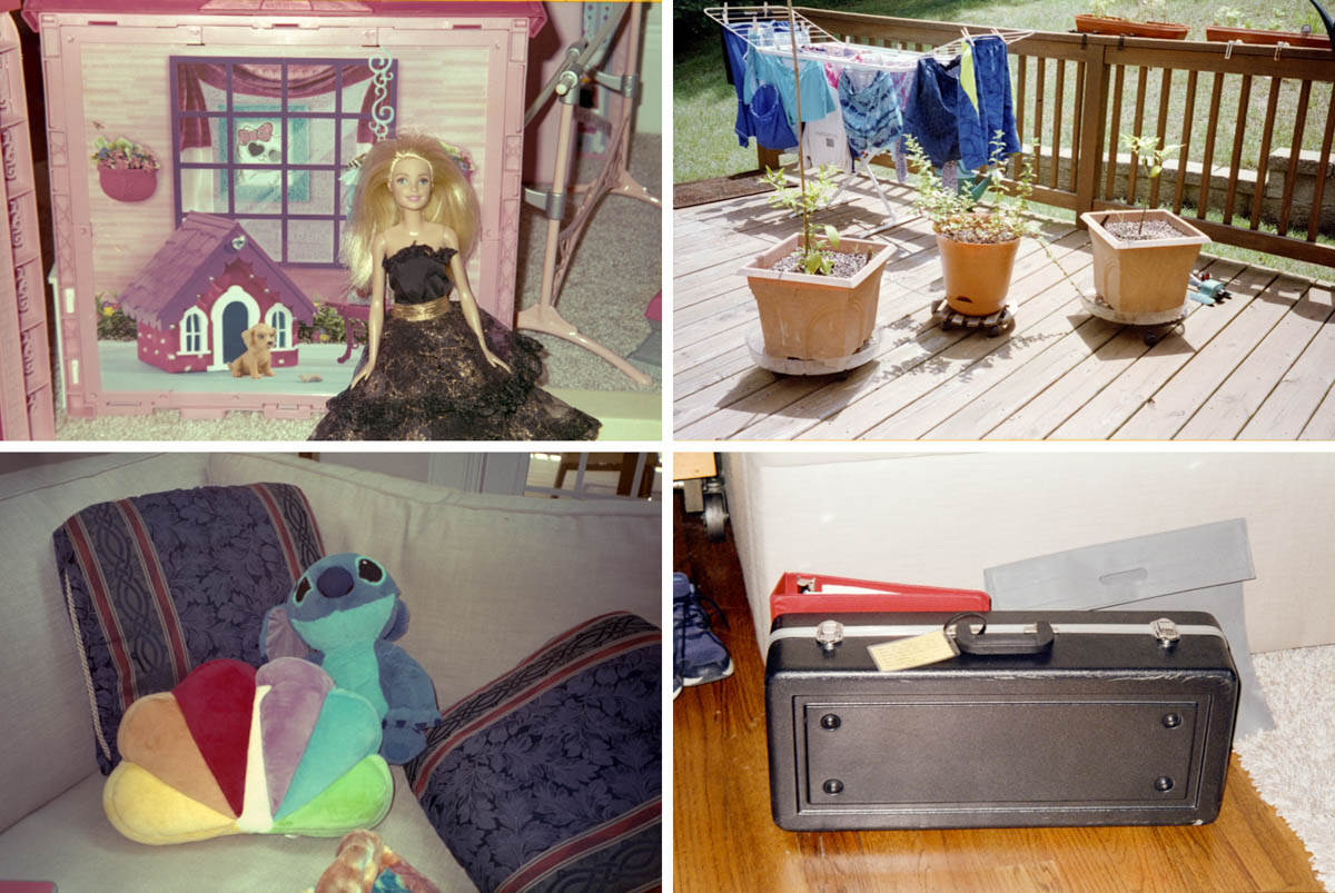

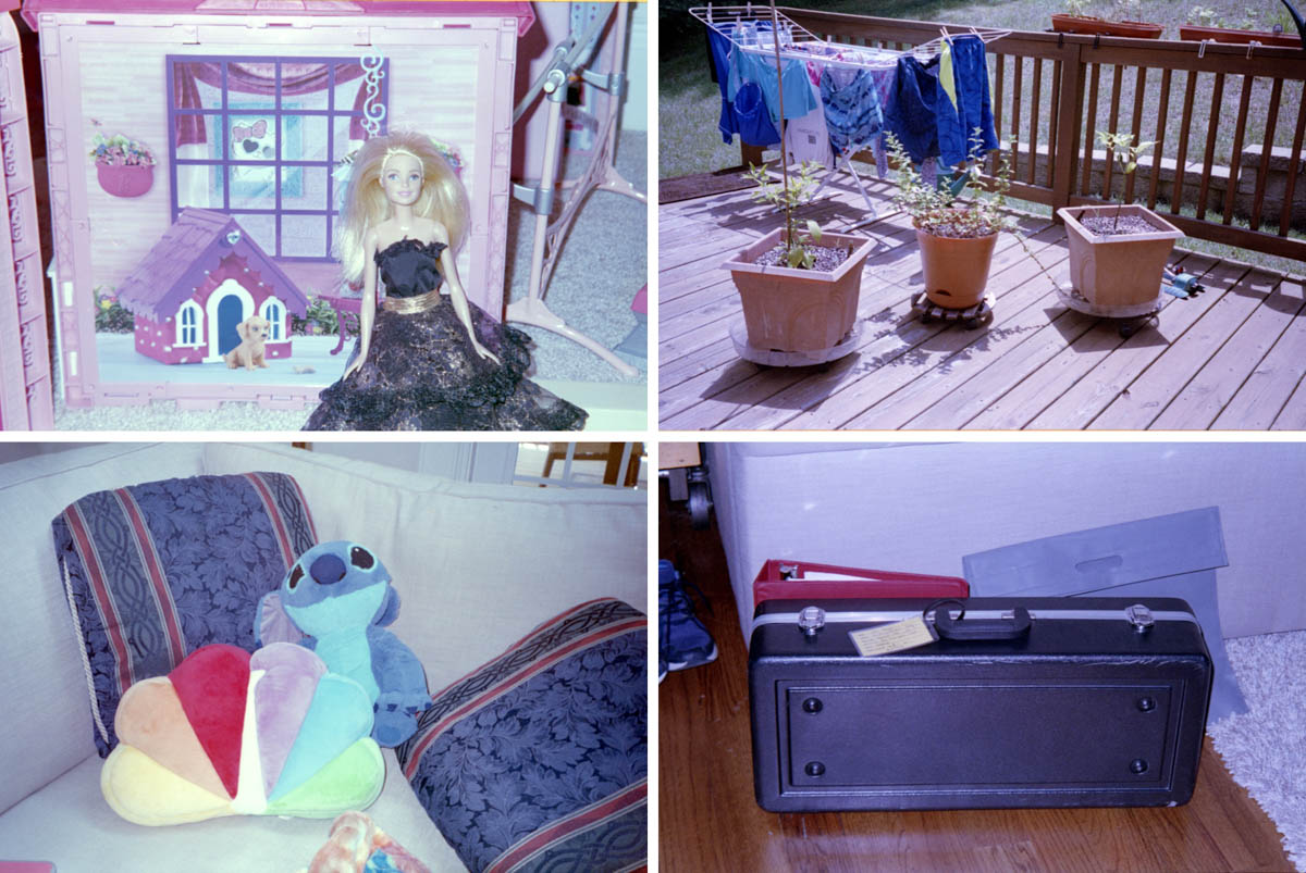

    That was pretty vague, wasn't it? (sorry) It was a roll of Fuji S-400. My daughter chose to take pictures inside, and I didn't realize it was with flash (it was automatic). I don't think it was a colour shift (but I don't know, this is my first roll). Rather, I think it was the white balance as @RattyMouse pointed out. I've posted 4 images below, the first set of 4 is what the scanner gave me (generic negative scanning). The second set of 4 is after a quick white balance adjustment. (Please, don't judge the pictures...I just needed a test roll).
    I honestly just don't know if it's the developing or scanning. It could be that it's all correct and that it's normal that there are white balance tweaks needed.

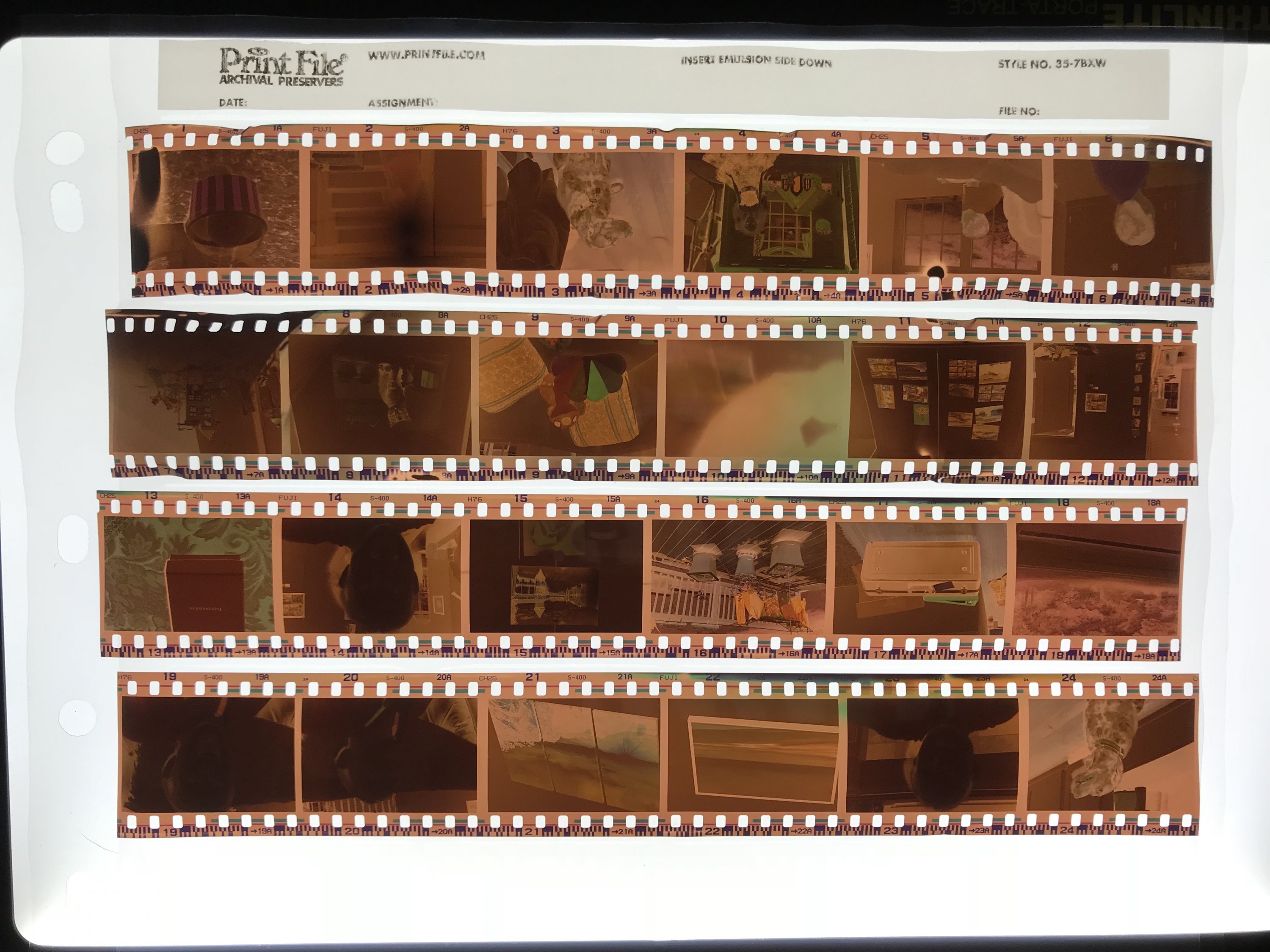

    Can you post an image of the negatives (a strip) on a light box? A blank text document opened full screen with the negatives held over it works fine.

    @shutterfinger - All were scanned with Professional. The images on the left (top and bottom in the image above) Color>negative vendor>Fuji, Color>negative brand>Super G, Color>negative type>400 Gen 1. the images on the right (top and bottom in the image above) were Color>negative vendor>generic, Color>negative brand>color, Color>negative type>negative.
    In the image below/attached, the first two rows were scanned with a Fuji preset, the bottom two rows, were scanned as generic.

    Looks like a magenta/blue cast, the later shots look better, presumably sorted by white balance correction after scanning? Don't beat yourself up about it, we've all been through it, takes a little time to get the confidence and understand what you're doing, looks like you got the temp right anyway. The critical temperature is the developer, the rest ( Bleach, fix, stab) can be a few degrees either way and it won't be a problem.

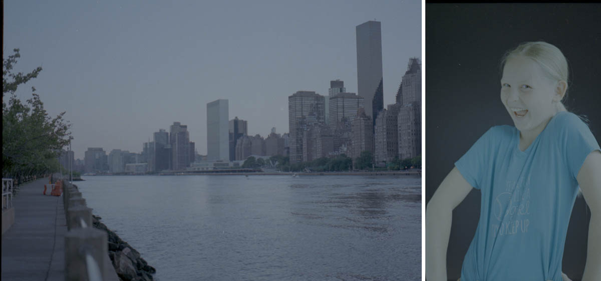

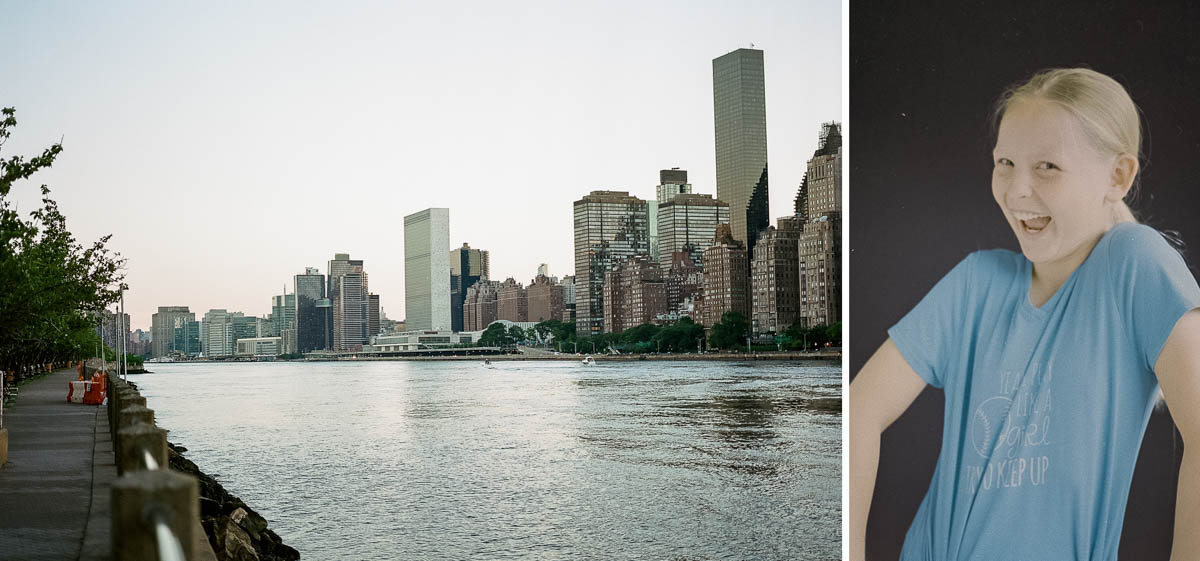

    Thanks! I was at 108 when I developed it. I'll try again tomorrow with a closer temperature match. My monitor is properly calibrated - the scanner...who knows? (I'm still getting to know vuescan - the Canon software isn't recognized by the updated OS so I had to get something new ...) I was curious to see how terribly off i was in the processing, so I pulled out a negative from earlier this summer that I had sent out to a lab to be developed and scanned (on the left). On the right side, is an image from today. Top is the way the printer delivered it, bottom is my processing (camera was a Yashica Mat 124G). Not too far off, but I now see that there is quite a bit of processing involved as well with film. And, more importantly, I see now why all the images from that particular lab all feel the same.
