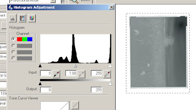

Anyway, I'm finding the histogram/slider adjustment of the Epson scan very confusing. I keep thinking the left slider has something to do with shadows, but then if I pull in on the right slider, the preview goes totally blank. Can someone explain that to me?
I agree ... let me see if this explanation sits with you
first, never work with a negative as a negative in Espon ... the sliders work in a non-linear manner and it just roots things up. Work only in positive mode and totally forget about working with it as a positive until you're in Photoshop.
So looking at the slider:
you have an upper and a lower slider. These set where you want your dark levels and light levels. In this image I've laid the neg (4x5 sheet) on the glass and let some of the vacant clear glass become part of the selection for the purpose of explaining base fog ... that's why there is a big spike of levels over to the right in the "white" area, which will of course become black when inverted.
The film base itself will be your black, so you should snuggle the slider over to just get that (since its nearly clear its on the right in positive).
