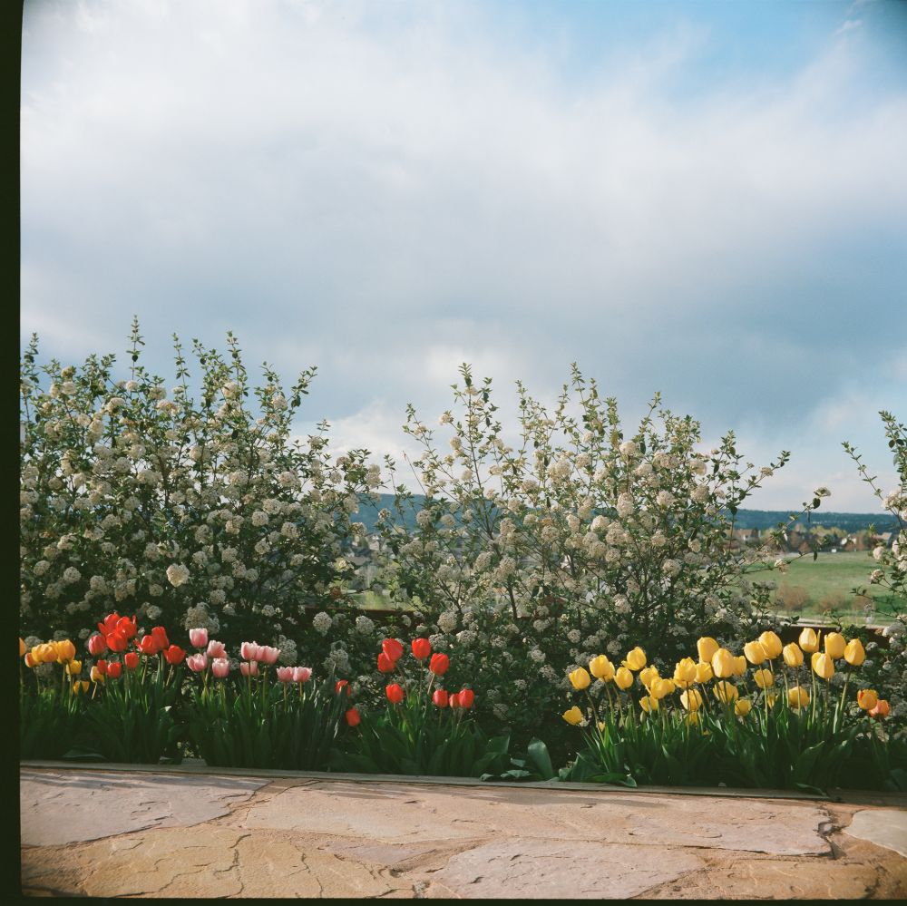

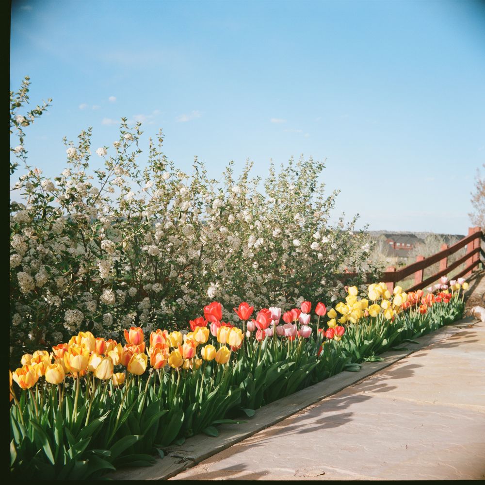

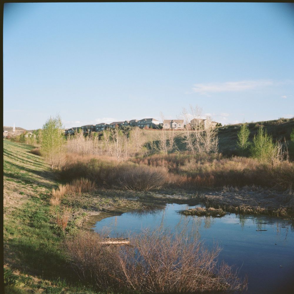

Here are lab scans of some shots from the first roll of Portra through my Zeiss Ikonta 521/16 after a fresh CLA. All exposures were taken using Mark-I Eyeball Sunny 16 light meter. It's nice to finally know the real shutter speed.
I'd really like some comments and tips for improving the use of this cameras attributes and/or working around its limitations. Of course, the photographer's (lack of) skill is fair game.

Did you have a filter on there? I see darkening in the corners.
Those littler cameras are great. My word of advice is to stay between f/8-f/16 for sharpest and opening it up for pictures of people or a somewhat softer look. Getting a fully multicoated filter helps too since those older lenses are prone to flare.

Klainmeister - No filter, but that's a great idea because I have learned to keep far away from the sun and to shade the lens if I can't. Maybe a ND? And in the case of using Portra during the day, it pretty much has to stay around f16 because the fastest shutter speed is between 1/250 and 1/300. Hmmm. An ND might help to bring in a little exposure flexibility too. I wonder if they can be found in Series VI.

For daylight, yeah, maybe a nice coated ND would do the trick. I just remember...and lord knows if I still have them lying around.... putting a nice HMC filter on mine and saw a dramatic difference in color, contrast and haze from that camera. Is it the Tessar? At the time, I was using mine for BW with Plus-x and no filter, shooting at f/8 or so with beautifully smooth skins and just enough center sharpness to give a really effective portrait. I then started filtering and took it backpacking and have a shot, which I will post whence I get off work, that was taken with Velvia 50 and it's quite amazing actually. I love these cameras.

Tessar? Sometimes I wish it were, but I don't shoot much wide open where it shines. This is the simpler Novar. A UV filter would probably be a very good thing, so that's been added to my list for the Denver swap meet this weekend.
I did shoot a roll of Velvia last fall and it was pretty disastrous. I had thought the lens just didn't handle color properly. From this test it's pretty obvious it was the photographer's fault.

What you posted appears to have vignetting in the corners. Is that an artifact of scanning or is it on the negatives?

Sirius, the vignetting is the camera. It doesn't happen at all apertures, but I never kept close-enough track of it to remember when it goes away. This whole roll was shot at f16 because iso 400 is just a bit too fast for the top speed of 1/300. I'm looking forward to finishing up the panf that's in it now to get a better idea of how other apertures affect it. I'm thinking this camera might work best with iso 100 film.

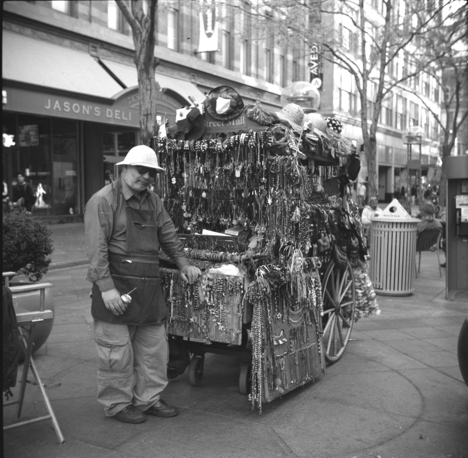

Here's one from a couple years ago. Delta 100 in DD-X, I think, and probably around f5.6 or f8. Notice the absence of vignetting. The high-res version shows wonderful detail in the jewelry.
Edit to add: I really like the well-mannered bokeh. It just softens into a completely non-distracting blur.
MattKing
Apr 24, 2005
52,894
Delta, BC Canada
Maybe it is just me, but I seem to see vignetting in at least 3 of the corners.
But I agree about the rest.

Kinda odd, my Super Ikonta never had issues with vignetting. I'd get out of focus areas in the corners due to the lens design, but never darkened. Hmmmm.

Matt King - I can't decide in this particular case if the darkening in the bottom corners is vignetting or if it is because there are objects there to cause shadow as seen under his cart. If it is vignetting, it is much less pronounced than in the other shots. I haven't shot it enough to know just how it behaves, but the vignetting you see in the OP is about as bad as I've experienced.
