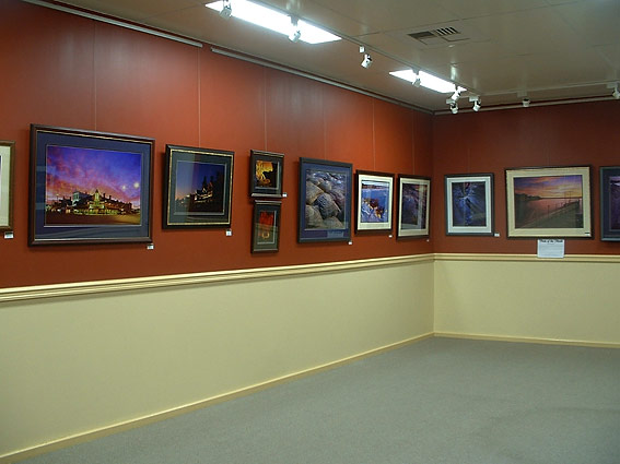

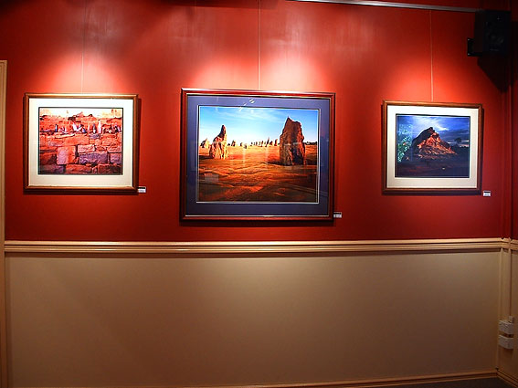

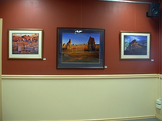

Phill,
If your print looks good in daylight, your room is probably too poorly lit at night. I think you should get down-lighting installed in your living room (ideally, track lighting). Halogen down-lights of 50w work well. Install them about a metre from the wall on your ceiling.
In our gallery we have down-lights running all the time and we've darkened the windows to stop daylight coming in: we control 100% of the light on our prints. When a friend wants to see what difference there is between track lights versus flouros, I take them into the room and show what the gallery looks like under fluorescent lights. In most cases, they are stunned by the difference. The room becomes flat and dull under the evenly lit fluorescent lighting. (I'm going there now, so I'll post two shots shortly).
Cheers,
Graeme Hird
Jun 2, 2004
689
Fremantle, W
I've attached four photos from within my gallery which show the difference between shaped lighting and difused flourescent lighting. I hope they help with your problem Phill.
