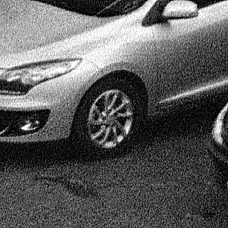

First I made some clear PaRodinal:
http://photo.net/black-and-white-photo-film-processing-forum/00UxmB
20ml 10% hydrochloric acid was added to 50ml clear PaRodinal,giving a precipitate (p-aminophenol) which was allowed to settle 24hrs,the clear liquid decanted and the precipitate filtered off,being left overnight for the liquid to soak through the filter paper.
48g sodium sulfite was dissolved in 600ml water(=80g/L sulfite).The filter paper and contents were soaked in this solution,the precipitate soon dissolved at room temperature.
HP5+ was developed 20m 20C in this solution,I call it PRS-1 (PaRodinal Solvent),see attachment (a 0.1 in square section of negative),this is from EI=320.

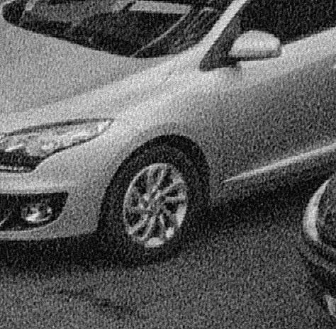

For comparison I don't have HP5 in Xtol so give Tri-X in Xtol at EI=400.
Evidently p-aminophenol/sulfite works but more work woul be needed to see if it is possible to make a developer giving as fine grain as metol/sulfite.

Original Rodinal is p-Aminophenol in sulphite with no free Hydroxide, so similar but with a much higher level of sulphite.
The sulphite in Rodinal is generated by adding Potassium Hydroxide to Potassium Metabisulphite the difference beteween Calbe/Orwo R-09 and agfa (post 1963) Rodinal is the first has no free hydroxide, the second uses less developng agent at a higher pH wit an excess of Hydroxide.

Yes, this is interesting. I think the issue in practical use is whether the developer lasts long enough, and whether the developing times are too long for some to be practical. But that p-aminophenol can be made to act in different ways depending on the formula (just like metol or phenidone) is good to know. I have read somewhere that using Rodinal at much colder temperatures (16 C) also gives finer grain, and the converse is of course also true. It is also super-additive with ascorbate etc. That out of all the possibilities we have only Rodinal as a widely-used developer, is then strange given how many metol and phenidone formulas there are. I can only guess that it has to do with cost and/or a lack of longevity. Do we have any indication how long the original Rodinal (not the replenished) lasted? My understanding is that it was used as a stock solution, not single shot concentrate that had to be diluted. With those sulphite levels, the sulphite would be the major contributor to cost, not the developing agent. Which might explain why it wasn't pursued commercially.
There's no evidence that using Rodinal at different temperatures has any effect on the grain size in a negative. However the hydroxide in Rodinal can have a softening effect on the surface of the emulsion causing micro reticulation, this only occurs when temperature variations are excessive during processing and is more likely to happen at higher temperatures. The results is prints with more apparent graininess.

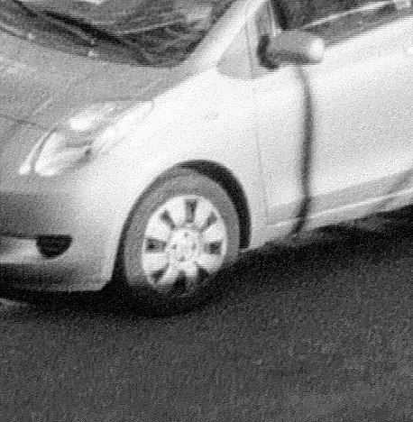

HP5+ was developed in LS-1b 10m 20C, EI~250, see attachment showing 0.1 in square section of negative.
It's a mid-acutance rather than fine grain developer.
Later I may try washing soda crystals instead of sodium carbonate anh, the developer could then be made from Paracetamol,Caustic Soda pellets, Ascorbic Acid (Vitamin C from the health food shop) and washing soda crystals.

Alan - what just looking at the three photos you've posted, the first looks by far the best in terms of grain, the second starts to look mottled/clumped, and the third just above is looking like some form of reticulation. What do you think?
What you say may be true and the grain comparisons would need to be done again using the same film and scanning procedure for all.
