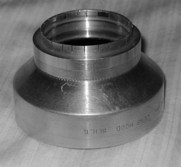

My Optar has a slip on adaptor that fits over the lens and then the series filters fit inside it. I will post a picture of it when I get home. SK grimes could probably machine a slip-on adaptor for your lens so it can take your 58mm filters.

Here is the photo if I can get it to link...if not it will be in my gallery.
