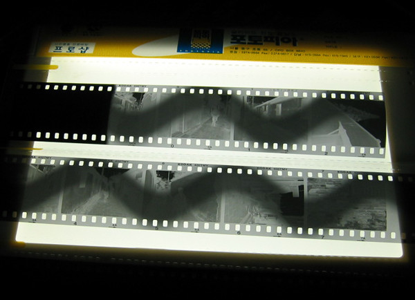

Here's the result of x-ray damage, happened to one of my friend. Kodak TMY.
He put the film in checked-in luggage, flying from China to Incheon aiport Korea.
