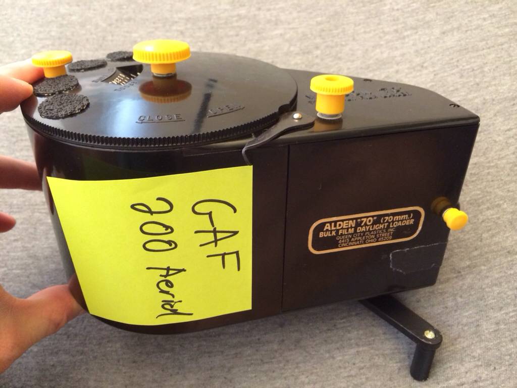

Hello,
I finally made the move into 70mm film to be used in a Hasselblad 70mm film back. I have the the cartridges, developing spiral and tank, and 150 feet of Kodak Double-X. Using old Verichrome film that was in several of the cartridges, I can load 16 feet of film on a spool and my developing spiral will take up to 18 feet, so that problem is taken care of.
The question is, what is the best way of loading the cartridges from the roll of stock film. Are there loaders available for 70mm film, any homemade ones that have been built. Looking at how to best go about this, so I'm open to all and any suggestions and ideas.
Thanks!

Alden made a 70mm bulk loader that looks and works just like their 35mm loaders except, well, it's wider! I see those go by on ebay now and again.
Google says someone scored TWO of them for $8.00 at shopgoodwill.com back in August of 2013. If it's someone here, maybe they'll sell you their spare ;-)

Bogdan, that Verichrome you find inside can be still good film to use. Our own, Stone NY bought 70mm loader some time ago of Ebay.
Yes I did, I use it often, wish I had 2 of them!

Anyway the Alden looks like this...
