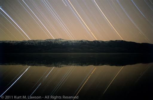

Here's one result.
Unfortunately I don't know the aperture on this one. I must have bumped it because all the other tests at the same time as this one were way underexposed and the exposure was identical to another camera. This was 3.5 hours with an Olympus 35mm camera and Provia 100F.

Great result Kurt! If you do figure out what the aperture was, post it here. May be a nice guide for others wanting to try it out with Provia 100F or a similar film.

Congratulations on bumping your aperture and ending up with a very nice pic! :D

Thanks. The pic is unfortunately not very sharp. It's kinda in focus on the left side, but drifts out of focus to the right. This was with the 50mm 1.8 lens, and I'm guessing it must have been at 1.8 but I'm confused how I could have out of focus mountains across a range when they are all over a mile away focused at infinity.

The camera must have moved during the exposure, or I guess it is possible that your lens mount is tweaked.
