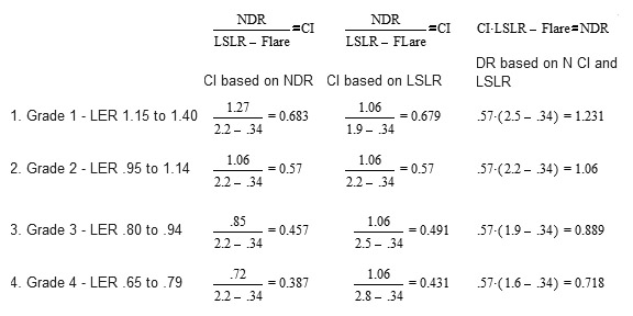

To answer the question about film processing having a correlation with paper grades or subject Luminance ranges correlating with paper grades, I've included an attachment.
A quick review on grades - diffusion enlarger:
Grade 1 = LER 1.15 to 1.40
Grade 2 = LER 0.95 to 1.14
Grade 3 = LER 0.80 to 0.94
Grade 4 = LER 0.65 to 0.79
The proof uses the basic equation Desired Negative Density Range (Paper LER) divided by the subject Luminance range - flare equals the desired Contrast Index. For simplicity sake, I've used a fixed flare model, which doesn't exactly represent reality, so you need to account for some slope in the values for the pluses and minuses.
The last column, I believe, is the way the paper LER values were determined. A normal scene has a Luminance range of 2.2 or 7 1/3 stops. A one stop change in the Luminance Range up or down equals a difference of 0.30. A scene that is one stop flatter has a luminance range of 1.9. A scene that is one stop more contrasty has a luminance range of 2.5.
The last column represents the resulting negative density ranges using the same processing but having different scene luminance ranges. The resulting NDR values line up closely with the centers of the different paper grade LERs.
The first column represents the what the CI would have to be for an the average scene Luminance range in order to produce a particular NDR or LER. If you are printing mostly on grade three for scenes that have a normal Luminance range, then your processing probably falls around CI 0.46 (example 3). This is why I think you are under processing and why I recommend re-evaluating what you consider Normal processing.
The middle column calculates the CI required to produce a negative that will print on a grade two for different scene Luminance ranges and a fix flare value. Except for Normal and +1 process, the fit doesn't match but it's close. Close enough to say that a +1 increase in processing can approximate a one grade change.
While it's not included with the example, a variable flare model has a closer match with the longer scene Luminance ranges than the fixed flare model, but not as close with the shorter.
