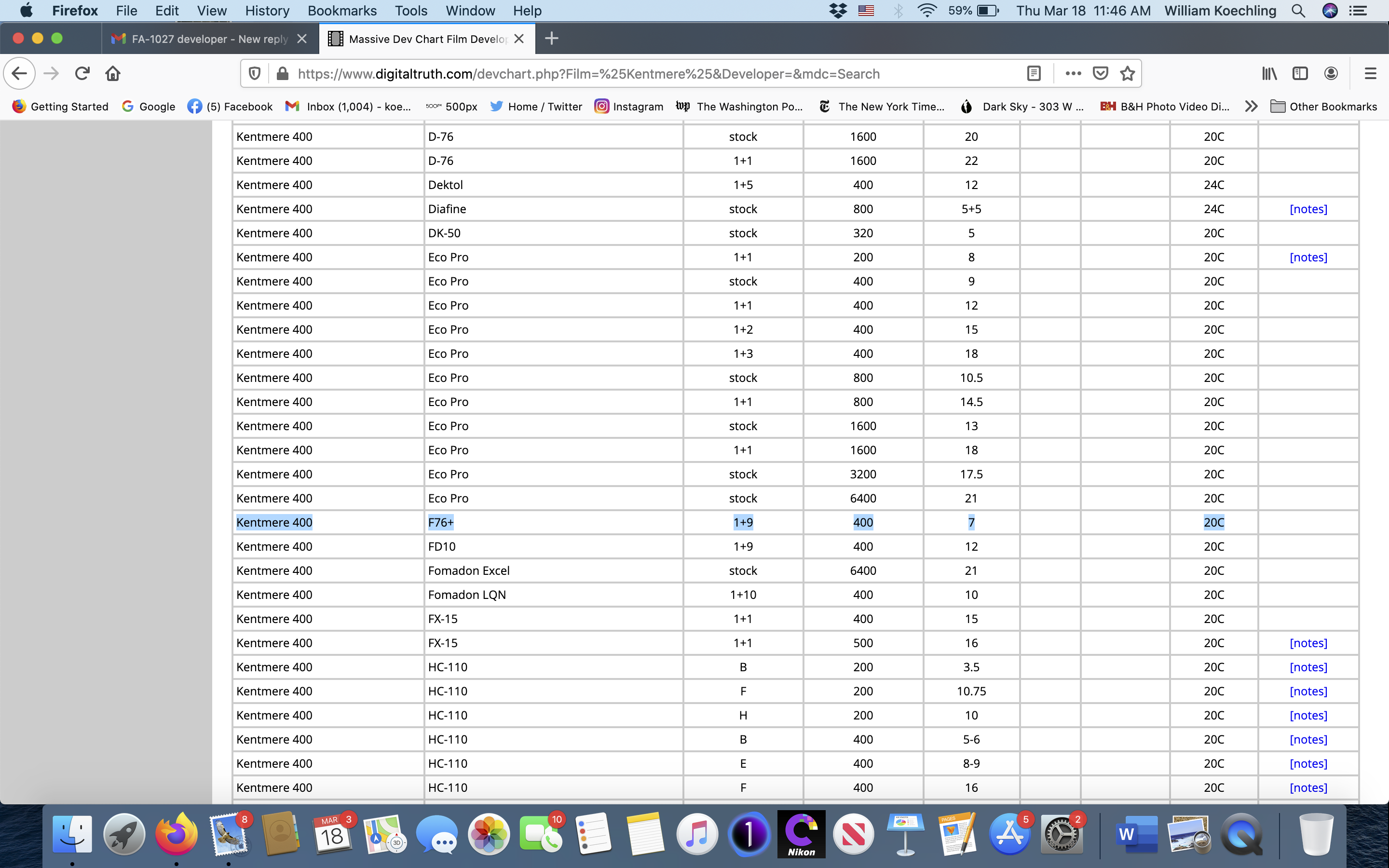

I've never used Kentmere 100 but I do see a single reference to F76+ being used for Kentmere 400. Like so many others I've found the Massive Development Chart helpful for finding a starting point.
https://www.digitaltruth.com/devchart.php?Film=%Kentmere%&Developer=&mdc=Search
Here's the single reference to F76+ which is the same as Arista Premium Liquid Developer.
bill koechling
Jan 27, 2017
24
chicago, IL
You might be able to extrapolate temp/times for your 100 speed film based on temp/times for the 400 speed film listed using other developers such as D-76 1:1.
cptrios
Oct 26, 2020
425
Boston
Yeah, I saw that on the Massive Dev chart, and also considered trying to extrapolate time differences for other films in other developers. The problem with that (other than that I have no idea what I'm doing) is, with D76 for example, whether to compare it to stock solution or 1+1. Comparing the 100 vs 400 times based on stock, you'd get 5.75 minutes in F76. Comparing 1+1, though, you'd get 6.63. I suppose I could split the difference? It's not like Kentmere is that expensive...

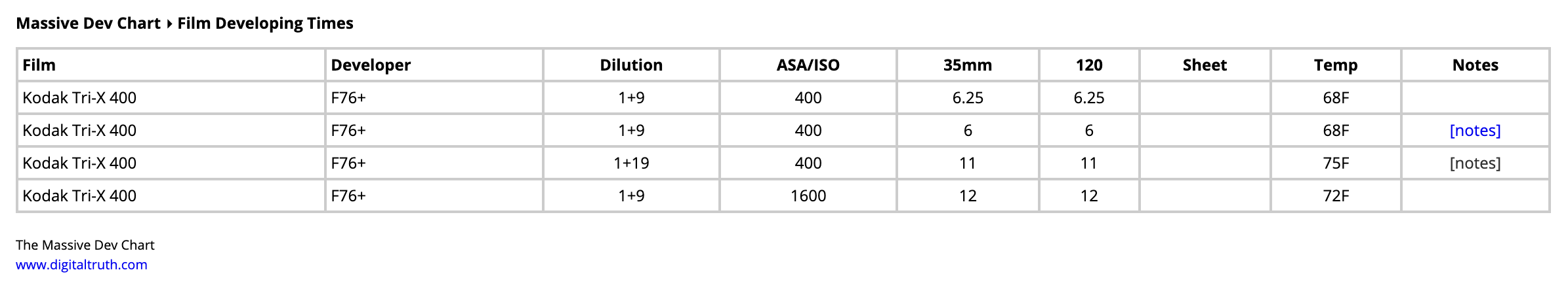

Interesting - are you increasing time slightly from the 1+19 recipe because you're at a lower temperature than 75, or are you using 1+19 and increasing time slightly from the 1+9 recipe? I feel like that might be a really stupid question.
bill koechling
Jan 27, 2017
24
chicago, IL
I hope I didn't confuse the issue. I'm processing Tri-x shot at 400 (some a little less) using the Arista Premium at 1+19 at 75˚ for 11 minutes as suggested in the Chart. It's the recipe that I prefer to the 1+9 at 68˚ for 6 minutes. I just don't like a development time that short.
