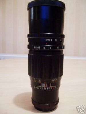

    Guess what, there's one on eBay right now. I thought the trick in the question was that the f-number is calculated from the diameter of the entrance pupil, not the diameter of the aperture.
    Best,
    Helen
