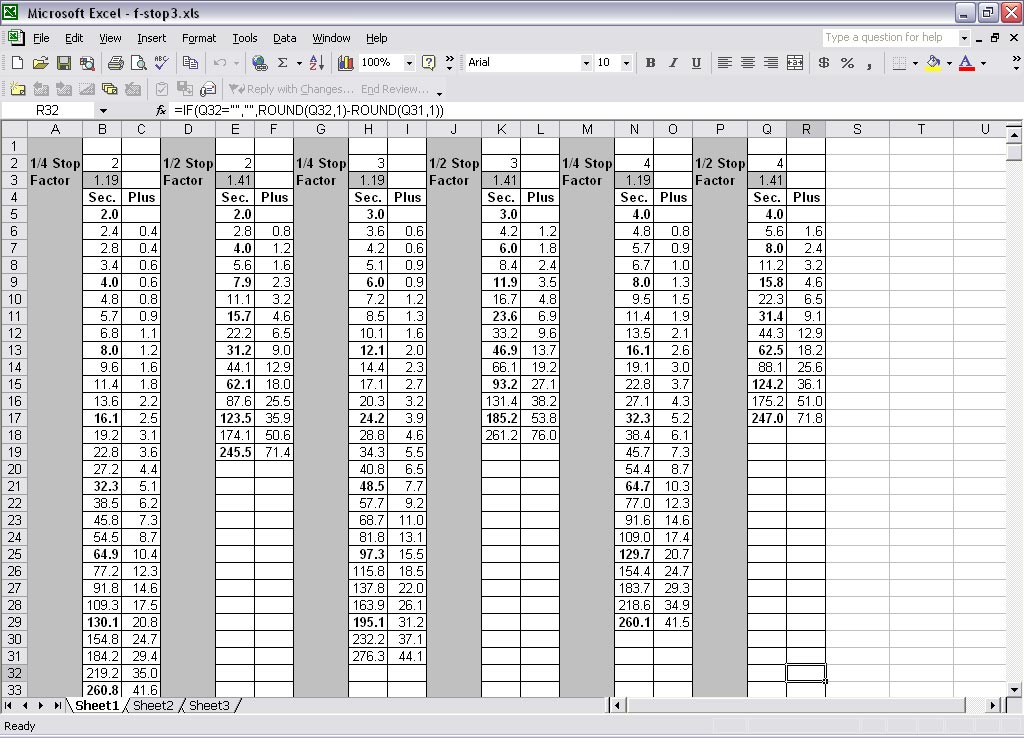

I have an Excel spread sheet that shows 2, 3 and 4 second base exposures extended in 1/4 and 1/2 stop steps to the last step short of 5 minutes, rounded to the nearest 1/10th second with an adjacent column that shows the increase in time between each step for use in making test strips. It's hard to describe and self-explanatory if you look at it.
Here's a screen shot. I'd be happy to send the .xls file to anyone that wants it.
