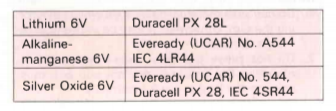

  12. AgX
    AgX Member
    Messages:
    18,483
    Joined:
    Apr 5, 2007
    Location:
    Germany
    Shooter:
    (taken from an original New F-1 manual)

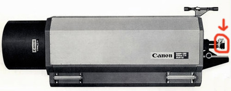

  23. EdoNork
    EdoNork Member
    Messages:
    71
    Joined:
    Mar 15, 2010
    Location:
    Bilbao
    Shooter:
    Don't ask for the 5200mm price.
    [​IMG]
