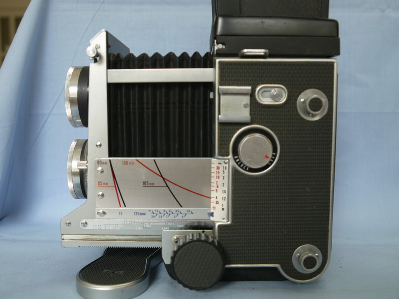

    The Mamiya TLRs have exposure comp scales because they have built in bellows. It's only when one cranks the bellows way out for close-up (macro) that the exposure compensation becomes a factor. Rolleis, Autocords, Yashicas, etc. do not focus that close, and so it is not a concern.

    Thanks everyone. I worked out the same math as best I could without the camera (I sent it off for CLA), and couldn't justify it either. Seeing the picture of the Mamiya above, I didn't realize it was capable of such close focusing (long draw). Makes sense now.

    Yeah, just about every other TLR I've seen focus the lenses using a linked helicoil which moves the internal lens elements, much like your standard SLR or rangefinder camera. The Mamiya TLR's use static lenses that don't focus internally, so you have to focus them by moving the lens board back and forth on a rack connected with bellows, much like on a large format camera. This is also the reason why the Mamiya TLR's are the only ones (that I know of) that have interchangeable lenses. So you gain the ability to switch lenses at the cost of weight, bulk, and bellows compensation worries.
