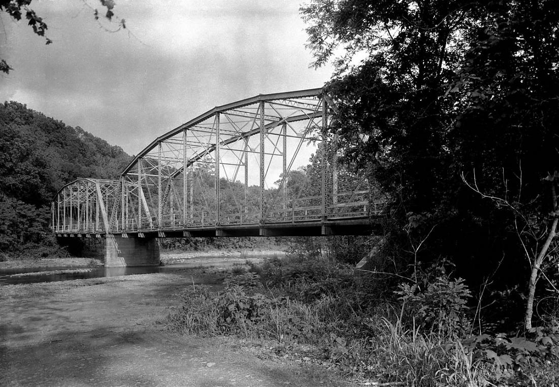

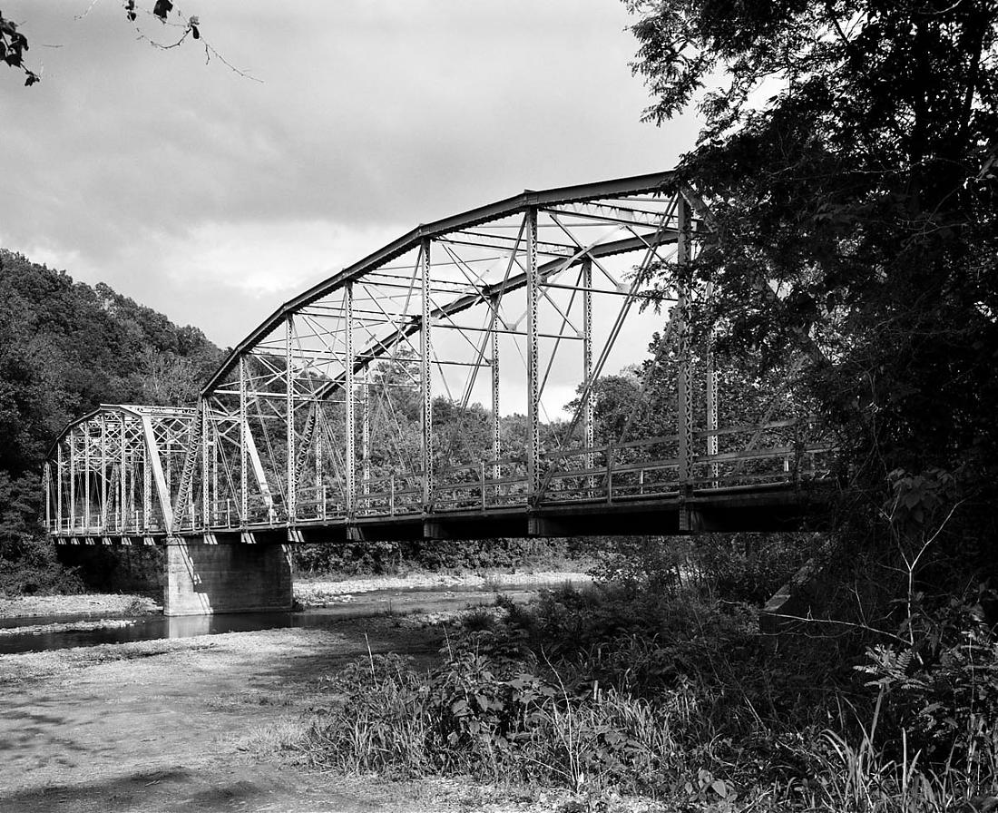

I have attached a couple of images.
W5 (The first image) is a view using Luminos Presspan in 5x7 size that expired in 1966. The film originally had an ISO of 200. I exposed it at an ISO of 6. There is quite a bit of age fog, which I compensated for by bumping up the contrast when I scanned the neg.
W2 (The second image) is a 4x5 shot using Arista.edu (Forte) 200 fresh stock. There was a bit of lens flare in this shot, again contrast adjusted in Photoshop when scanned for this example.
The old film has some mottling in the sky it seems. I am not yet using any added restrainer in the developer, which is HC-110b for both images.

Thank you for posting this. I've recently aquired some past date film, though not nearly as old as your sample posted here and have had pretty good success processing.
I've wondered how films dated really old such as your 66 sample could be processed and how they would be handled.
All things considered, its not only an interesting exercise what you've done, but also I think it looks great!

Definetely looks good. Those are excellent results considering the age and speed of the film.
It's a nice shot, too.

I enjoyed the comparison and agree that the shots themselves are very good. A bit surprised that the river below seems to be running so low already in May. Has it been dry there?
I can appeciate the PS "adjustments" per se. But wouldn't "unadjusted" scans be a better comparison as to the efficacy of using 40+ y.o. film? Espescially since you also adjusted the ISO at the time of exposure?

I adjusted the ISO because of testing and developing sheets prior to shooting this shot. It is a known fact that old film has diminished sensitivity and many people shoot fresh film at lower than rated ISO anyway. I did nothing in Photoshop that I wouldn't do on a print made in the darkroom. The goal was obtaining a usable image/print, not an example of the defects present in old film. Basically all I did was contrast (paper grade), dodging, burning, and spotting. I do all these corrections on the image made on fresh film also.

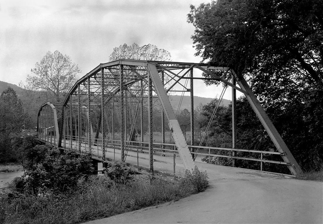

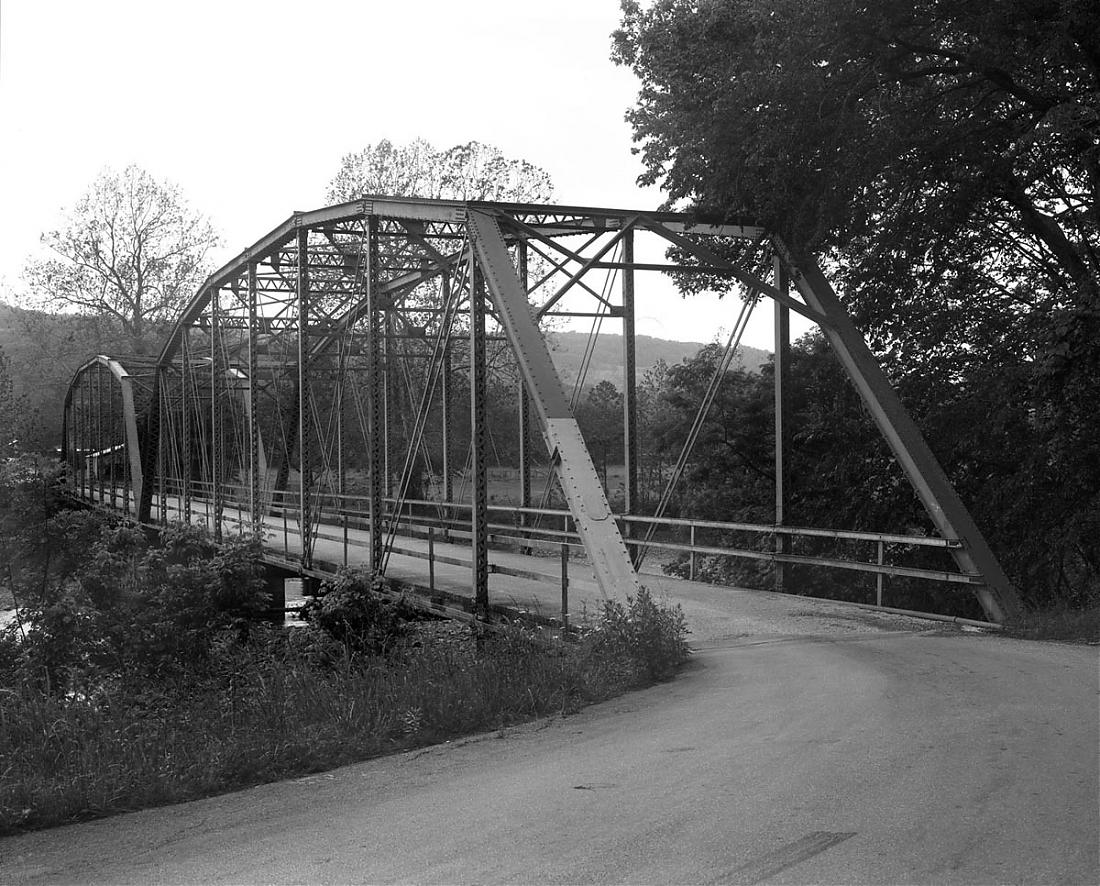

More comparison shots.
Here is another pair of images. Again, the first one was shot with old flm on 5x7 (expiry 1966), and the second one was shot with fresh film on 4x5. Lenses were selected to attempt to match field of view.
There were various flaws and defects on the old film 5x7 image. The image was very very flat, and this may be because of my attempt to control age fog by developing for a short time, therefore I had to reproduce the image with much more contrast dialed in. (I have no idea what the correct developing time would be for this Luminos Presspan ISO 200 film) There were also many more white specks and spots (on the positive reproduction) that I spotted out, just like I would do on a photopaper print. I also did some dodging and burning on both images to more accurately capture the vision I had of the view when I shot it.

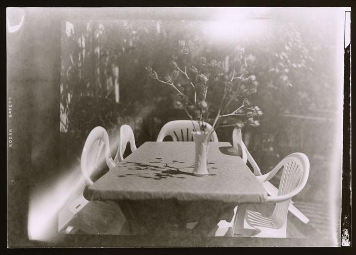

Picked up some old Super X in a film pack (I really just wanted the back for my 3.25 x 4.25 Speed Graphic) and decided to see what, if anything, would come out. The pack had a develop by date of April 1955. According to the person I got it from, it had not been cold stored. I rated it at around EI50 and developed in some old Rodinal (circa 1990) 1:25 for 5 minutes. I was quite amazed at how it came out, light leaks and all.
