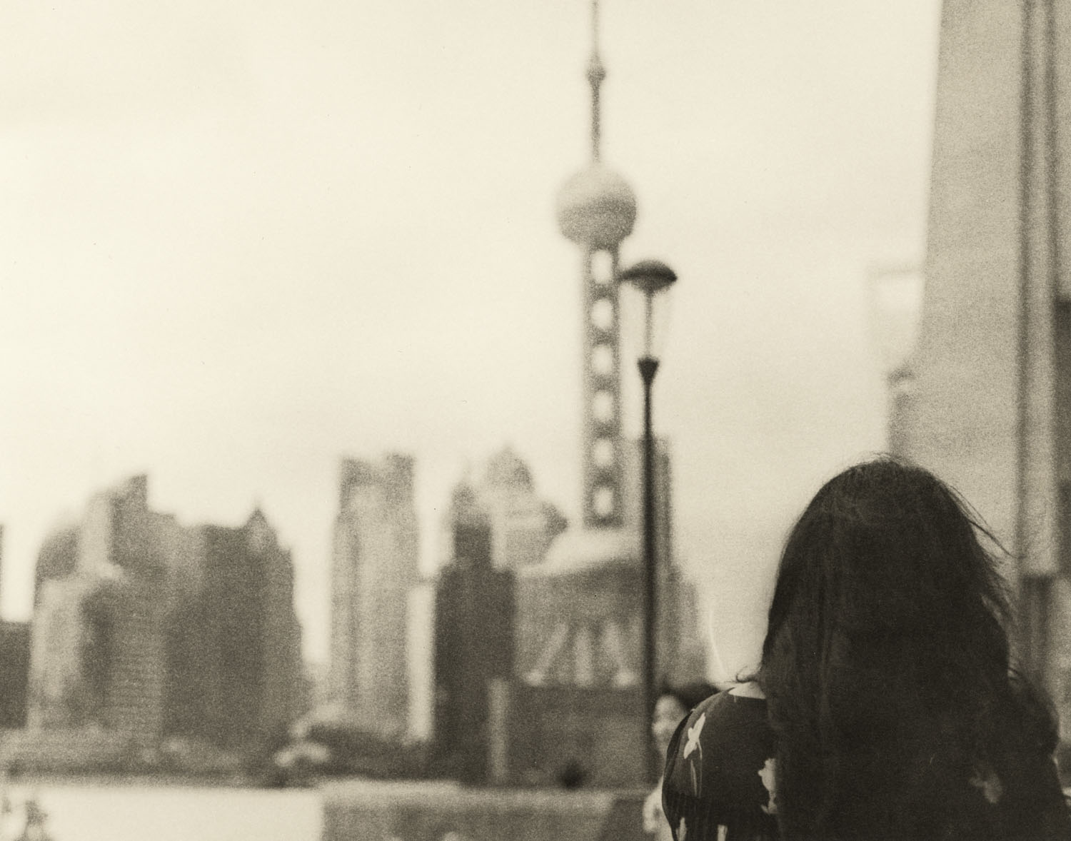

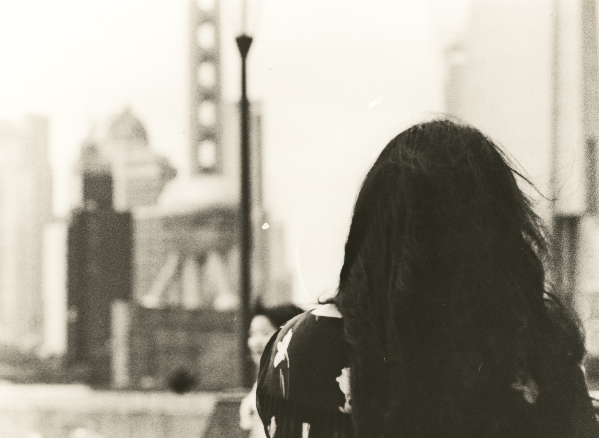

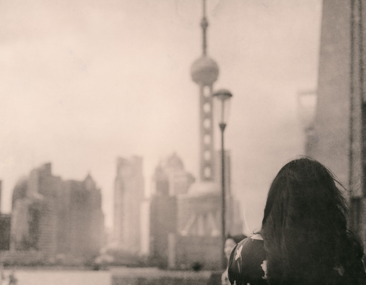

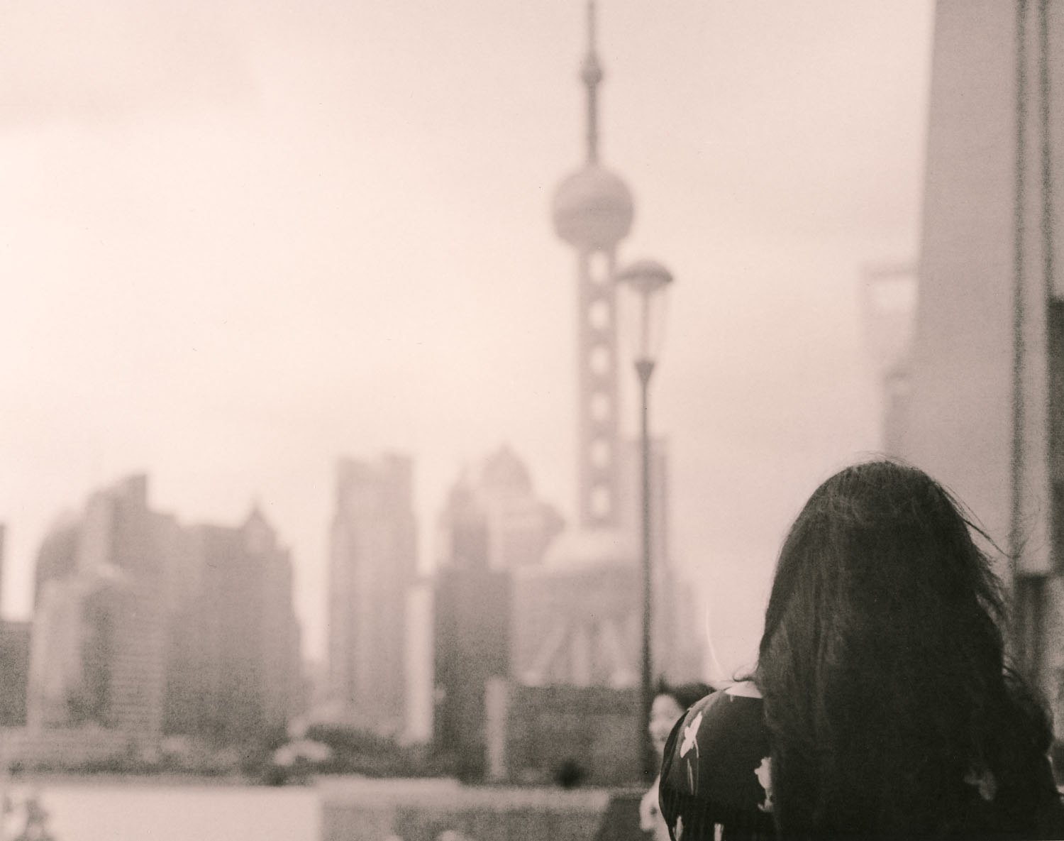

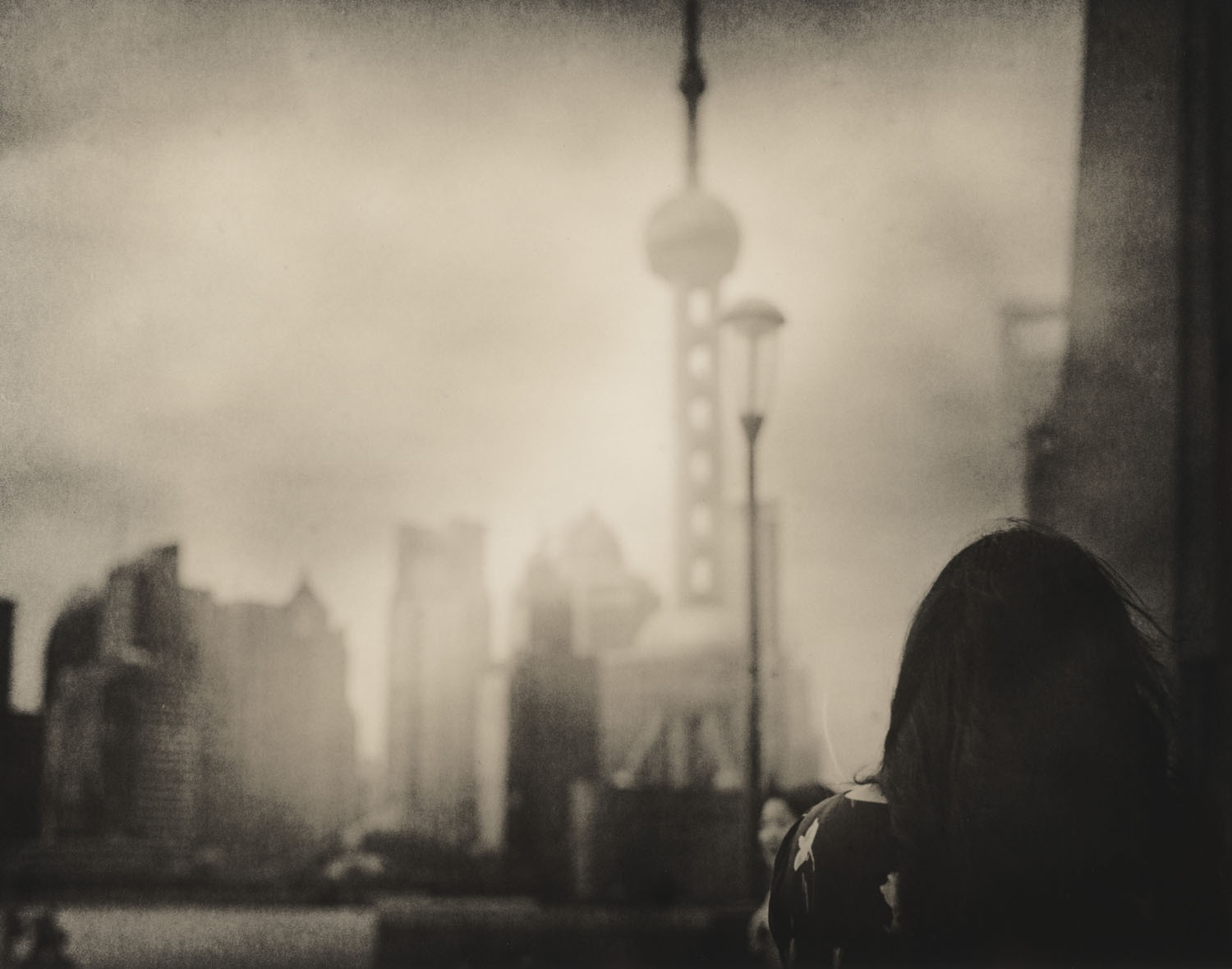

Paper Results
Finally, I’ll describe the results of the different papers tested. Some slight modifications to the formula were made as these tests were done, but nothing exactly groundbreaking. A portfolio of scans from this process is below if you just want to skip to see the results for yourself.
  • Ilford MGV RC — This is the paper was used primarily to guide this developer formula and so is the most well suited for this. This provides a full spectrum of colors going from golden to peach to olive to cool blacks. This paper is “difficult” in terms of uneven development, but easily possible with enough persistence in perfecting a good and random agitation technique. The development process can be a bit weird coming from traditional lith printing. At room temp, the initial blacks come up around 5 minutes., then the blacks seem to stall while the highlights and midtones fill in, about 8-12 minutes depending on exposure. Finally right as the midtones really start to look right the blacks take off and the highlight and midtone development seems to stall. Total snatch time typically from 15-25 minutes, can be sped up with heated developer. Note that the glossy finish can sometimes exhibit weird grainy line effects due to the way the glossy coating is put onto the paper. Pearl does not exhibit this effect. Color stays pretty much the same between dry and wet.
  • Ilford Cooltone RC — This paper is workable, but not exactly exciting. Blacks are more sluggish than MGV and overall will not develop to as dark. Color spectrum is from lilac to cool greys and blacks. Contrast is typically less intense than MGV. Color will become even more subtle when dry.
  • Ilford Cooltone FB — This behaves completely different from the RC version. Blacks are significantly more intense, and the color spectrum resembles that of MGV (peach, olive, cool black), but a bit more subtle and with overall more interesting shadow gradation.
  • Kodabrome II F3 — This is a lith printable paper that I often use with normal lith printing. It does work here, but is definitely not anything exciting. Normally the color spectrum is peach highlights and cool shadows. However, in this developer it doesn’t produce great blacks and the color spectrum changes to lilac highlights, somewhat golden midtones, and somewhat cool shadows. It also is normally a fairly fine grain paper, but in this process becomes rather grainy. Color will become somewhat more subtle and golden when dry
  • Adox MC112 FB — This paper was the first failure in this. I believe more benzotriazole could potentially solve it, but haven’t had time to test it. With this highlights and midtones will develop only somewhat slower than the blacks. The blacks will also spread across the image from the edges, making it very difficult to get good shadow gradation. Color spectrum was yellow to mostly neutral and cool. The results here are quite striking, but not something I’d say can be used for all or even most subjects because of how unevenly it develops.
  • Fomatone 133 FB — This paper gave rather striking results. This test isn’t exactly reliable. The developer was nearly dead because a kid’s nosebleed interrupted a session forcing me to leave the developer after 1 print for 30 minutes. It developed a lot slower, but gave great results when it finally got to where I wanted. Blacks were somewhat cool and not greatly intense, but the shadows were a beautiful deep brown, and with peach highlights and sepia-ish midtones. In normal lith printing I’ve only gotten peach and olive colors, as well as having weird problems with blacks “spreading” from the edges and darkening highlights. In this process the paper worked perfectly though similar to MGV.
Results
Note that all tests here were scanned and then carefully color corrected to best match the appearance of the print in daylight conditions.
(see attachments)
Conclusion
This developer should prove to be a very promising and useful tool available to expert lith developers. The glycin requirement of the developer is really the most difficult part, as it is only available from one manufacturer, keeps poorly as a powder, and does not mix very easily into TEA. Otherwise all chemicals used are stable and often stocked by people capable of mixing their own developers. I intend to eventually test using metol instead of glycin, but do not expect much success since metol is a much more active developing agent and doesn’t have glycin’s reputation for “glowing” highlights and midtone separation. This developer and minor modifications to it will continue to be used for my personal lith printing with occasional updates on especially nice prints made in it… but for now, this idea is “complete” and requires no further discussion. I’d definitely appreciate any reports of other people trying this process out, especially with papers not listed here or even old expired papers I don’t have easy access to. I’ll do a “guest” post featuring other people’s images (with permission) of this process if I can collect some examples of it being used outside of myself. I’m also interested in a way of using the HQ-TEA and Glycin-TEA mixtures in other developer formulas beyond lith printing. I also do plan on trying some other lith printing formula ideas, but for now this satisfies me. I will put up some more experiment reports later on with the result of this developer with various papers and various toning techniques.

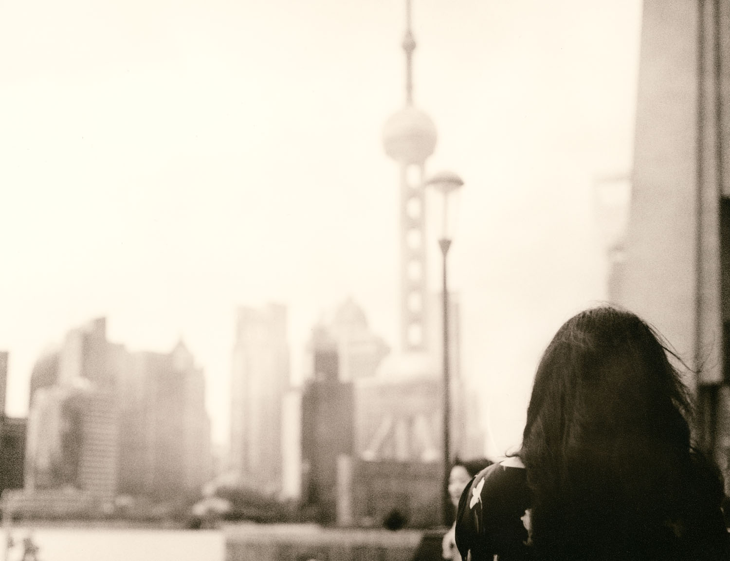

Yet another update on EXB developer series. It's pretty long, so I'll just summarize it here and give the pictures. Full report at https://grainy.vision/blog/magic-lith-prototype-update-5-exb-developer-series
Basically I've figured out a great neutral color /cooltone lith developer with the following interesting properties:
* Extremely deep blacks, full range of contrast adjustment techniques with very good separation between highlights, midtones and shadows
* Not overly sensitive to sulfite (it'll slow down infectious development a little bit, but does not affect depth of blacks)
* Fairly long tray life both in terms of time and number of prints that can be processed (>1.5 hours and >10 8x10 prints)
* Very consistent across many prints if pH adjustments are made (need to do research on making a decent 12 pH buffer to cure the pH problems)
* Some but not a great sensitivity to additional bromide, thus the consistency across prints
* Neutral or cooltone color spectrum depending on paper, ideal as a "blank slate" for toning
* Edit: also, it works on "difficult" papers. Tests include Ilford MGV RC and Warmtone RC. I expect due to the unique mechanism by which infectious development is activated (ie, by the oxidation of phenidone rather than hydroquinone itself) that this developer will give good results with any paper, as long as a high amount of iodide doesn't damage the emulsion anyway.
The TL;DR; of the formula is an almost homeopathic amount of phenidone (0.2ml of 1%), a high amount of sulfite, a high pH, almost insane amount of iodide, and some antifoggant. You can see the results attached (note the overly yellow print is actually stained due to not fixing long enough. This requires double or triple the normal amount of fixing time in TF-4).. EXB4 used 0.2ml of phenidone 1%, while EXB5 used only 0.1ml, both formulas being extremely similar otherwise. Note these are 5x7 prints, so more paper grain visible than previous images using 8x10 sizes
