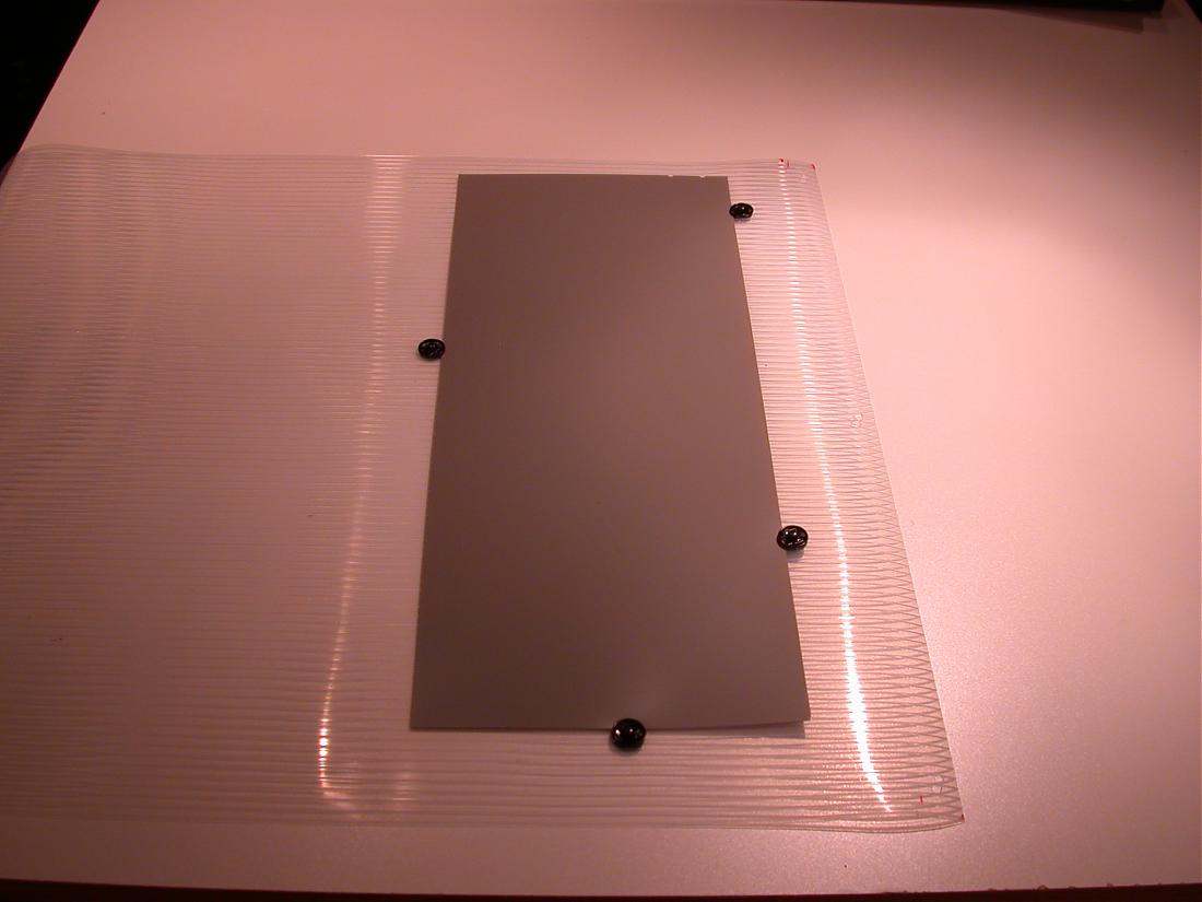

Today I constructed an insert for the Jobo 3063 drum to hold 7x17 film and it seems to work well. I found a plastic shelf liner material at the Container Store in Denver: "Plast-O-Mat Ribbed Shelf Liner." It is smooth on one side and has ribs on the other -- about 3/16 inch apart. The material is 24 inches wide, more than enough to fit the 3063 drum. The ribs allow the solutions to flow behind the film.
I then attached "sew on snaps" that I got from a sewing store at the critical points to hold the 7x17 film in place. I didn't sew them in, but drilled a hole through the shelf liner, and snapped one side to the other. I used four snaps for each piece of film: two on one side, one on the other, and one at the back as a stop.

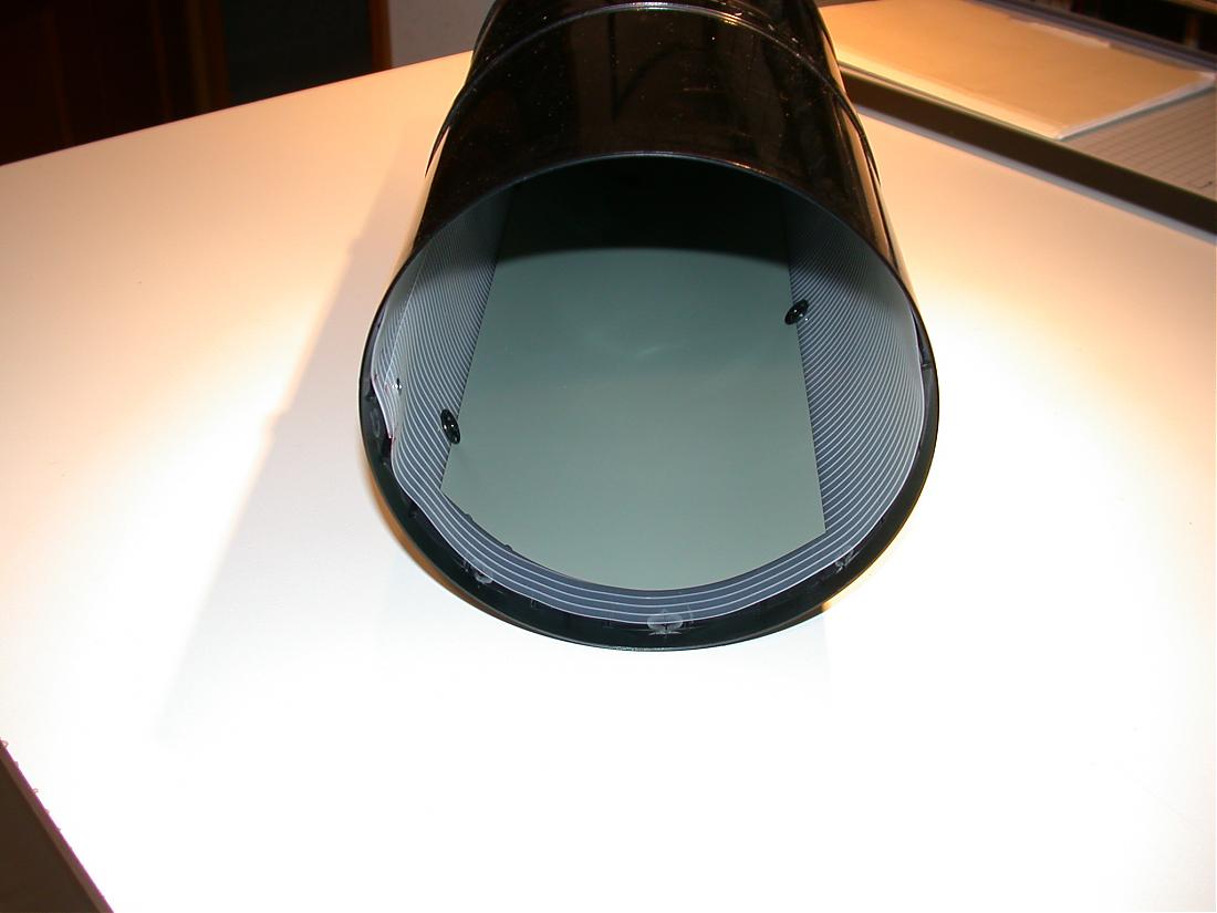

Finally, I attached each end of the shelf liner to itself with a one inch overlap using pop rivets to hold the assembly around the Jobo drum's inner circumference.
I tested the works by developing a extra exposure I made this morning. The film held in place throughout the process and the development seems to be even and satisfactory . I haven't printed the negative, and used an untested, sore thumb development time, so more work is in order, but it's encouraging.
