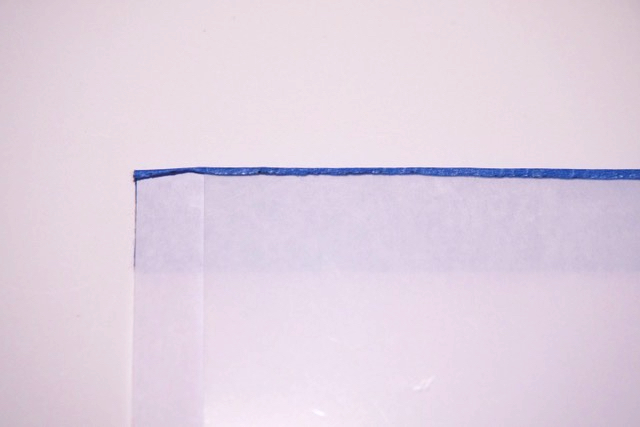

Don't know if this will help. It's the first idea I came up with and hasn't let me down...yet. Then again, I haven't been printing digital negatives for very long!
Used masking tape on the top & bottom (backside) of a piece of regular letter writing paper, making sure about 1/8 of an inch extended over the edge.
The digital negative film gets placed over the front of the paper (both are the same size) and the masking tape gets rolled over so that it holds the film in place.
In the photo I offset the film material so it would be easier to see.
I feed the usual way, from the back/top feed tray.
