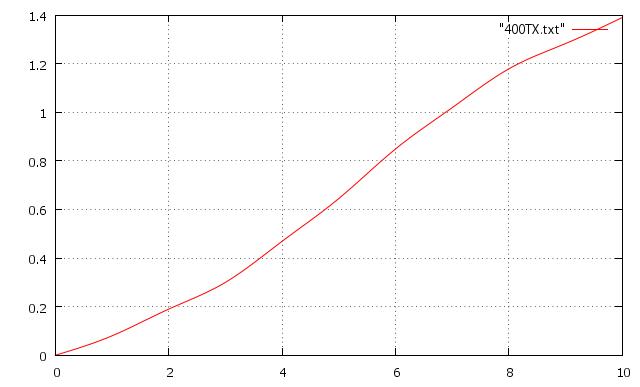

Ok, I tried the simplest thing I could do. I took an OPT101P, which is IR sensitive, and has its own op amp. I used 5V form a 7805 regulator and put the breadboard with the IC directly under the lens of my condenser enlarger. I have some developed film with shots of a gray card, from -5 stops underexposure to +5 stops overexposure. I used a very basic digital multimeter and took notes of the voltages produced by the OPT101. After few calculations I had the densities and I used gnuplot to get a graph of the characteristic curve, using natural cubic splines. Here's the result and it looks reasonable, doesn't it?
attachment.php
BetterSense
Aug 16, 2008
3,151
North Caroli
Yes it certainly looks reasonable. I bet you would not get a reasonable result using color film. With my IR goggles, processed B&W film looks perfectly normal, but color film looks utterly transparent.
