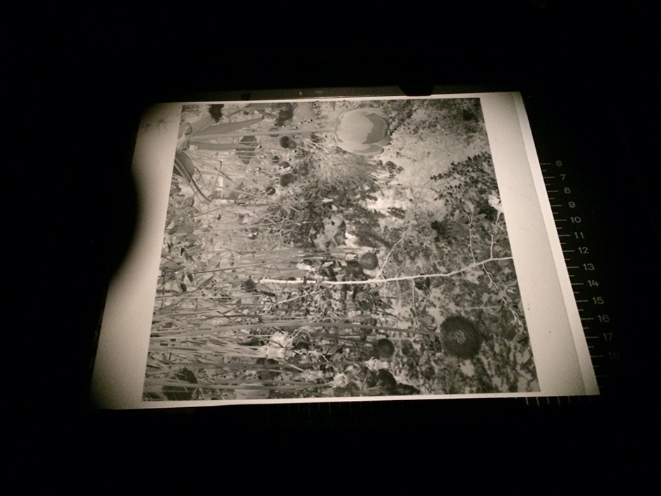

I checked and it only vignettes in the corners slightly. Not ideal though. Also, you're bringing down the enlarger very much for that format, which doesn't make burning and dodging any easier.

I forgot to attach 2 pictures I took, showing the vignetting and the IIc's lowered position to do plus minus your small size . . .

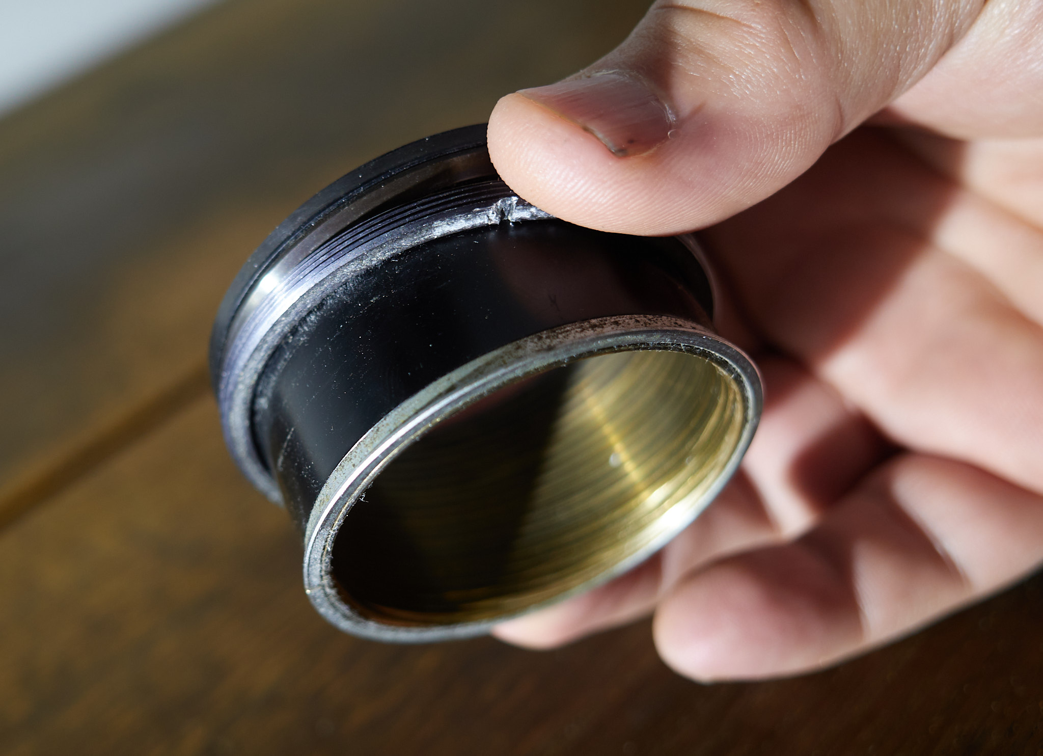

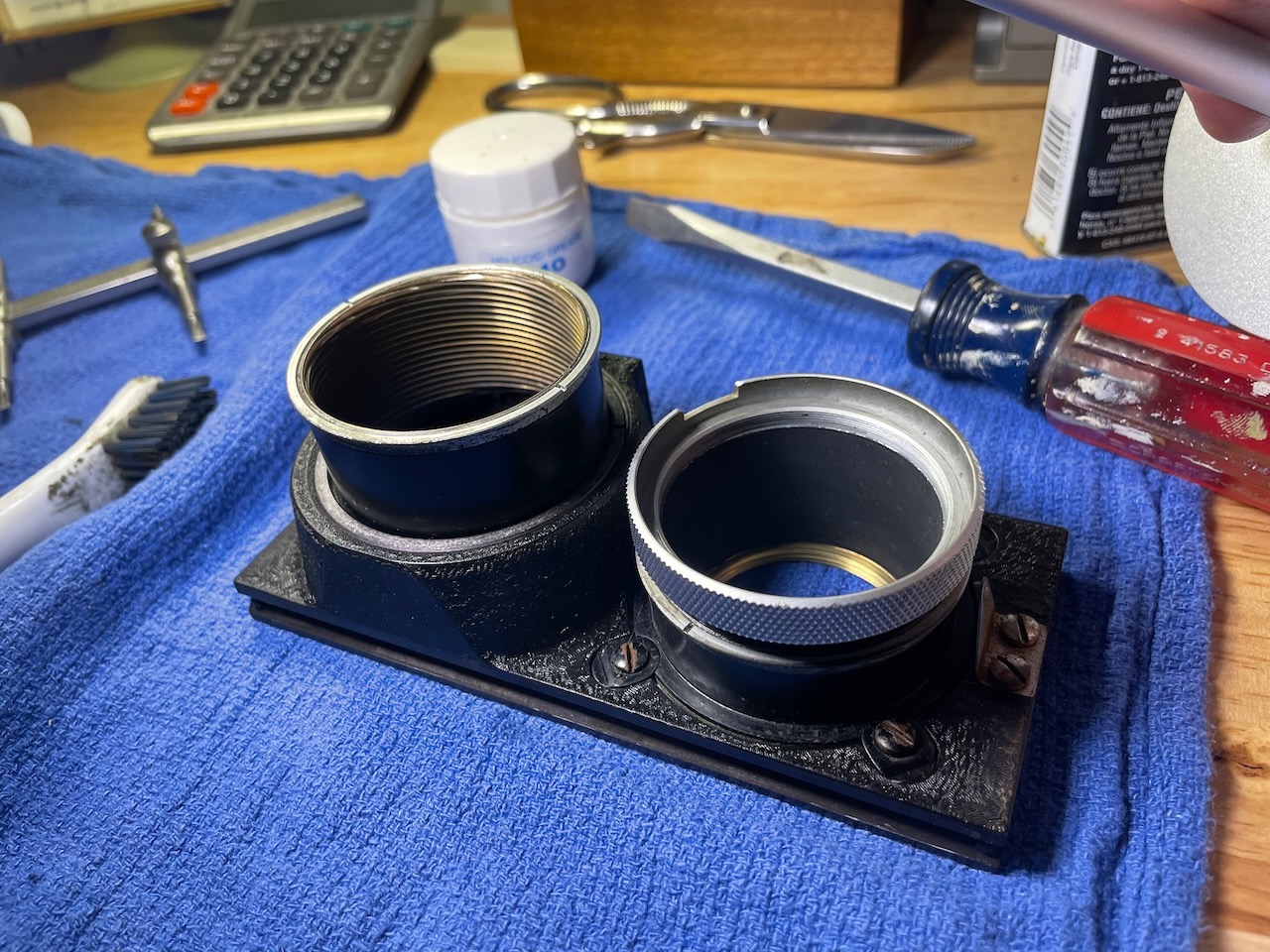

No luck getting the helicoid screwed into the turret. At least they're clean and lubed now, though :smile:
I got cocky and decided to try removing the turret so I could get a better look and angle. I got it off, and after spending half-hour picking up the surprise shower of bearings that rolled all over the darkroom, I was able to get a decent look at it. I suspect the threads are actually damaged. You can kind of see this in the photo here. I have 3 helicoids and none of them even come close to "catching" the threads.
I'll see about replacing either the receptacle or the entire turret assembly. And if I can find one, I'll see if I can figure out how to get all the bearings back where they belong. I may have bitten off more than I can chew here, though.
