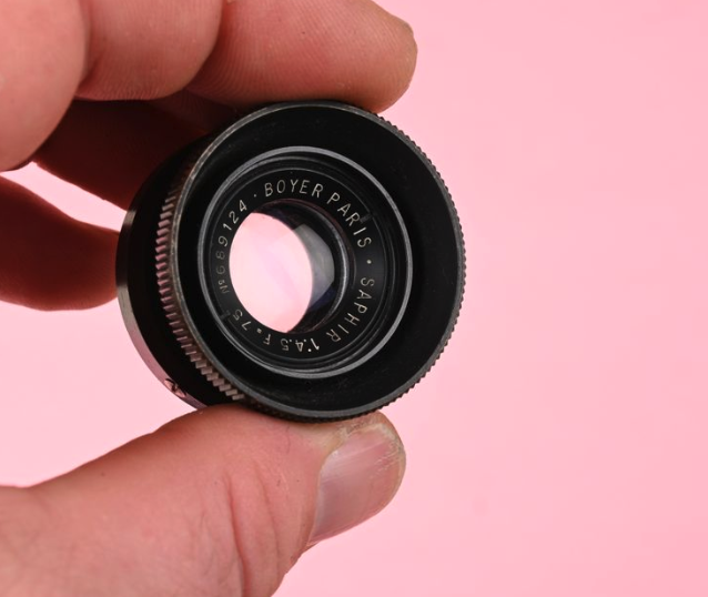

I have a Durst M805 b/w enlarger, and I will begin making prints for my 6x4.5 film.
Reading the Durst manual, it recommends a lens focal length between 75-80mm for this size film.
I'm just curious, if anyone knows more about Boyer lenses (now defunct company which manufactured in Paris).
I am looking at a listing where the seller has offered me 50 euros for a Boyer Saphir f4.5, 75mm (apparently in perfect condition).
Do you think this would be a good deal, or do you think the price is higher for the novelty rather than the quality (i.e. I can find rodenstocks at 75mm for cheaper) ?

the price is higher than others I can find (like the Rodenstocks) because it is rarer rather than necessarily better quality ?
Yes.
According to:
https://www.galerie-photo.com/boyer-optique-objectif.html (scroll approx 2/3 down)
this would be a 4-element, Tessar-like lens.
