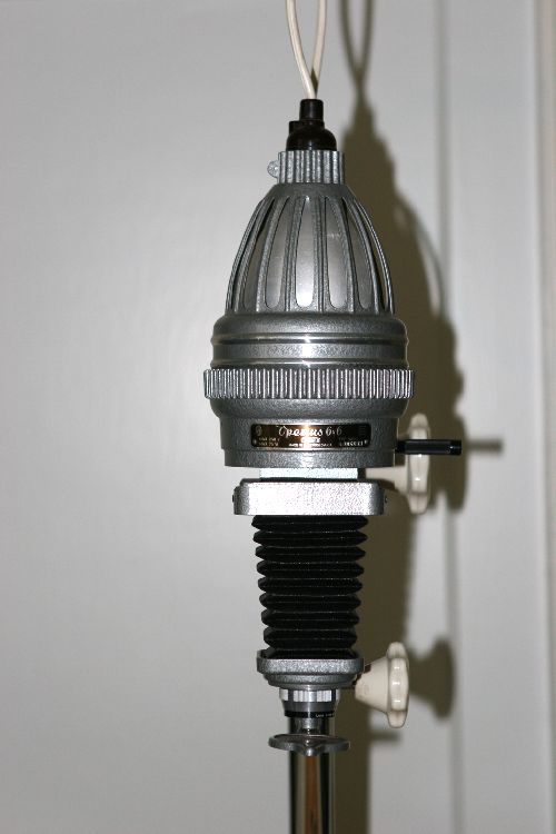

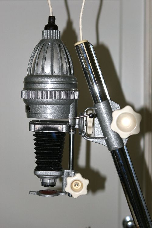

The other day I submitted a question regarding the Opemus 6X6 enlarger I purchased. Today I am attaching photos to see if this helps anyone provide insight or info. Will this negative carrier fit my enlarger? I am ordering a manual and hope this helps too... Thanks again and have a great weekend.

Hi Johnny,
I have Opemus 5 enlarger and exactly the same looking negative carrier that I see on your picture. My enlarger does not look the same though. You can try this. I just measured the opening for the carrier on my enlarger, if yours is the same, I think it should fit. What do you think?
Here are my dimensions: the height of the opening is 0.75 inch (2cm)
The width and depth is the same (it’s square) 5.25 inch (13.2cm)
I hope it helps.
