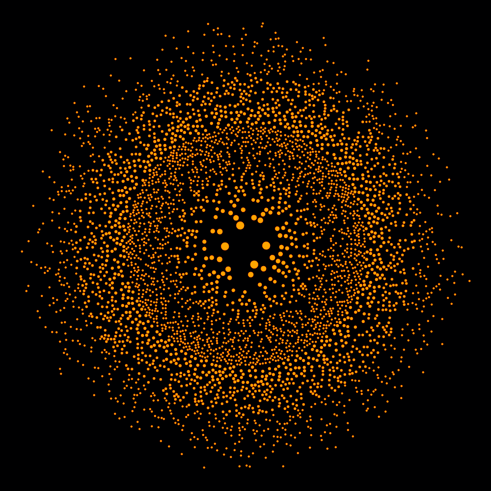

    [​IMG]
    How can I engineer this pin sieve lens for 66 and 1000 mm ?
    Umut

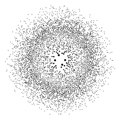

    What do you mean with engineer? Are you asking how to make it?
    Easy. Create a negative image of it (see attached), print it black-and-white at 50x scale, and then photograph it on high-contrast film at a distance of 50x the focal length. Use the piece of film as your photo-sieve lens.

    Random Discrete Fresnel Zone Plate is the above lenses name.
    Ralph , I know how to photograph something but I am sure above lens is not engineered for my purpose.
    I am asking the formulas for design similar plate for my work.
    Umut

    I am lost, as in this thread random and regular pinsieves are mixed up.
    And to my understanding the random one is only appropiate to X-ray imaging.

    Random one is for decrease the higher order aberrations. There is no limit at the formulas to keep it for x ray. You enter the wavelenght and it gives the pin sieve.
    Ordinary zone plates are the subject for x ray imaging but ordinary cameras uses them also.
    I think x ray technology comes from the x ray lab at germany and their problem was not making ordinary camera lenses.
