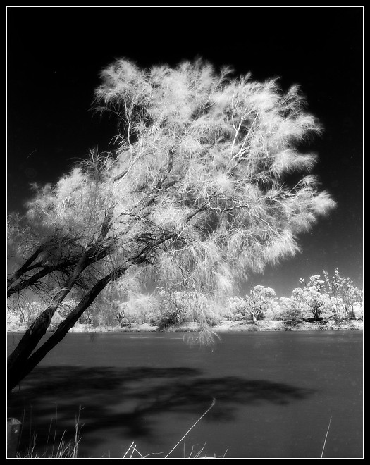

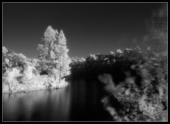

I have a problem with the last few rolls of IR820 in 120 I've used - they have these blotches on them that look like overdevelopment. Or fungus, or something, I don't know.
For example, some 6x7 frames:
This is the only film I develop in stock D-76 and wonder if there's maybe a problem with my mixture that goes away when I dilute to 1+1 for all the other films.
Any ideas what might be causing these splotches? Is it my development or a known film fault? I really like shooting IR but this ruins the shots.
Alternatively, does anyone have suggestions for a time in D-76 1+1?

Looks like air bubbles. How did you agitate the tank?

But these are overdevelopment (dense patches on the negs) not underdevelopment. Agitation is the same I use for other films: 70s of inversions at start then 10s of inversions per minute. One inversion per second. Tank gets rapped on the sink and I use a few drops of photoflo in the developer to prevent bubbles (there was a url link here which no longer exists).

In that case, I have a question.
What exactly did you do after development? Did you use a stop bath? Was there a delay between developer and stop bath?

..cant see the defects in your posted images, but from what you describe, this is damaged film. We have found that such damage is caused by a few factors; age. moisture in refrigeration - before or after exposure.
There is a strange defect with the 120 & large-format efke films caused by the paper. We believe it to be moisture related. It is caused by improper handling or storage of the film.

dr5: have a look at the lower part of the sky, there are little pale mouldy-looking things.
Water/mould does sound interesting - I keep mine in the refrigerator but it's still in the little plastic foil sleeves, which (I presume) are sealed. I haven't had this problem with 135, which is in a very well-sealed little canister. I'll post again when I find out how it goes in Rodinal.

I finally did the Rodinal (1+50, 11:00, 20C) test, and have a roll of IR820 sitting here with no marks on it other than a cat hair and a drip line. So I guess the conclusion is that the D76 was the problem, perhaps something in it was not quite dissolved at the stock concentration (we have kind of hard water) that goes into solution at 1+1.
The only drawback is that it is so very very grainy. Very tight grain (high spatial frequency), but it has a huge amplitude. Stock D-76 was taming that very very well.
Edit: can anyone tell me what a suitable time would be with D-76 1+1?
