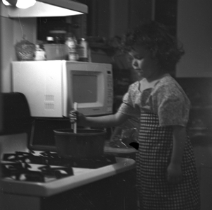

Here is the one that is 4 stops underexposed.

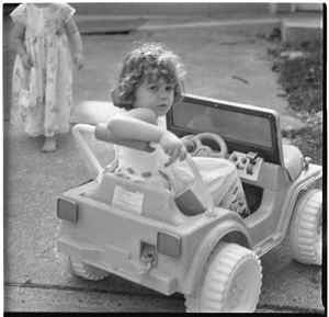

Finally here is an example of one that is really grainy. Thanks for your patience with my uploading learning curve.

These two might show it better. The one of caitlin in the cart corral has been worked over in PS for contrast d & b etc, just not spotted. Please forgive the PS part, the only raw scan I have of this is in my apug gallery. I think that working the image in PS makes the grain thing worse. Although other images shot on other film worked in PS does not have this problem.
I am not trying to make this about PS at all, so please forgive the references.

The one of her in the kitchen was the one underexposed by 4 stops that did not exhibit grain. On the others it is in the midtones more than anywhere else.

BTW, that is a great portrait. Thanks for the help. Maybe I need to underexpose more than I am doing.
