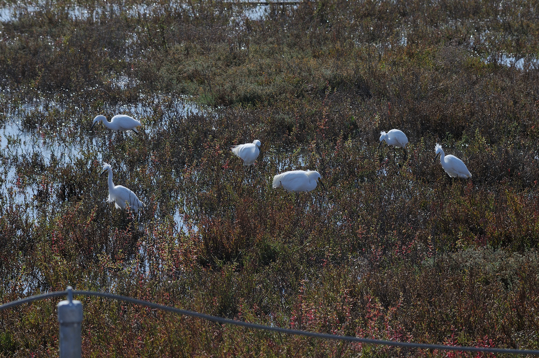

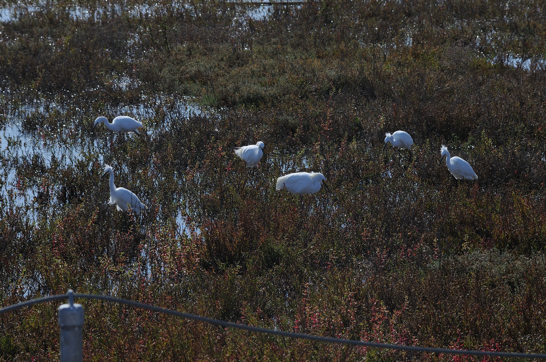

Today I shot some Snowy Egrets on Bair Island with a Nikon D300, 35-135 f3.5-f4.5 AF zoom and Nikon TC 201 2x teleconverter at times. Previous attempts left the bird's feathers burned out in bright sun. Today I shot at -2 stops exposure compensation. The birds look good but the surrounding do not look natural.
Images were saved in camera RAW, converted to Tiff 16 bit in Capture NX-D then converted to jpeg in CS5.1.
Adjustments are Levels, highlight to edge of line, about 240, midtone about 1.02 or 98 as I don't remember; Exposure midtone eyedropper on the brush, shadow eyedropper on a shadow resulting in a +1.02 on exposure, -08 on offset, gamma at 1.
How would you handle this in PS?

Hi Shutterfinger,
I downloaded your pic and worked on it in Photoshop CS6. When I open any file in Photoshop, the first thing I usually do is to add a Hue/Saturation layer. I then slide the Saturation slider all the way to the left, so it now shows as a B&W image on the screen. Next, I add a Exposure layer and increase or decrease the exposure, being careful not to blow the highlights out. Then, I'll add a Levels layer and move the sliders around until I feel the image looks good in B&W. At this point, I uncheck the box for the Hue/Saturation layer so I can see the image in color. The color saturation can change radically when the Hue/Saturation is deselected, so I will re-check the box and readjust the Saturation slider until the color saturation looks good to me. If you send me your email in a private message, I can send you back a Photoshop .psd file of your picture, so you can see just what I did.

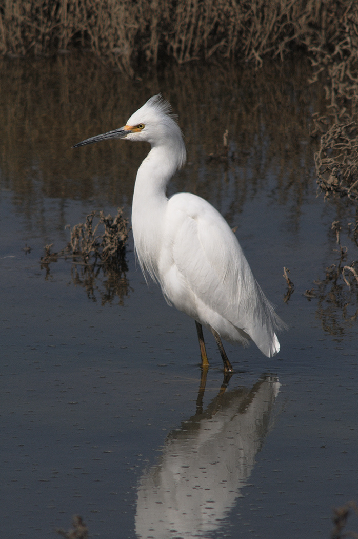

Today I went out to Bair Island with the D300, 300mm f4.5 AIS, TC201, Bogen monopod and made 93 shots. Of the 93, 25 are usable, no camera shake or poor framing. While editing the 25 I switched to Layers, Adjustment layer, Curves, adjusted the highlight end then the spike in the shadows end which was the water. Definitely less complicated to get good results.
