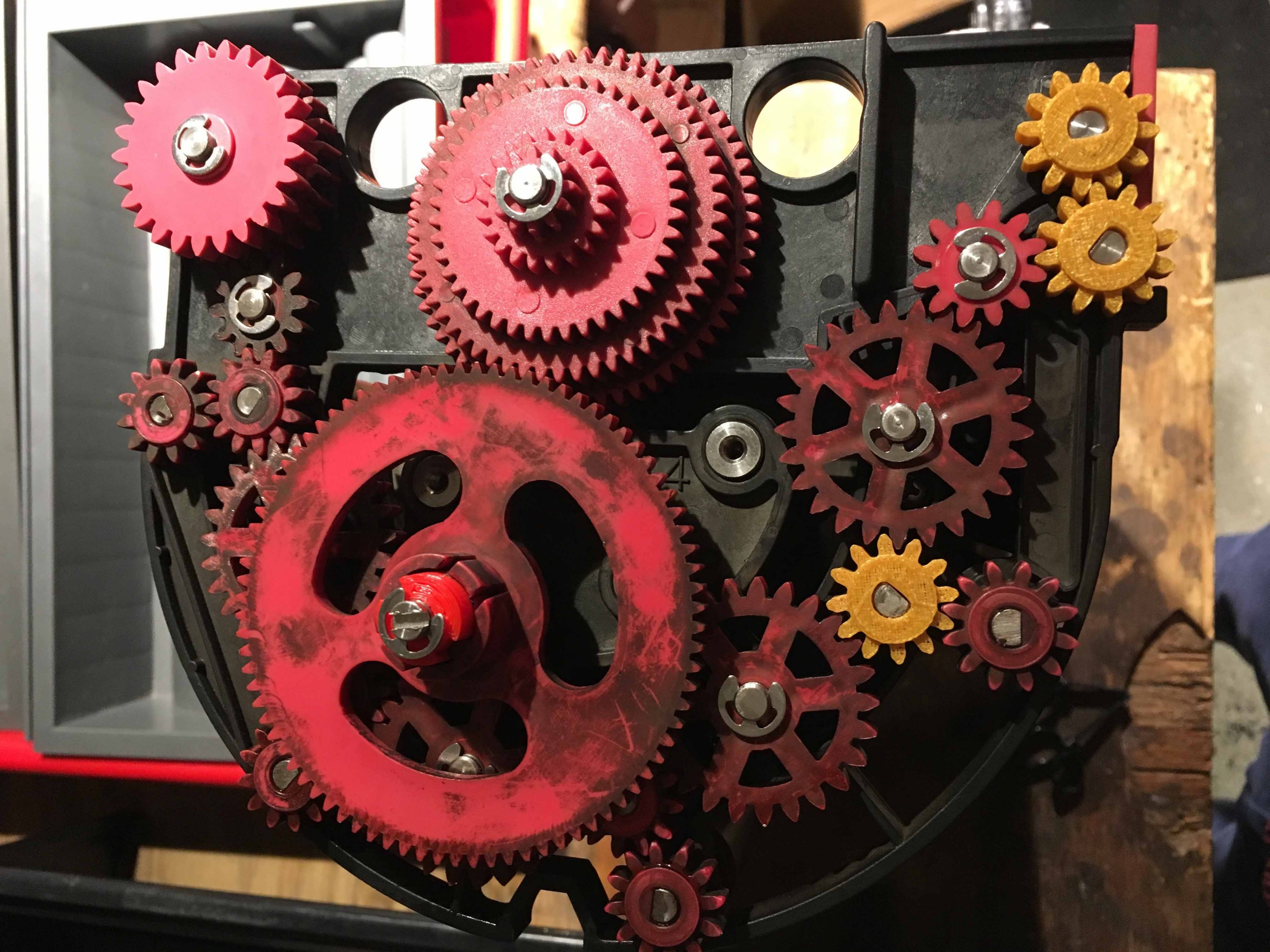

Hi!
I rebuilt this processor I got off ebay. I think this is the only corner of the internet that might now know these things are, maybe its helpful to someone :smile:
Oh and if anyone wants the file to print there own lemme know.
Here's a imgur album:
https://imgur.com/gallery/upGmW4b
p.s. I'm now just reading this BIG RED WARNING before I post about this is being an analog workflow area...sorry for the computer screenshots? I can take this down if its in the wrong spot.

I have! I was printing last night with is! I'm sorry for not figuring out how to post the gallery in your forum.
I made an imgur album link with details on each step to share it with reddit but then I realized they don't have a good sub for posting this. So its kinda cross posted here :smile:

Oh if I had your talent for design and 3D printing. Great job!

What material did you make the gears from? I would have used POM (Acetal) from the mechanical point of view. But I have not yet investigated in the chemical resistance.

What size prints can those make?
Actually the intro is 310mm wide so theoretically you can run 310mm wide paper as long as you like.
In practice though, one has to carefully align the paper up so it goes through straight. With 305mm wide by 406mm long paper (12"x16") it is easy peasy as you curl it up in the intro unit, then feed it emulsion down into the feed rollers. Close the lid and with a two bath set-up you have done either RA4 or B&W paper in approximately 90 seconds. Let the paper fall into a tray full of water, then place the paper into a wash tray and you are in business.
The exit rollers are a squeegee type and minimise the amount of carry over from bath to bath.
I've had mine for over 20 years, bought it new for doing wedding prints, paid for itself over and over in just a couple of years.
Mick.

Would love the 3d files... just resurrected my printo and will be trying to get it all working again...
Were there any other problems than the cogs.
I'm a bit worried about the rollers sticking together...

Really cool! Would you mind sharing the model file? I own a Printo with the same broken gears and I have a 3D printer too! What material did you use to print these?
