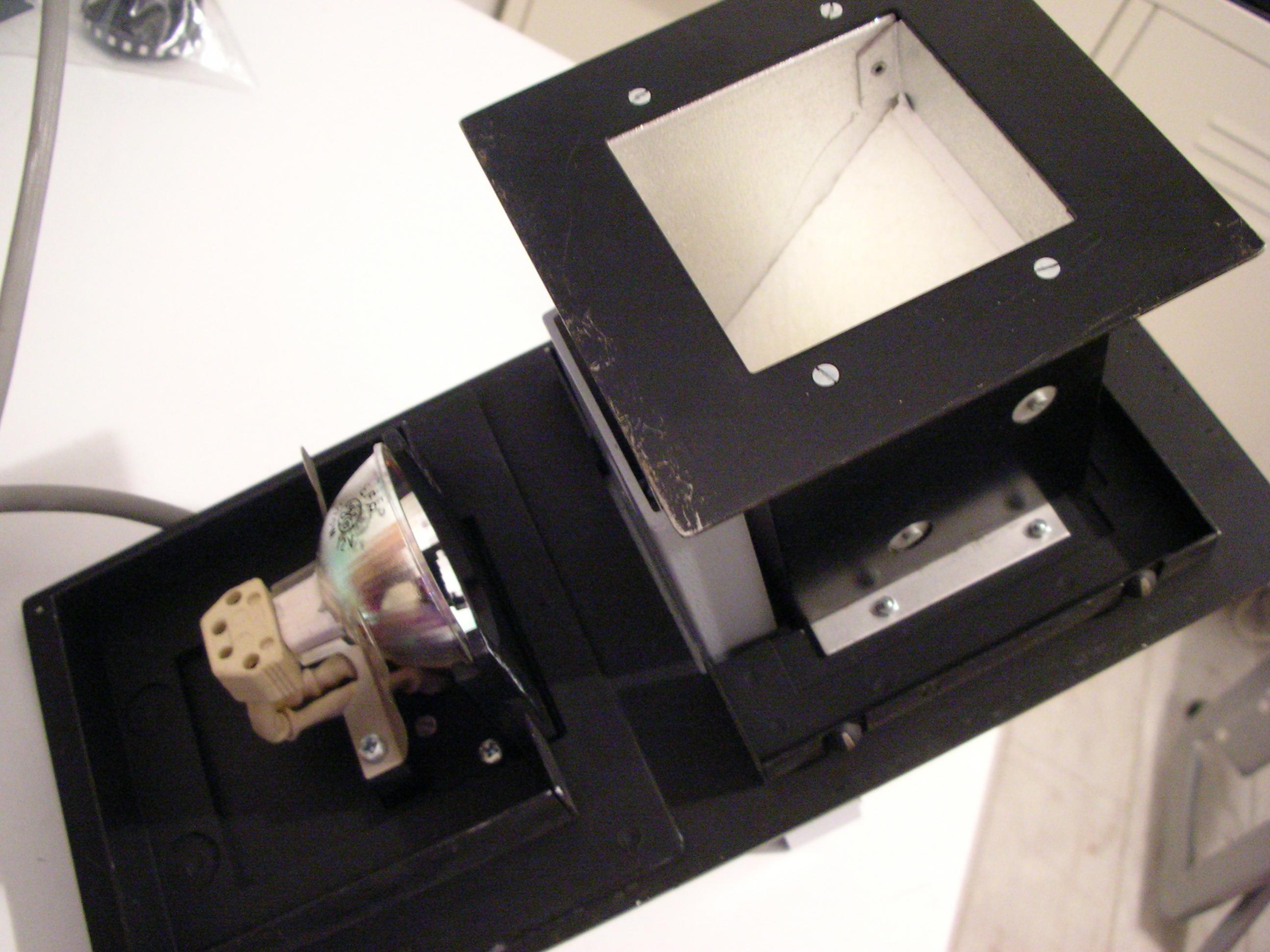

Second question obvioulsy related to the first one, in the CLS 70, where the light is directed downwards on the 45 degree plate, it´s just a styrofoam (right word?) surface. Is that correct? I thought is was suppose to be some sort of very fine diffusion plate.

It would be better if you posted pictures of your unit. Usually color mixing boxes are lined with styrofoam like this one. Which Setiobox do you have?

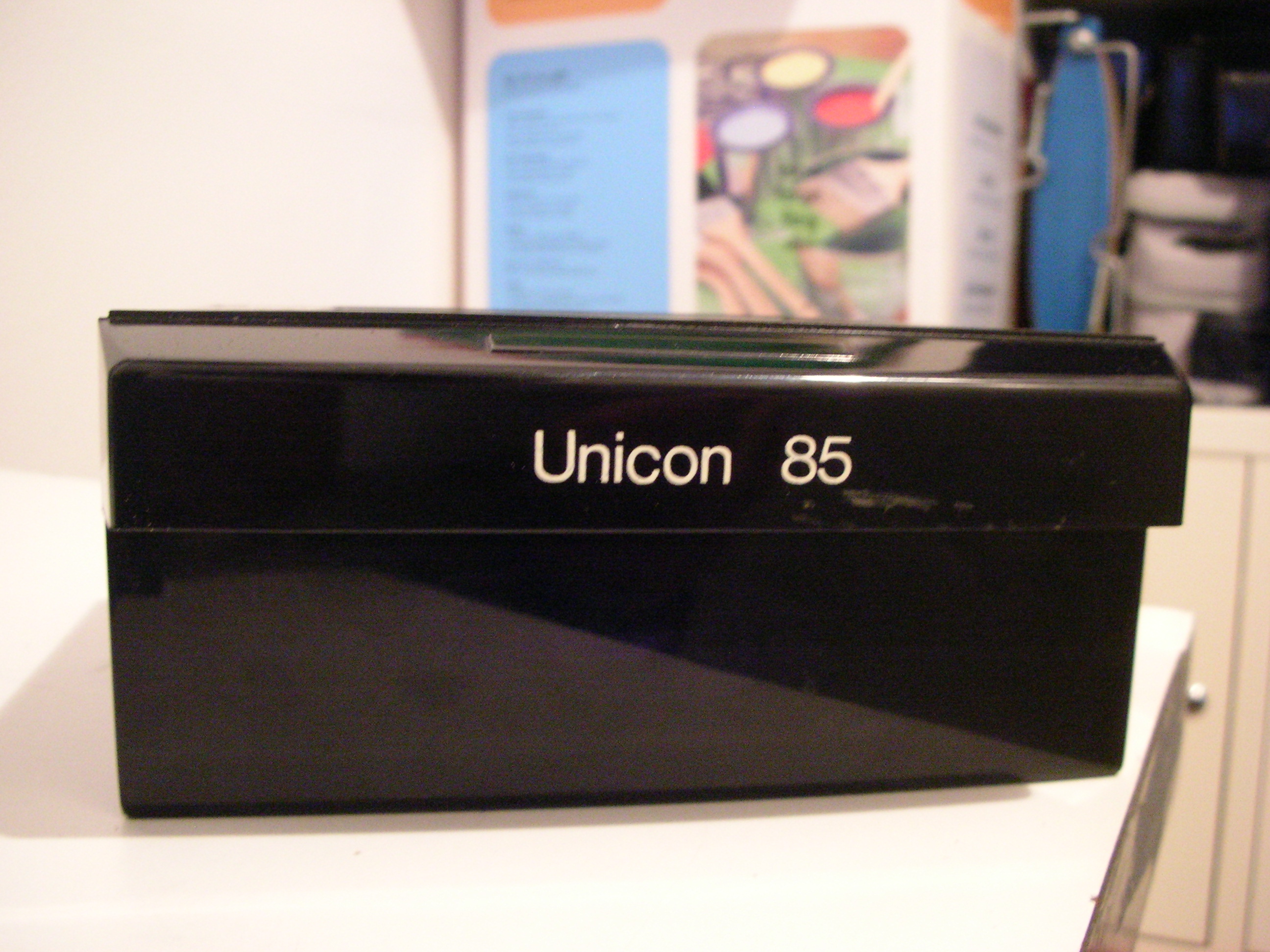

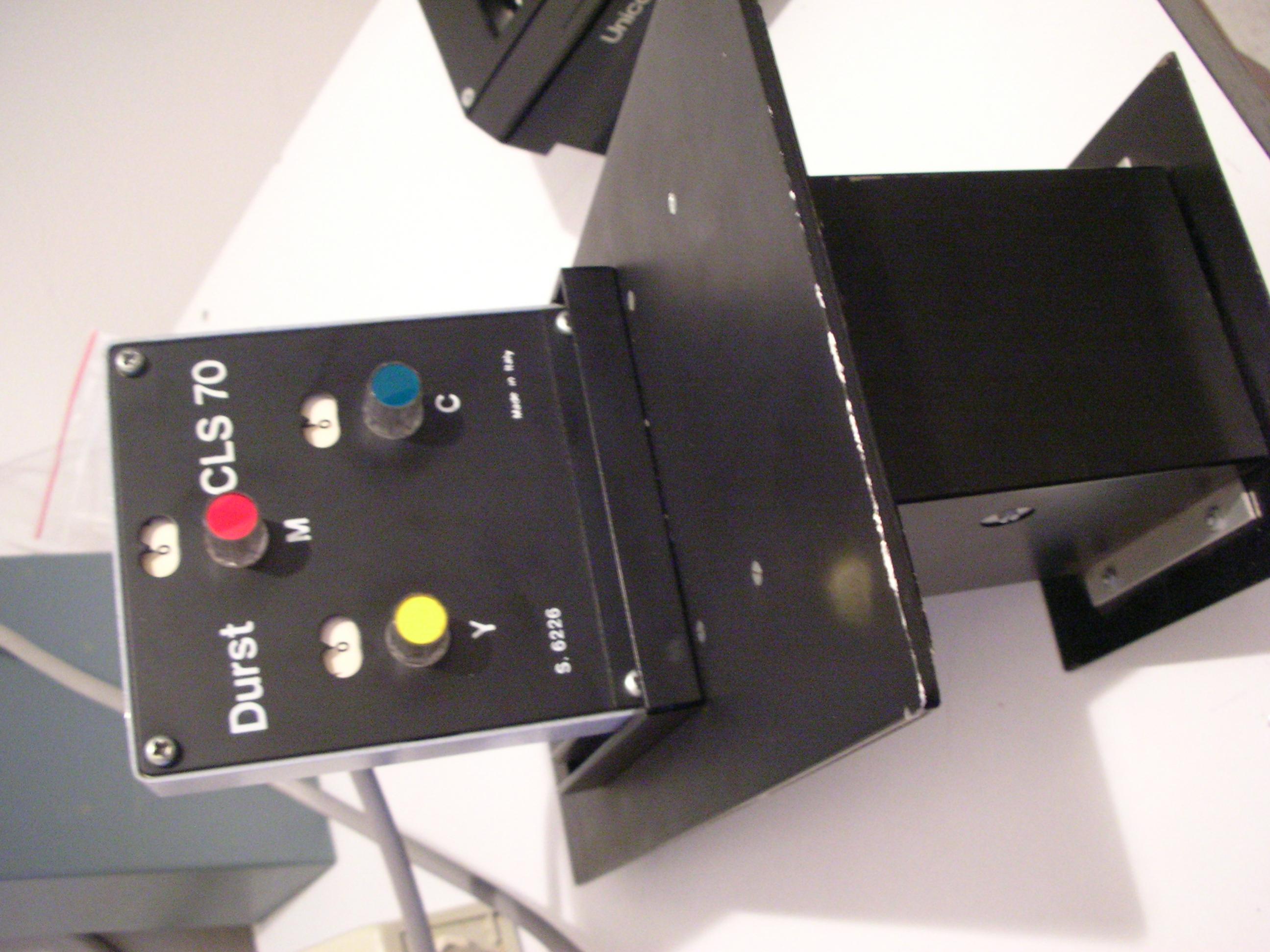

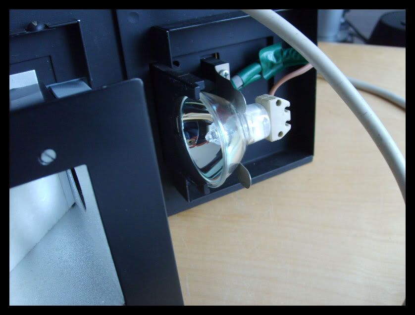

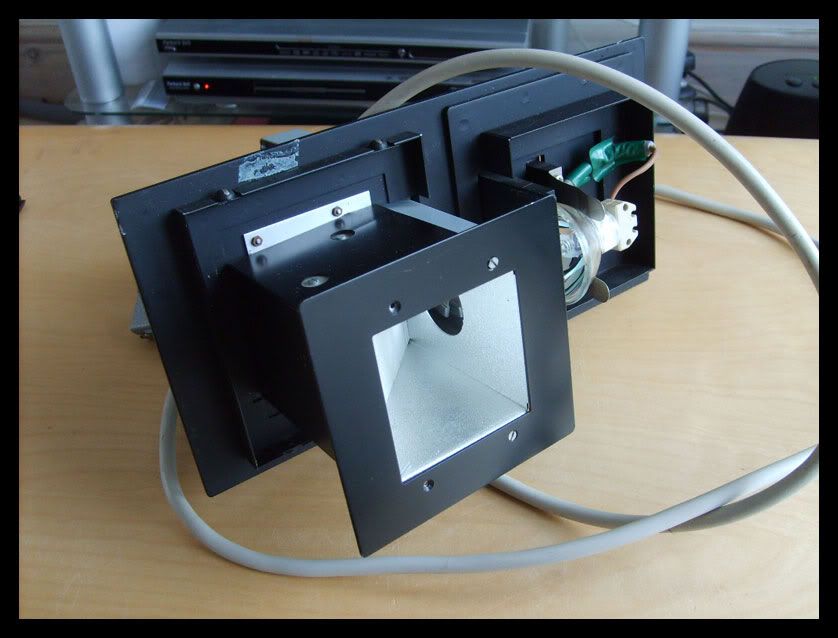

These are the things I have, the CLS 70 and the Unibox 80. I really don´t know how to use these things and how they work together. Or for that mather if they do at all as you pointed out.
I managed to figure out that the weird color-cast that present in one or perhaps two corners must come from the colorhead and it´s filters. Because when I took off the filter-mixer-thing from the CLS70 the color-cast dissapeared,
So I would need a "Setibox for the type of negative I use, correct?
What does the Uniboxes do in that case?

You can't use your CLS head with a condenser. You need to get a Setobox. You can use a bigger format Setobox for smaller format negative but you'll lose some brightness. Setobox 66 would work fine for 35 mm. As an alternative you could also get what's missing from condenser setup -- in your case lamp socket, 45° mirror and lamp housing cover, but getting a Setobox is probably much easier.

Your Unicon 85 is a condensor, a lens system used to direct the light. Setobox is a mixing box, basically just a empty box with some grounded glass and silvery walls to diffuse the light. I don't think you can use your Unicon with your CLS 70 regardless of the negative format. You have to have the right combination.
There were three Unicons available, 50, 85 and 105, respectively for 35 mm, 6x6(7) and 6x9. Setoboxes were made for 6x6 and 6x9, I don't know if there was one for 35 mm. If you only can get one, and you do not plan to do 6x9, get Setobox 66. It will be fine from 35 mm to 6x6(7). I've seen them on eBay from time to time.

Also, just to explain the way the head works; the filters come in from the side of the light beam and the mixing box is needed to spread the light out evenly. As you found out, without the mixing box (Sesibox), the filtration only affects one side of the image.

And that makes much sense, regarding the mixingboxes and the filters, I really thought that my CLS70 was faulty when I looked at the three filters, sitting all "wrong". I´m getting more relieved now when I know the machine more and why it wasn´t working at first.
