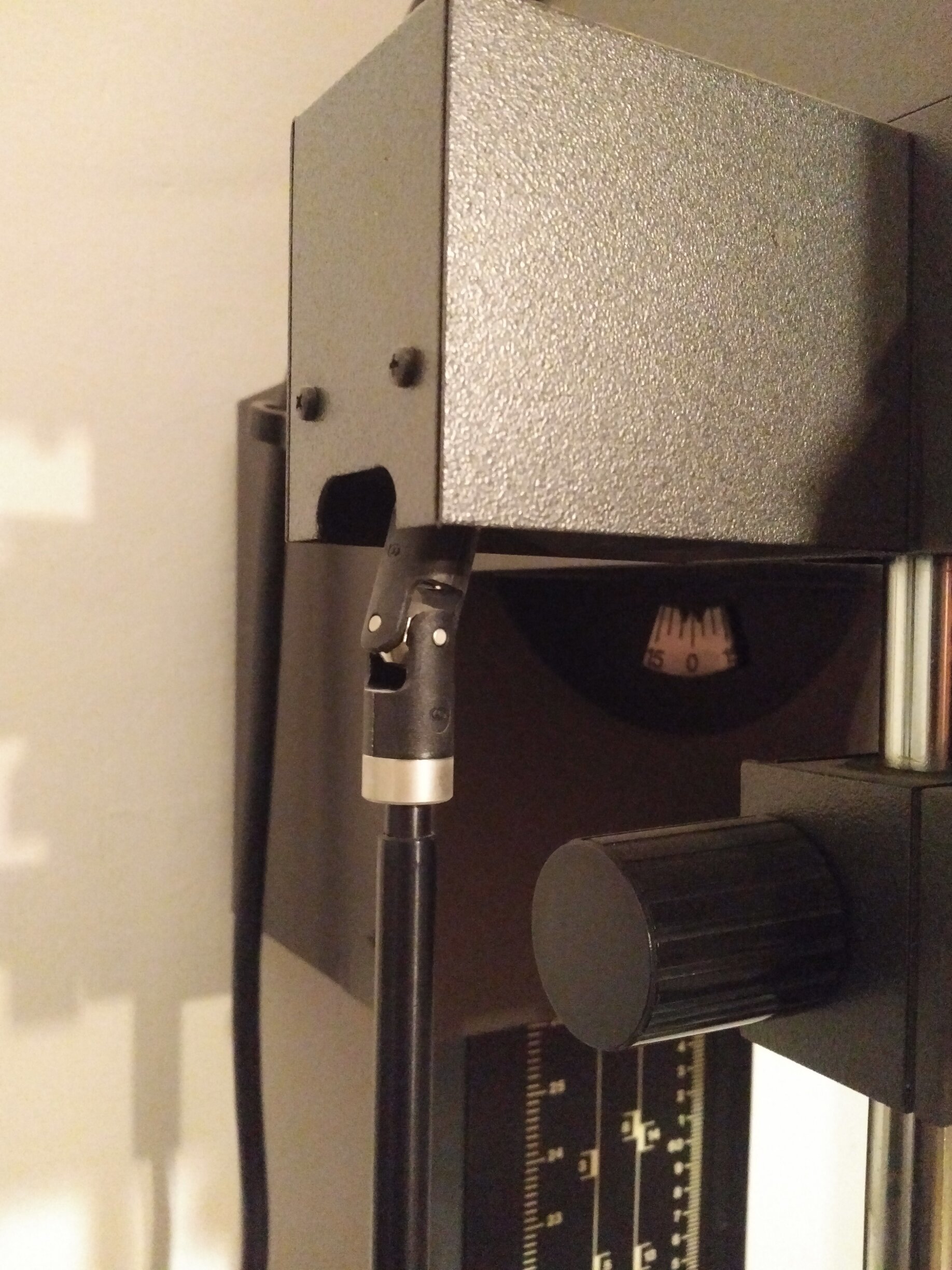

Well, it's interesting to know that these parts are available as spares.
When my join broke I thought these parts were specifically made by or for Durst and I couldn't even figure that they could be found on the mighty RS catalogue, so I replaced it with a miniature cardan shaft bought in a shop that specialises on model internal combustion cars. It fits perfectly with no need to modify anything, and personally I like this part much more than the original with its cheap yeallowished gummy part. I also believe that, unlike the gummy join that broke at a point in time, this cardan shaft being engineered to revolve millions of times will outlast me by many many decades...

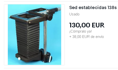

Fortunately the 138 has many spares at ebay, I would consider to purchase an assembly so you would have original spares for all the section, including bellows.
