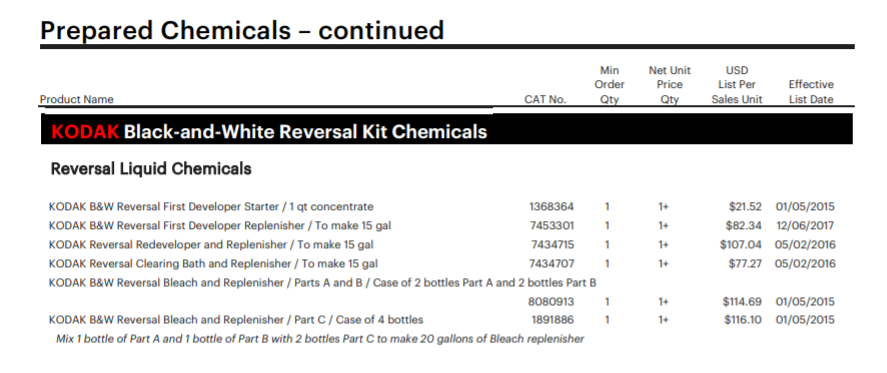

Alan: My apologies; I stand corrected. I too have had no luck actually purchasing DTOD in the US after broadly stating that it is available through a number of retailers via simple Google search. The two I attempted to order DTOD from (AK Scientific and Sigma Aldrich, aka Millipore Sigma) required licensing as a business with a commercial address or an institutional affiliation. Photographers Formulary provided an odd reaction, stating that not only did they not stock it, but that "none of the items you have listed" (D-94, D-94A formulas) were available from them, which was an odd response, as clearly most of them are. Will call them shortly to follow up. I seem to have touched a nerve somehow.
Final question that I have regarding all this: Are B&W reversal kits available from Kodak for TriX 7266 to those of us who do not have Super 8 and 16mm processing machines, but simply process our own using either LOMO, JOBO or Morse tanks?
Kodak only lists bulk kits:
https://www.kodak.com/en/motion/page/black-and-white-reversal-kit-chemicals
the same for their catalog:

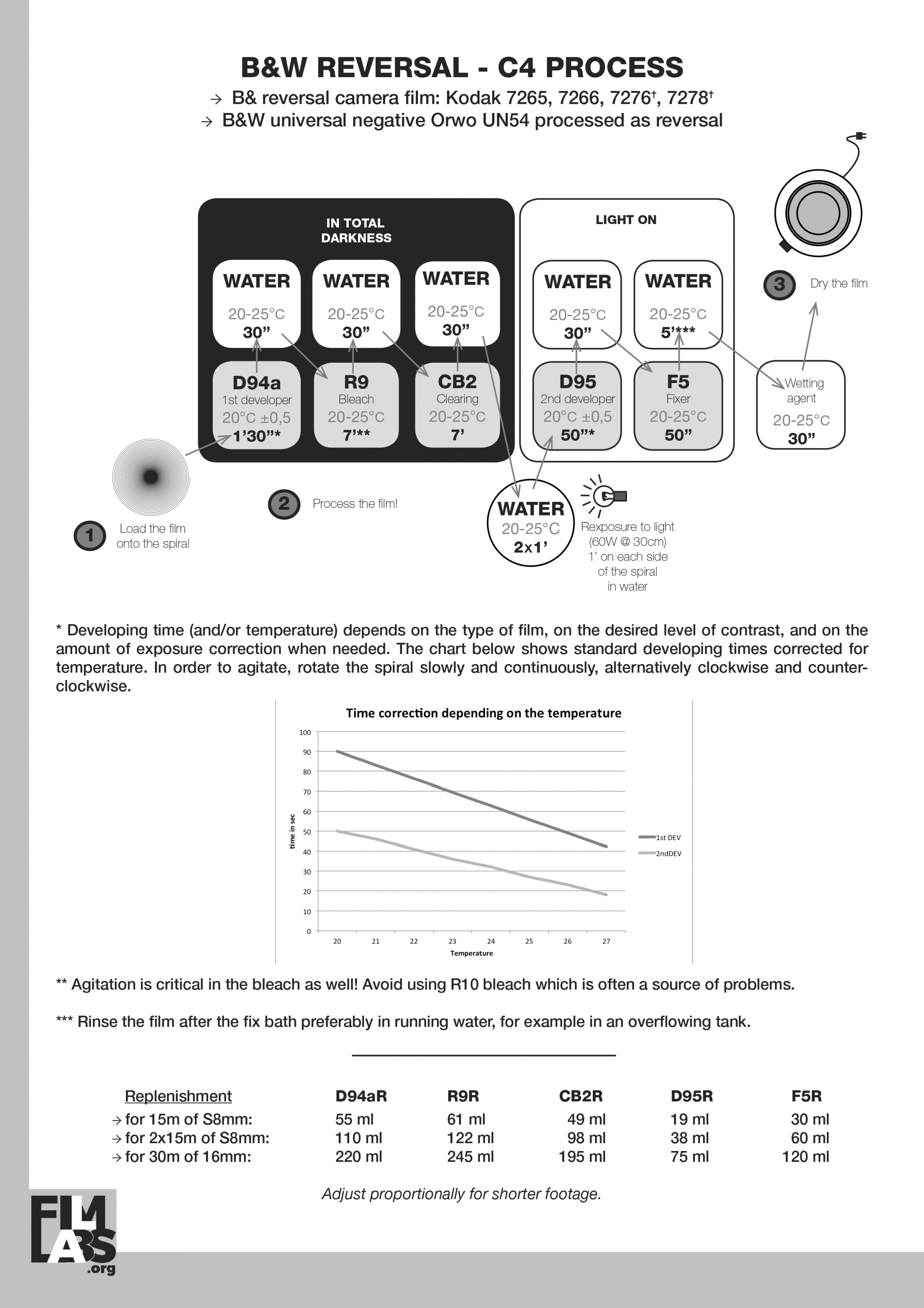

My question is the bleach mixture after first developers D-94 (R-9 Bleach) and D-94A (R-10 Bleach) in the reversal process.
The Kodak H-24 module 15 (Processing KODAK Motion Picture Films, Module 15, Processing Black-and-White Films) states "KODAK Bleach R-10 should not be used with KODAK Developer D-94." R-9 seems to be recommended for use with D-94.
However, FilmLab.org cautions against even using R-10 bleach even with D-94A: "Avoid using R10 bleach [with D-94A] which is often a source of problems." They then recommend using only R-9 bleach (see attachment/insert).
Has anyone else encountered problems using D-94A that they can directly attribute to R-10?
Here is my bottom line for asking these questions: I am currently only concerned with processing Trix 7266. I cannot afford to waste this expensive film by undue experimentation; I am trying to gain the benefit of others experience - perhaps even hard lessons learned - prior to embarking on this. I am trying to begin my movie film processing with a winning combo (looks like D-94 or D-94A, use R-9 bleach only) at this point, and not experiment right off the bat with expensive errors.
Hopefully this can help others as well.
I deeply appreciate feedback from those who have experience with these bleaches.

@Pakman777 I'm not entirely sure if going from a thiocyanate containing developer to a permanganate bleach without a very good wash is safe. Perhaps this was reason for the switch.

Thanks for your response.
When I see "developer starter" and "replenishment" I assumed these are more designed for automated processes, not the home processor like me using a manual system.
Yes, but as an amateur one can run a replenoshed process too. Or one just can add starter at each run and discard the baths after this. The issue with the Kodak offer is just the sheer size.
For amateur volumes reversal kits, yout got in Europe quite some choices: Adox, Bellini, Foma, Wehner.
