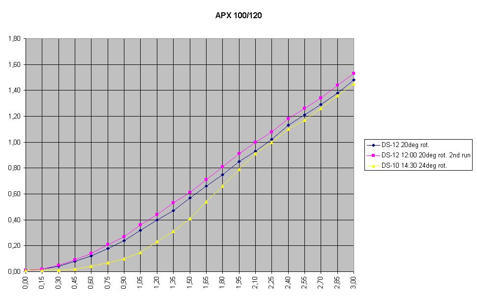

Martin, do I understand this one correctly: http://www.jangowski.de/sensitometry/APX100.jpg
At 24°C you get less speed/lowered shaddow density as compared to 20°C. This would be very interesting as I started to optimize everything for the higher temperature which is far easier to maintain in the warmer half of the year.
The third curve with 24deg. was made with DS-10, a developer obviously not very suited to APX100. I use DS-10 1+1 at 24deg. to keep the times reasonable.

Martin,
herzlichen Dank! This will save me a lot testing as I intended to try APX with DS-10 as well.
