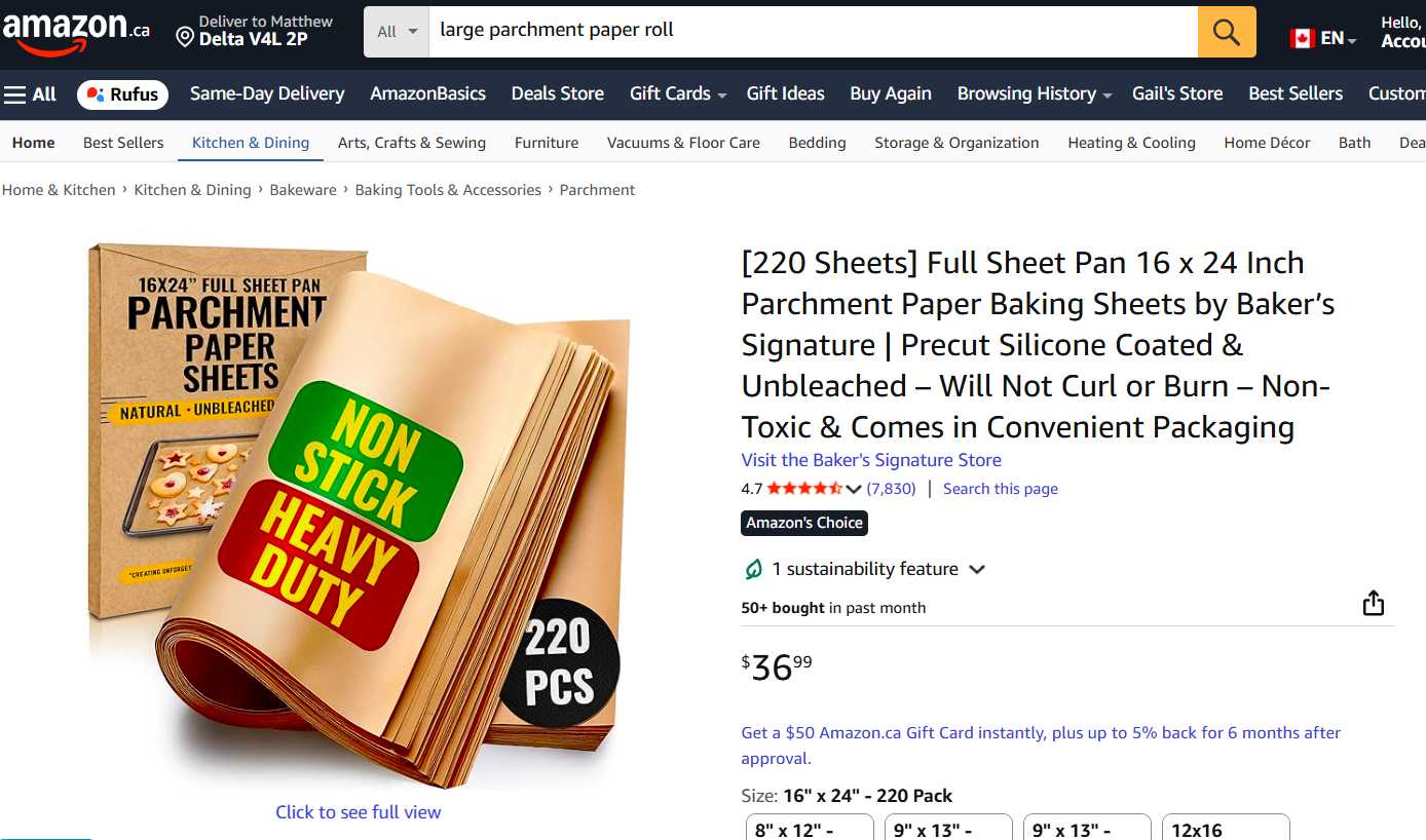

MattKing
Apr 24, 2005
55,513
Delta, BC Canada
The Costco Kirkland Signature stuff is 15" x 164 feet - so close for 16x20.
This is slightly wider:
