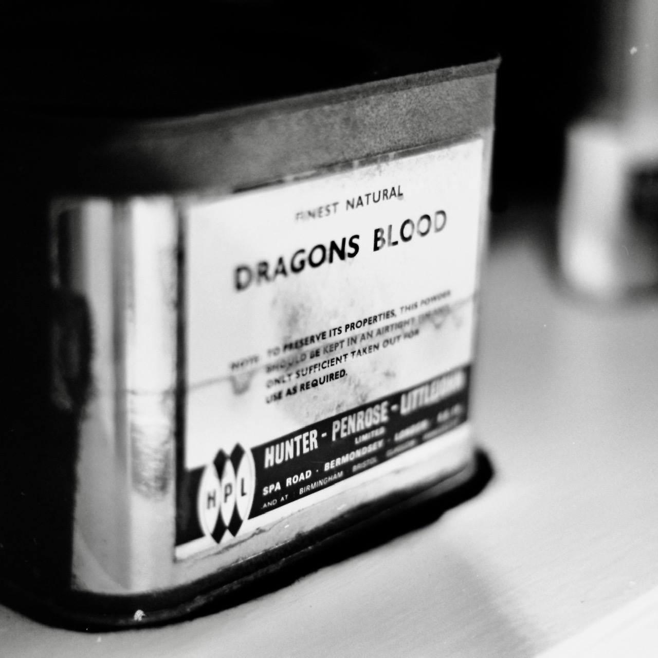

I work in a historic house as the maintenance man and we have a tin of Finest Natural Dragons Blood on the shelf in the darkroom amid other recognisable darkroom chemicals.
Just wondered if anyone knew what that might have been used for?
At an exhibition hall called Fotografiska in Stockholm I happened to see it mentioned as used to colour hieroglyphics. No further explanation though.
Will it make me a better photographer if I ingest it.

I assume that fluid was used as red retouching laquer for negatives.

Never heard of it before! Maybe it could have been used as a resist, since it's a resin...

It most likely is not about the resin as resin but as dye.
It even may be just a designation not even related by content to that historic resin.

I wrote an article a few months ago for UK magazine Amateur Photographer on Process Supplies, which is a wonderful London shop specialising in photographic materials. All my material for working as a photographic printer comes from there and have been a very happy customer for over 30 years. It was part of a series on UK companies, studios, institutions with heritage and mentioned Dragons Blood appearing in their price list from 1928. I checked with a friend who prints gravures for the correct description!
'While the shop is in the same location, and even the telephone number ends the same, this price list from the late 1920s shows a very different range of products used by the printing industry to create plates for the reproduction of photographs in printed ink. Among the listings for Collodion, Hypo Crystals, Photo Transfer Inks, Silver Nitrate and Caustic Soda is the curiously named Dragon’s Blood. Instead of being an ingredient for Alchemy (Clerkenwell has such legends), it is in fact a bright red plant resin used in photo engraving as a resist to protect unused parts of the printing plate when etched in acid.'
Though that resin still today is offered just as a dye for varnishes based on other resins. So that bottle actually may contain that Dragon Blood resin as a dye.

It's a red pigment used along with Tmeric as a colourant when lacquering brass, it's added to a shellac solution and gives the rich deep gold colour typical of old clocks, brass lenses etc. There's a member of this Forum who's first job after leaving school was hot lacquering clocks and he used Dragons blood.
Hunter-Penrose were suppliers of printing and process equipment, their large copy cameras appear for sale occasionally, also process lenses.. Dragons bloods other photographic use was in opaque retouching medium with ortho materials, typically used with lith films.

If you go onto google maps and search for Spa Road, Bermondsey, London SE16. (mentioned where the contents of the tin were made or packaged) you will see what it looks like today. (click anywhere on Spa Road and then on the image that appears and by turning the image you can move up and down the road.)
The area was heavily bombed during the war and the area is now in the main, plain simple featureless tower blocks, housing typical of the rebuilding. The only commercial premises is a small parade of shops, no photographic outlets visible anywhere.
