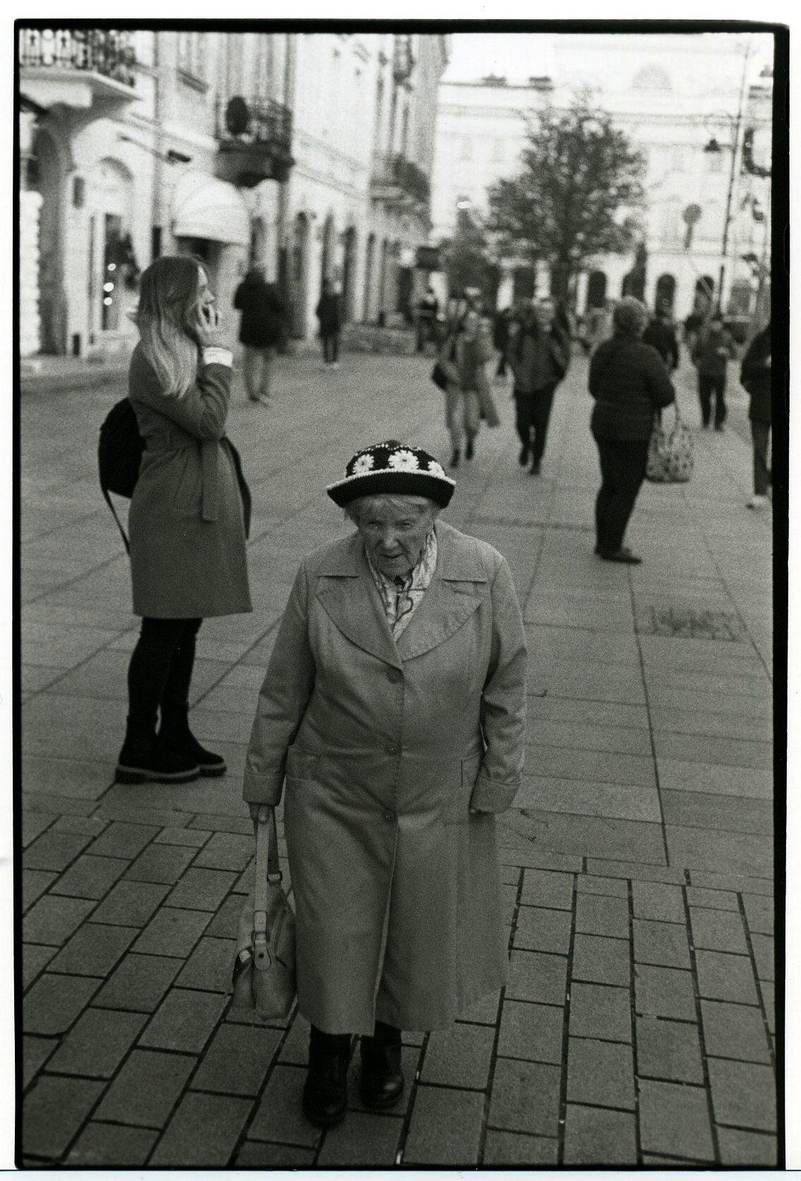

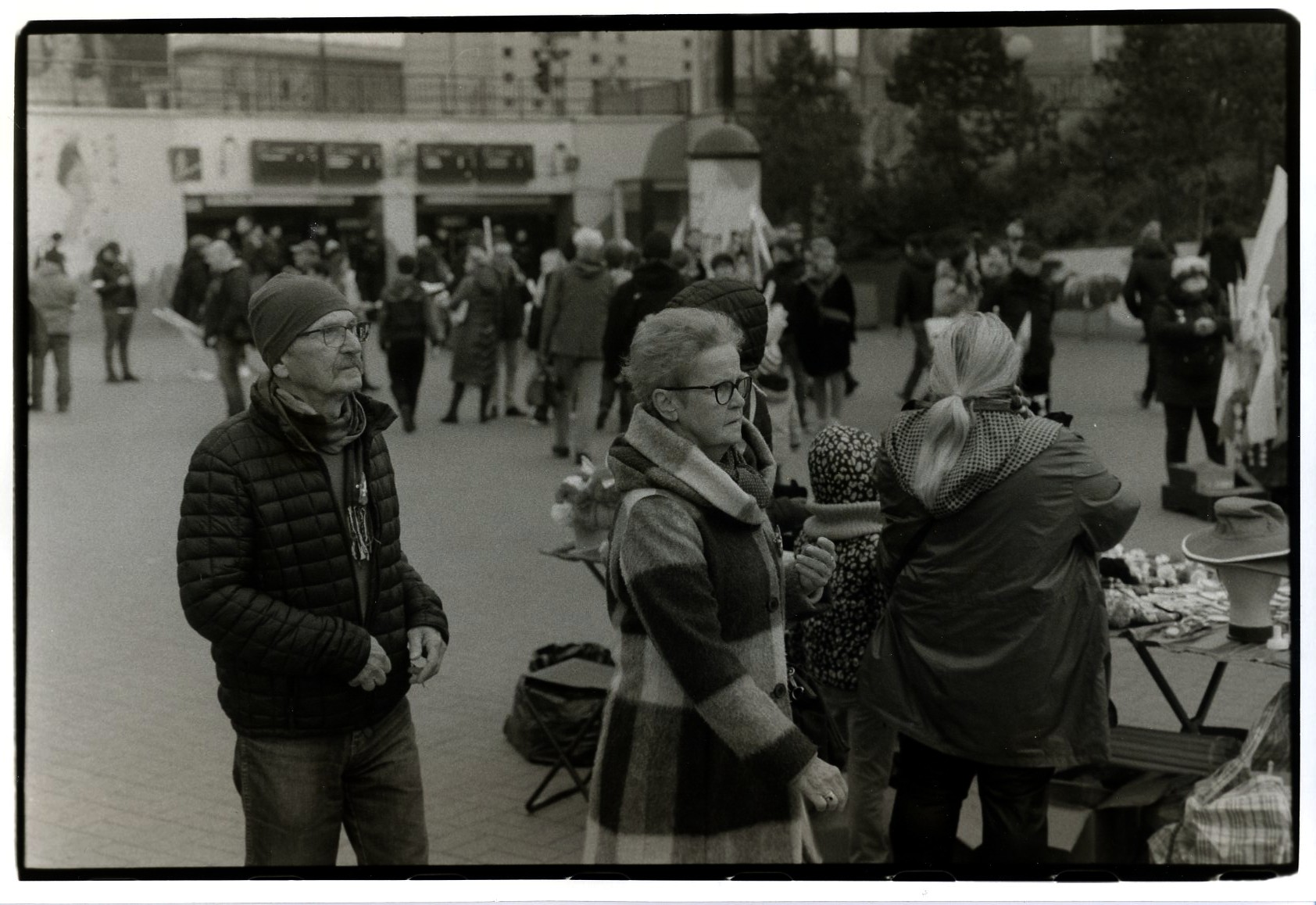

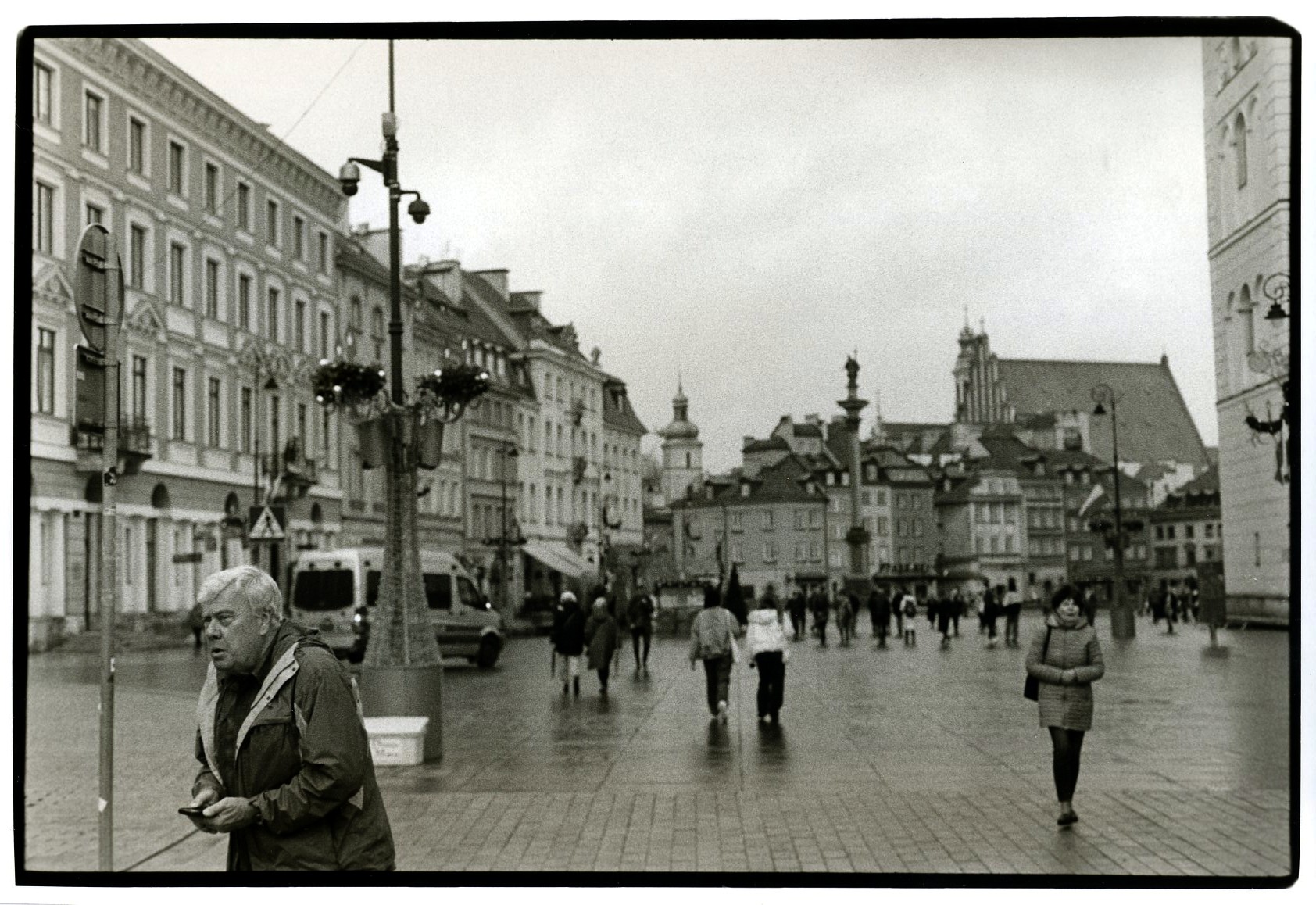

I got myself DR Summicron (again - sold one that was little foggy, this one that I got now is CLA'd from Leica specialist).
Beautiful lens, and all is as it should be.
Picture examples: Cloudy day in Warsaw, with iso 400 film (low contrast scene, APX 400 in Rodinal), all shoot @f4 1/250s.
I have old Summitar, and I would say that even Summitar gives higher contrast?
Which lenses that you know gives low contrast? I know that older lenses in general are lower in contrast.
Thanks!

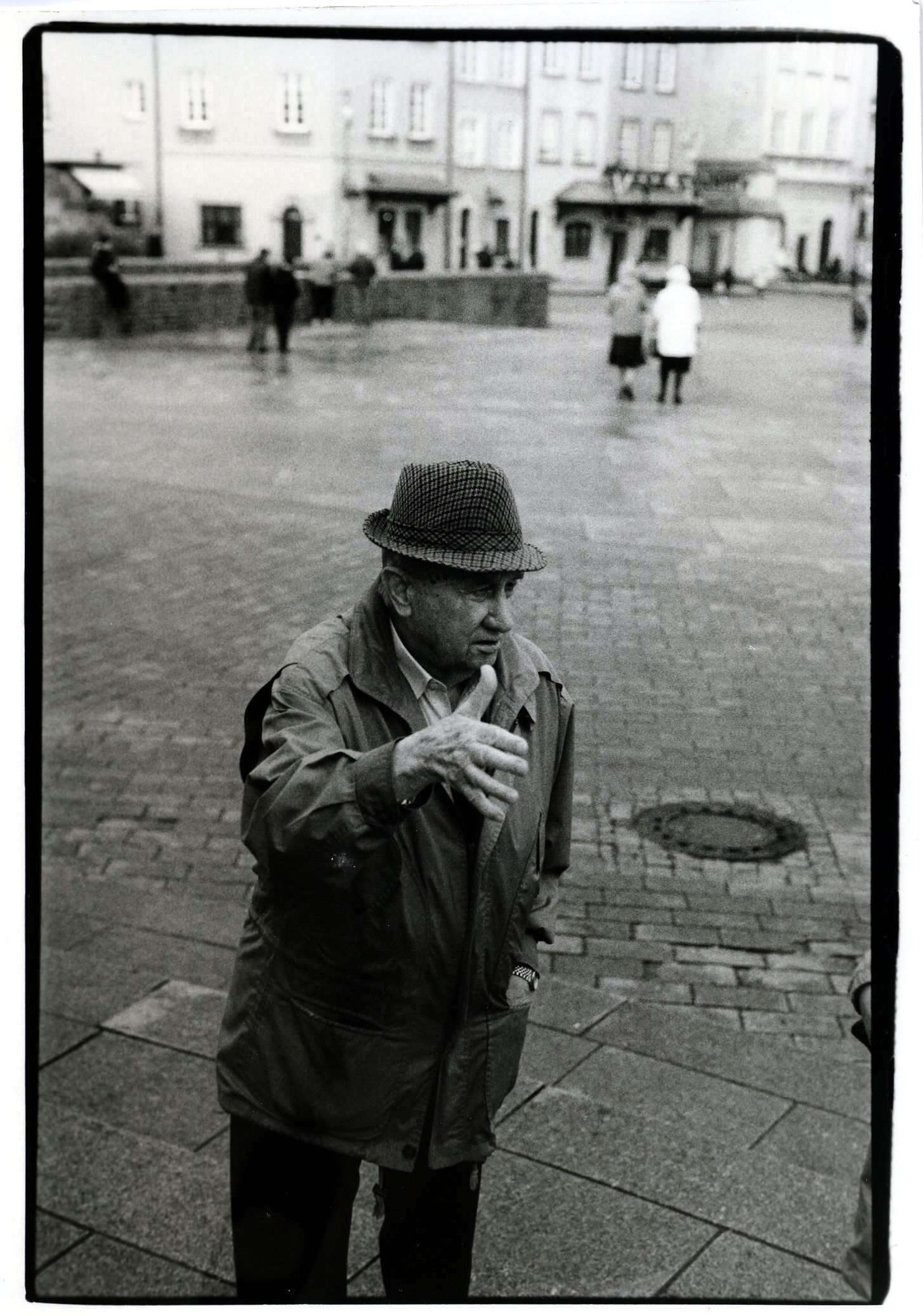

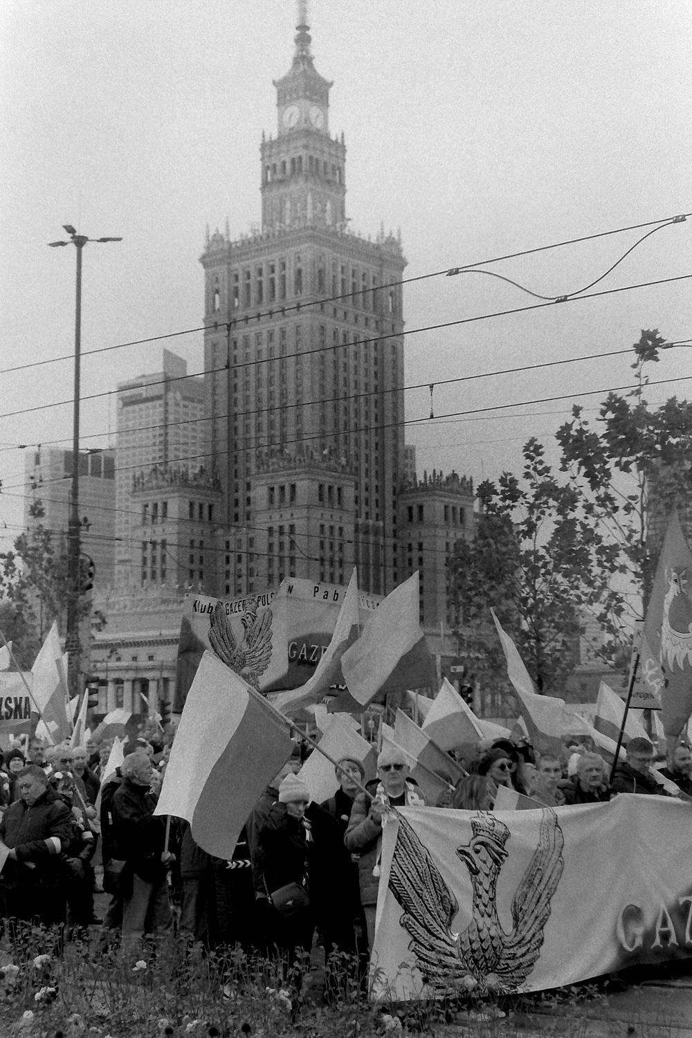

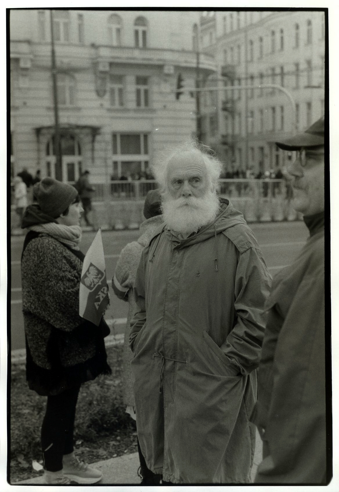

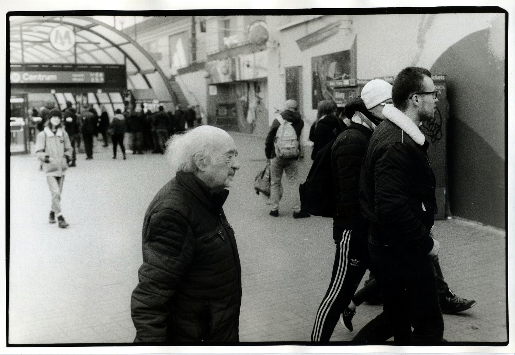

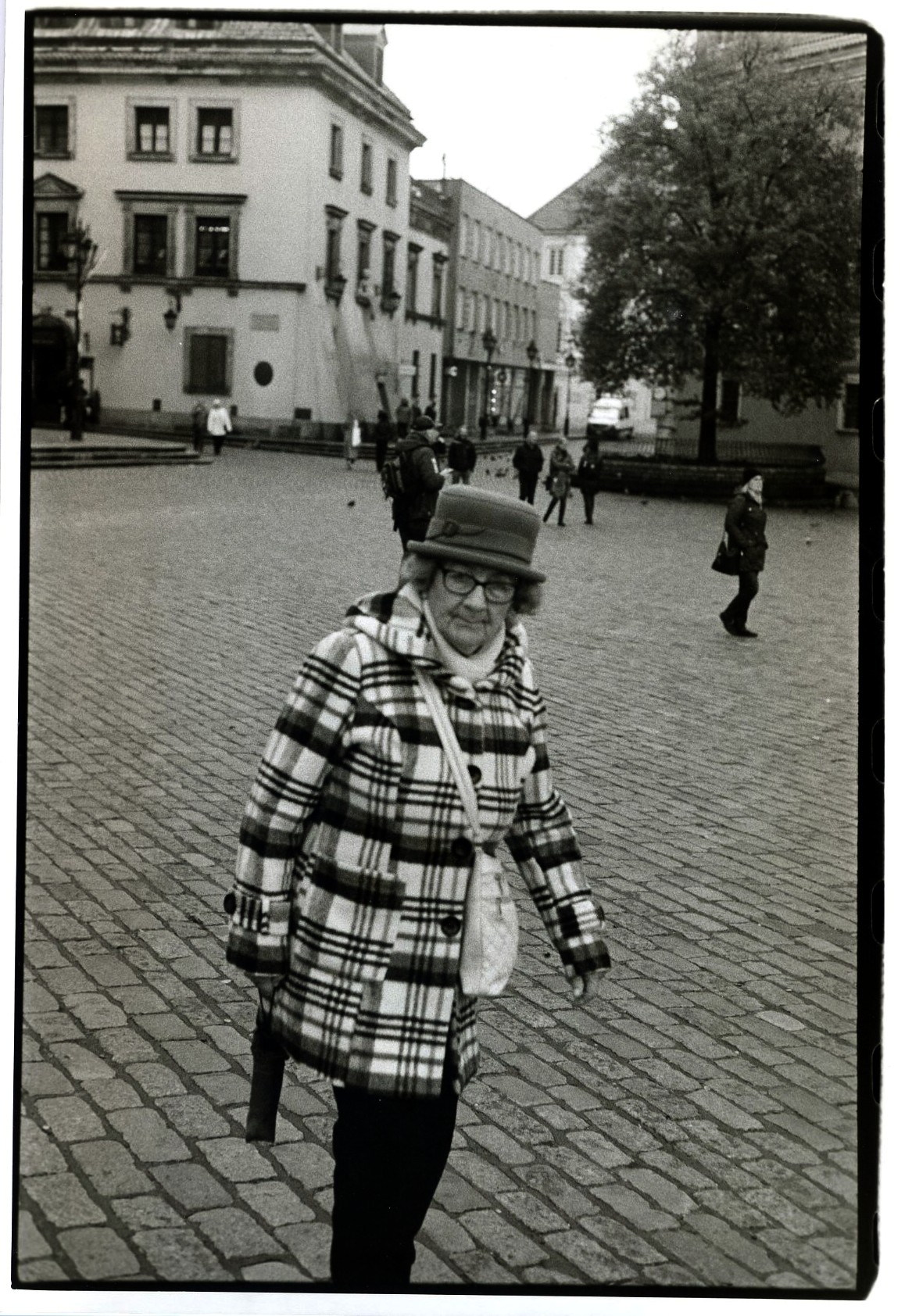

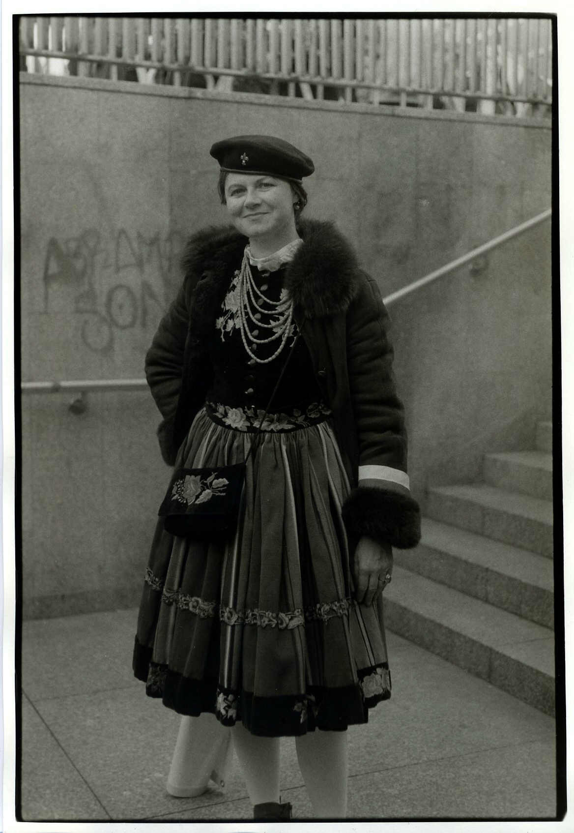

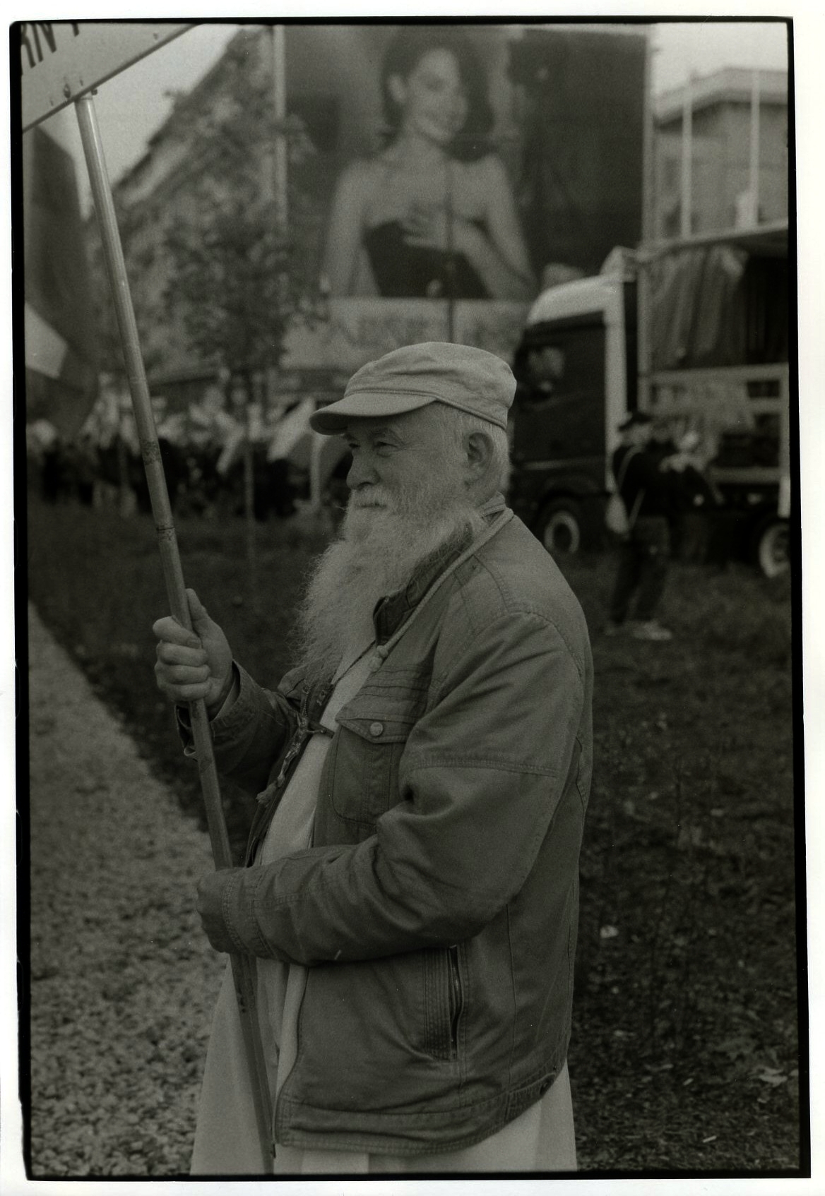

OK, I just made some prints, and all is OK :smile:. With grade 3 or 3 1/2 - it prints nicely. Here and there I have missed the focus, but here are the paper scans:
nice! A couple of those look underexposed and that will make any lens seem low contrast. But the majority look good.
AZD
Jun 11, 2021
211
SLC, UT
Shooter
Yes, looking much better. I think it is very difficult to judge concepts such as contrast (and sharpness, shadows, blown highlights, etc) until you get to the final output, such as your prints. I rather like the last one of the gentleman with the flag, and maybe see a bit of the DR’s signature look. Well done.
