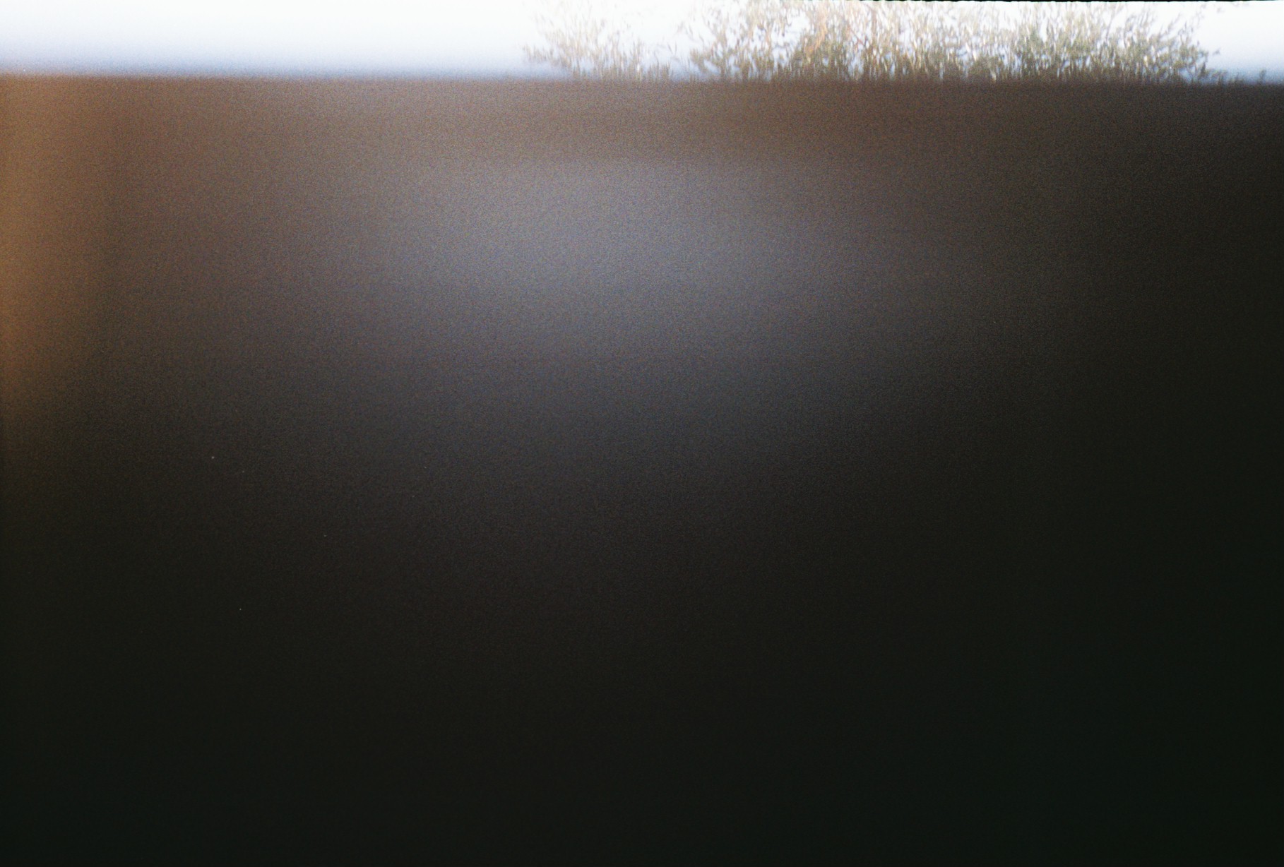

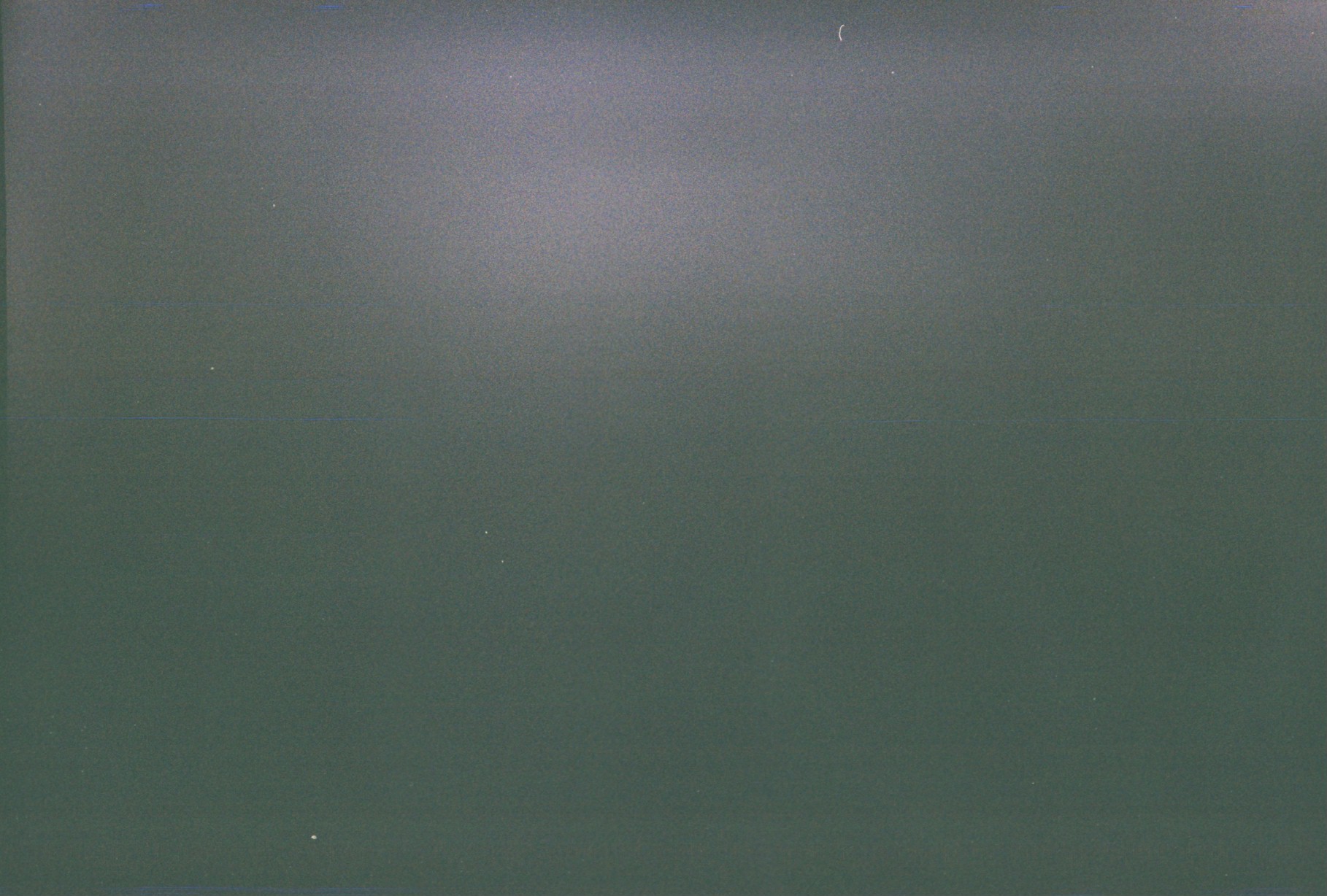

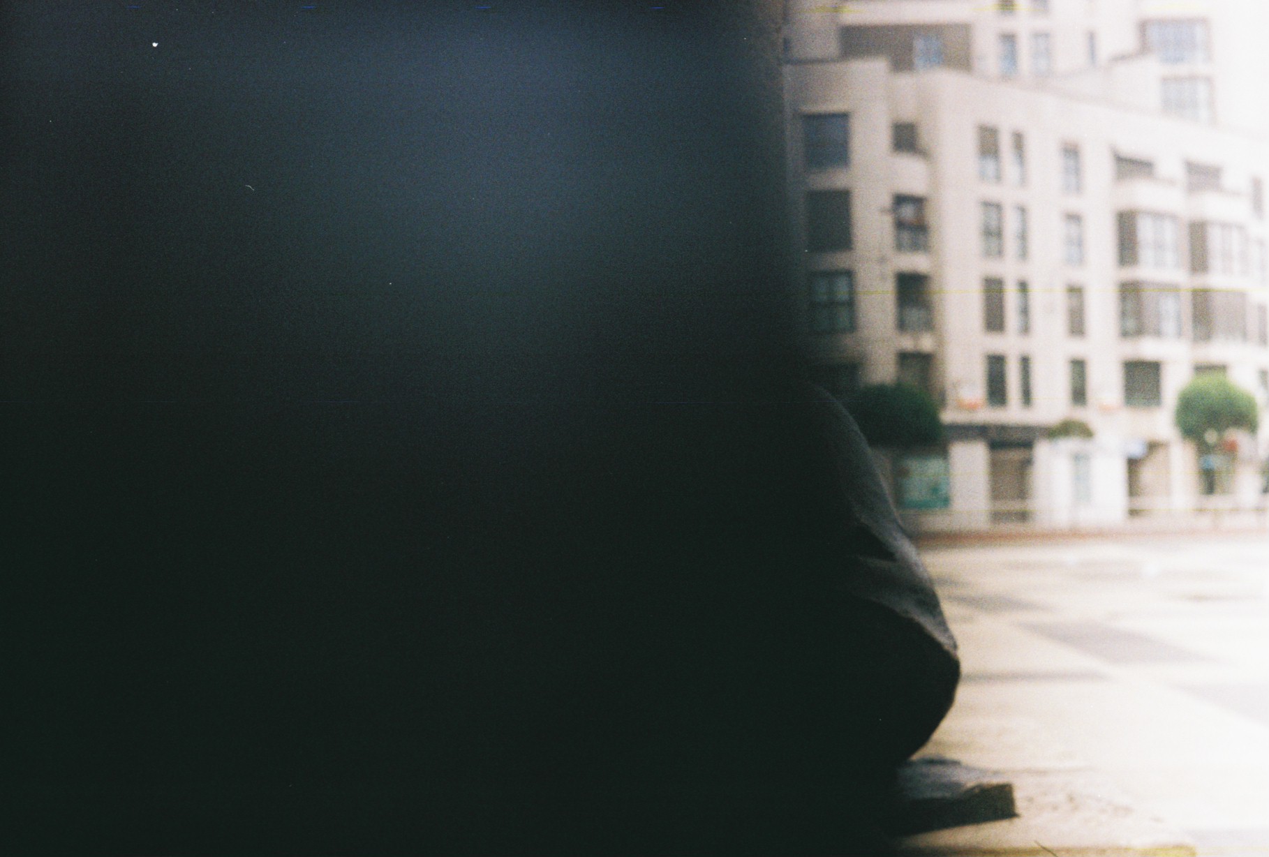

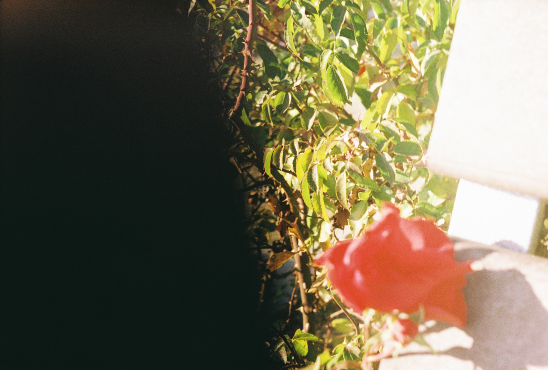

I am new here, but would really appreciate your help. Recently I acquired an Edixa Reflex in what I consider good shape and normal functioning. I tried a roll of film and received very unpleasant results (images attached).
I checked the speeds and they seem to work just fine, so based on this and the results, I start to think that the problem might be the curtains. However, I would like to read your opinions on this matter and I think I could really benefit from your expertise.
Thank you very much in advance

I don't know this camera, but it looks like a defective shutter to me, one or both shutter curtains only move partially.
Can you watch the shutter move with the back open?

Your first photo probably exhibits "capping" in which the moving slot closes on its way across the film plane. This is a common problem at the highest one or two shutter speeds. Do you see this problem with speeds of 125 or slower?
The suggestion by @Andreas Thaler is good: Remove the lens, and shoot toward a constant light, such as sun or incandescent (not florescent or LED). You should see a uniform blink of light covering the entire film aperture. If it becomes black partway across, that would be capping.
You don't have a very good shutter tester if that camera's shutter checked as 'just fine.'
The camera needs to be disassembled and cleaned. After that the shutter curtains need to be tensioned. In the Edixa, the shutter rollers and spools are accessed from the rear. The tensioners are on the bottom; counter-clockwise to increase tension.
