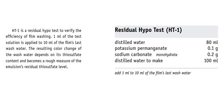

Yes. The most reliable test is the methylenen-blue test, but it is hardly realistic outside a professional lab. I can, however, recommend the HT1 test. This test has fallen out of favor with many users, but appropriately applied, it gives rather useful results for film washing.

Thanks Ralph :smile:
Making up the solution looks reaonably straight forward (famous last words)
One final question - the last wash water - is it worth leaving the film to stand in the last wash water for say 5 mins, so any residual chemicals can diffuse into the water ?
I wash in running water - so cannot see there being any detectable concentration

Yes, that's exactly how it was meant.

P. K Turner Has Suggested ....
After first rinsing wash the film with water made
pink with potassium permanganate. If the solution
remains pink washing is complete. The test can be
used to check already washed film. Or prints?
Potassium permanganate is a HazMat chemical;
at least from P. Formulary. Dan
